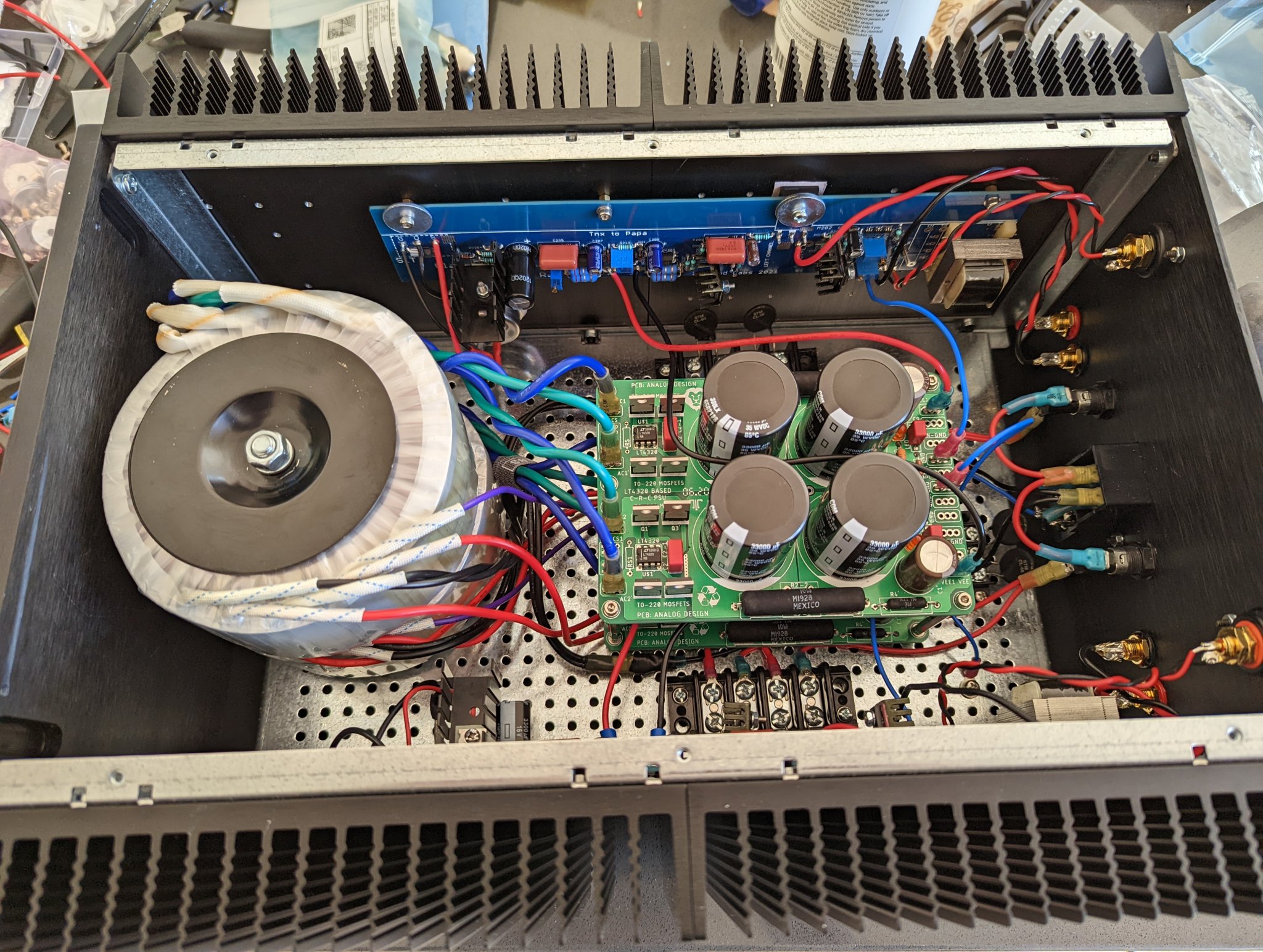

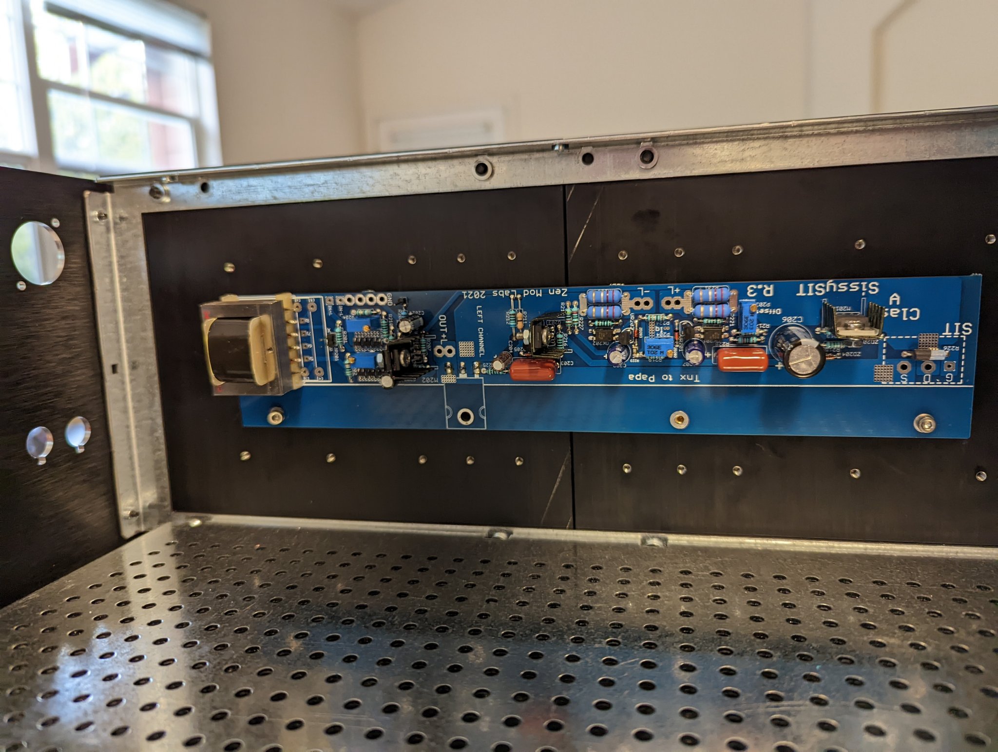

Looking at how things might be laid out (at a single channel... donuts and PSU will be stacked).
I'm thinking of tapping holes for SIT in this general vicinity -- probably slightly more towards the center of the heatsink/chassis (a bit further away from donuts).
move Donut to left (corner) or stack it vertically (L Profile, wood construction elements) near front plate
SIT - good as is, or move it more centrally on its heatsink, if you dare to tap
arrange that holes are in between fins, so you can drill through-holes, tapping much less critical
feel free to leave just few mm between SIT and pcb, no danger there - as always - keeping it at 33% of heatsink height is proven recipe for best thermal arrangement
same applies to mosfet (33%) so I believe it's better to use other channel pcb in that position (so MOS is down, not up)
edit: in case that you're putting both channels in that case, it's certainly best to have Donut vertical
do anything you can to leave enough space for final fiddling with trimpots; fingers and small screwdriver ....... you must squeeze them in in the end

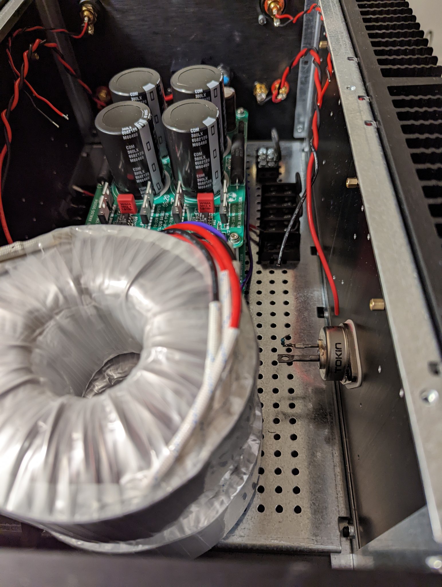

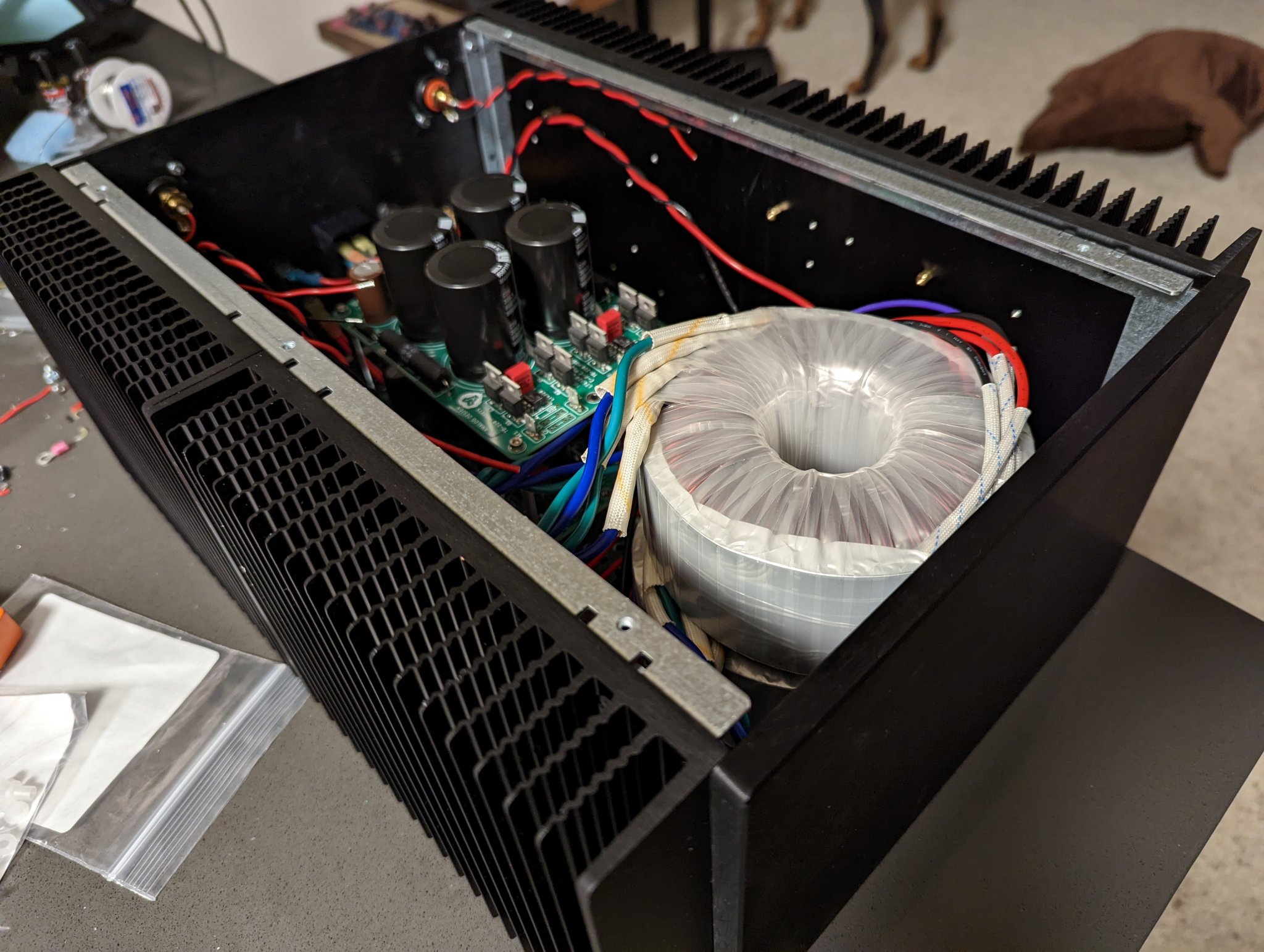

Are these 4 taps towards the center supposed to line up with the PCB? Just ever so sightly off (can see left screw angled). Maybe my heatsink isn't mounted 100% correctly
Edit: how critical is it that I lower the MOSFET from my previous picture? I've already tapped holes for one SIT in the previous configuration. Wondering if the MOSFET wouldn't be sufficiently cooled being 33% from top.
I think I'm just going to try for the original config I had posted.

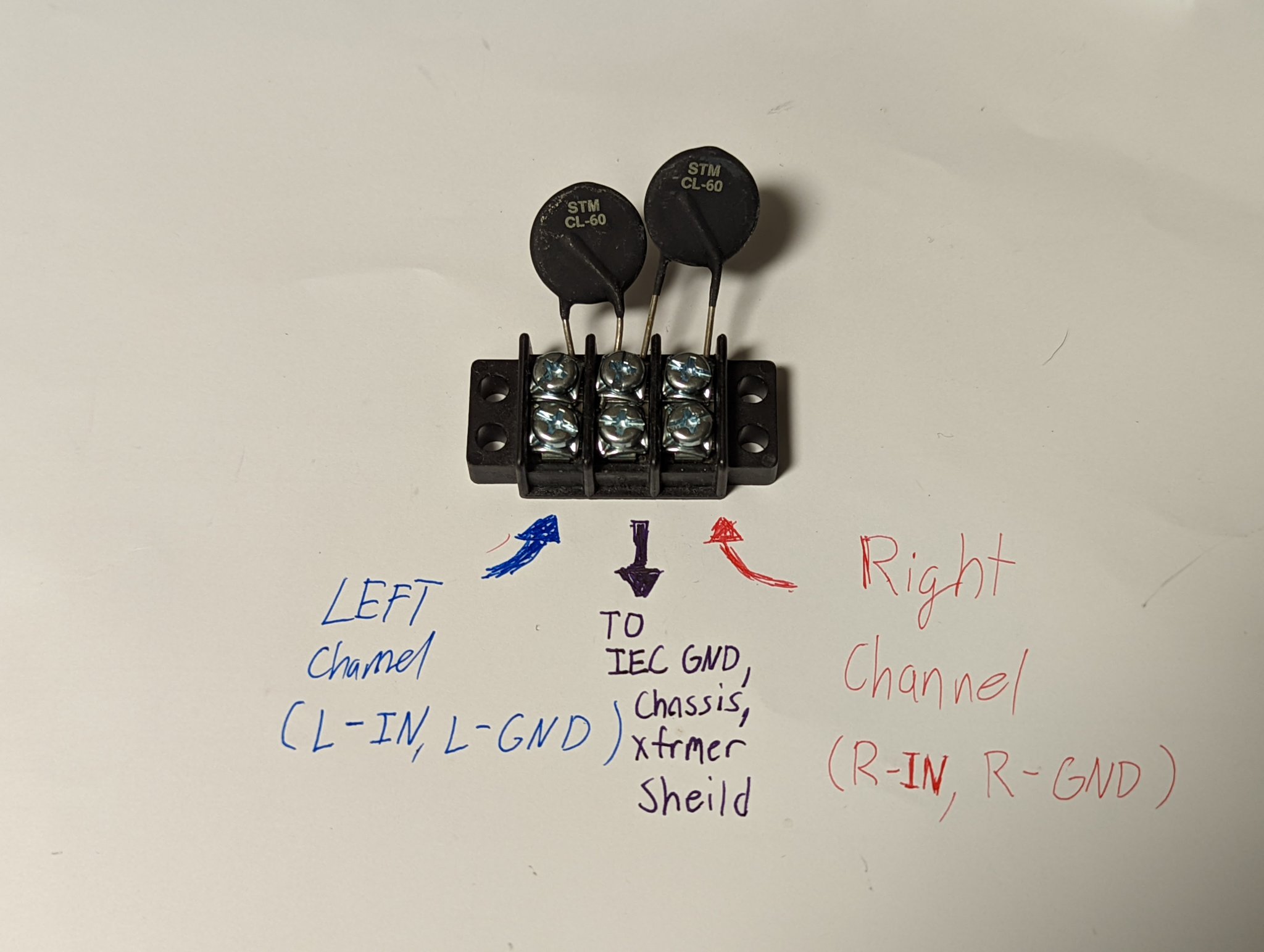

Since it's dual mono in same chassis, I am wondering if I'd be separating left and right grounds sufficiently by lifting with CL60 (found this in another Pass FW thread). Hoping to avoid ground loops.
Left terminal:
Right terminal:
Center terminal:
Would this work? Should I be separating PSU GND left/right, or would both go to center terminal instead?
Thanks again for any tips
yeah, 4 holes are aligned for UMS, so mount pcbs wherever you can
as shown, it's OK
if there is some misalignment, you need to loosen M4 heatsink screws and press them together, then tighten the screws
edit: or just widen the holes in pcb, don't be scared of that
4mm drill will do everything you need
don't touch hole where mosfet is, fix other 3
Left terminal:
- PSU PCB GND (left)
- Left channel GND
Right terminal:
- Left channel GND
Center terminal:
- IEC inlet GND
- both transformer shields
- chassis
wire from first channel PSU GND-one end of NTC-chassis
wire from second channel PSU GND-one end of NTC-chassis
simple as that
channel pcb is getting GND from its PSU pcb, RCA GND goes to channel input GND pad
simple as that
Made decent progress this weekend. I expected to have completed it by this weekend, but ended up fighting with the heatsinks and placement of everything. Definitely gave myself a challenge by going with the new Monoblock lol. Trying to minimize any chance of hum the best I can.
Hopefully it'll be up and running next weekend, just need to grab a different length M4 for the Tokin, and may decide to re-tap for one channel for better placement.

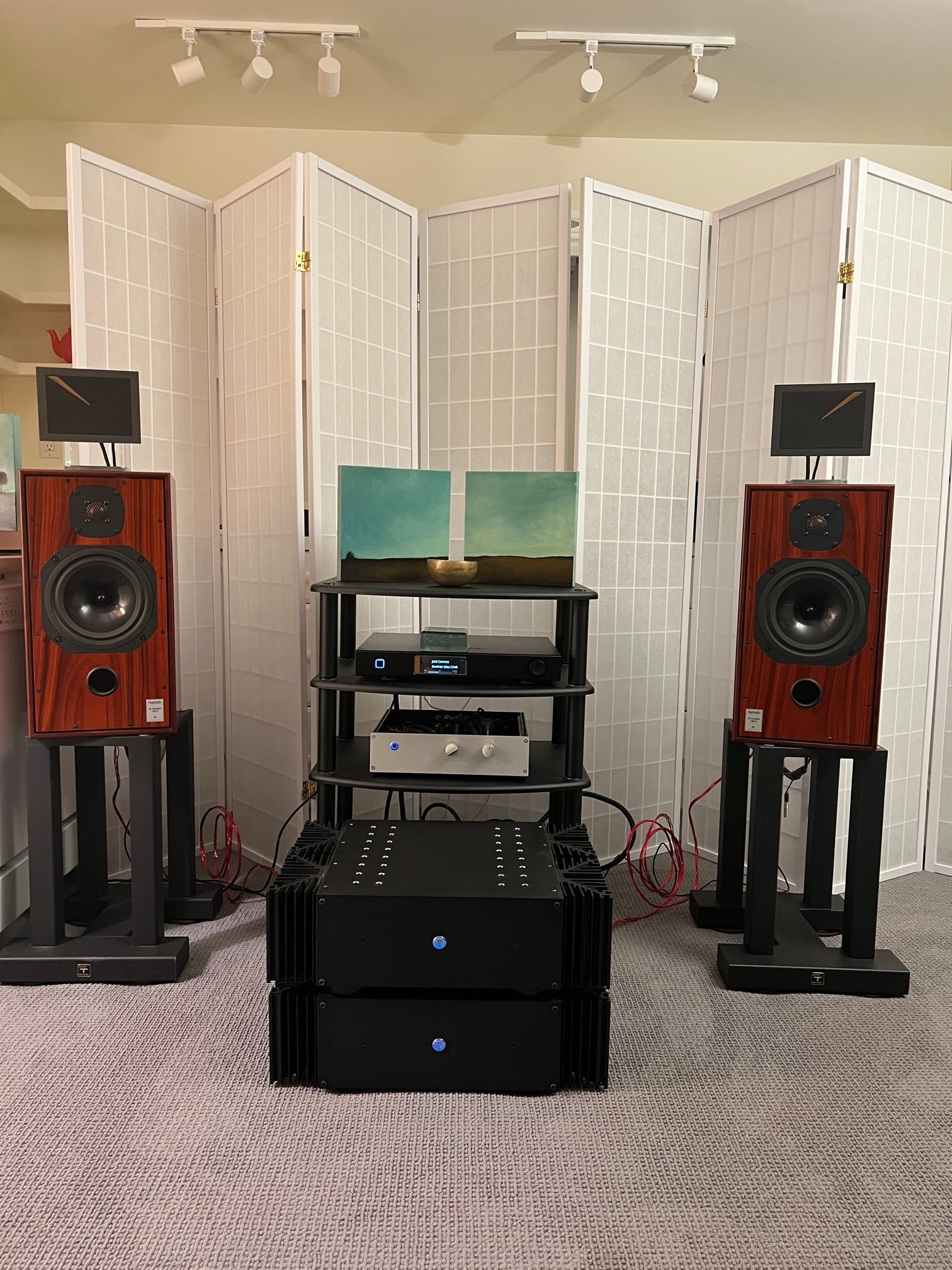

Have been “Chillin” as per ZM recommendation and placed the Sissie’s in my main system. Was able to get the offset in the teens when at thermal stability and called it good. I generally have mild concerns about 20 wattish amps with the Harbeth 7ES-3’s as they are 86dB sensitivity. Concern was not warranted. Rest of system is Salas preamp DCG3 and Aurender A10. Had been running an F5 (not dual mono, but with Toshiba mosfets). Would seem that the Sissys’ have teeny bit less gain than the F5. Most listening at 1 o’clock on the DCG3. Also had the great fortune to be chosen in the lottery to buy and build an N-channel Sony Vfet (#143). Had this in the system and loved the expanded sound stage and “musicality”But there was Somewhat less control of bass and bit of drift on imaging. I have found the perfect home for it an another system with less demanding speakers and with the aid of sub. In my other system magic it is really magic.
I’m aware of my potential to overvalue my own projects (endowment bias). In this case I’m fine with the bias. More often than not have had experience of “Hmm was that worth it?” Not so in this project.
I have thought for the longest time that I have a difficult room that was causing me difficulty. 22 ft x 11ft x 7.5 ft. Image and bass were never quite right despite moving my speakers numerous times and a variety of electronics.
Things that were immediately apparent was great improvement in imaging/spatial localization of instruments. This was quite impressive with even modest volumes. (65dB-70dB). The ability to enjoy music at lower volume levels make the listening experience so much less fatiguing. Part of the imaging may simply due to the dual mono setup but I suspect maybe not. Definitely felt that the Sissy were in control and knew exactly what they wanted.
From first power up they were dead quiet at the speaker.
The width of sound stage and stability of image was impressive. The thing that impressed me the most was the accurate timbre of instruments. I have historically found a lot of jazz (particularly horns trumpet) to be a potentially difficult listen. The Sissys’ passed this test with ease. Never felt a “cringe”.
They also allowed me to sit for hours listening to music. They could just as easily been called Sittys for the effect. (Well, and because of the SIT).
The bass extension and control demonstrated that my room was not the problem than I thought. The bass was tight, fast and convincing. I still do have the desire for a sub to take it from 50 Hz down. and have on the bench Nelsons 6-24 crossover. Now to pick a sub to build or buy. The Ripole looked interesting but fear it will be a rabbit hole.
The Sissys’ most definitely add the “spooky” factor. Love when the hair on the back of my neck stands up and there is a tingle when listening to great female vocals, or exceptionally well recorded music.
So in my humble opinion the Sissys are gentlemanly, or gentlewomanly “beasts”. They are in control and I am glad they are. This has been a thoroughly enjoyable 48 hours.

well, yeah, Buddha is everywhere
now, you're officially spoiled
have no doubt (in fact, I know) that Harbeths are exquisite (if you like them yes - and I like them - being of same school as ReVox studio monitors, I spent many years with)
but- as you're spoiled now, to fulfill everything what A Class Fairy tale is bringing, you need to extend Harbeth quality to lower octaves
few 7-8" speaks are capable to do what decent 12" or 15" is able
so, either bigger speaks in general, or adding extra good subs

Well. First impressions are that this this stupid spooky. :0
Honestly, setting the pots went without a hiccup, tho trying to access them with my super tight monoblock build was challenging. Managed to hit 199.5mV & 20mV without a problem. Let amp sit for 15m or so before setting offset. The LT4320 PSU boards deliver +/-26VDC to R+/R-.
I can only hear a faint hum with my ear right next to the woofer (both channels). Honestly, I'm surprised that it's not more noticeable given my small chassis. I'm glad I went with shielded donuts, tho I'm wondering if I may be able to almost eliminate it completely by moving some wires around?
Also, I'm currently using a 3A fuse in line of each donut (as well as 2x 6AT at IEC). Was wondering if I need to bump that down to 2A5?
I'm very impressed with the bass out of this thing given it's 'only' 20-30W.

Nice build.
Three suggestions for hum:
1. Twist each power transformer primary winding wires (red with black) together.
2. Twist V+, V-, Gnd wires together from power supply board to audio boards.
3. Rotate power transformers 90 degrees approximately from current position for minimum noise.

Doh. Yeah honestly, I should've thought of that.everything what Ben sez
and, routing mains wires under base plate, well, that's logical
and shown in all of my builds
in rare cases of not having base plate ( custom/no Modu) I'm using screened leads to Donuts
I can try to re-route my mains under the base plate, as well as add a screen if re-running cables doesn't solve it.
Would the SIT source/drain be susceptible to EMI from donuts?
routing them under base plate is probably even better than screening
naah....
VA of Donut divided with mains voltage, then choosing first closest standard value of fuse, fast one
if you end with often popped fuse , increase to first next bigger standard value
all under condition that you have at least 10R NTC inrush limiter
