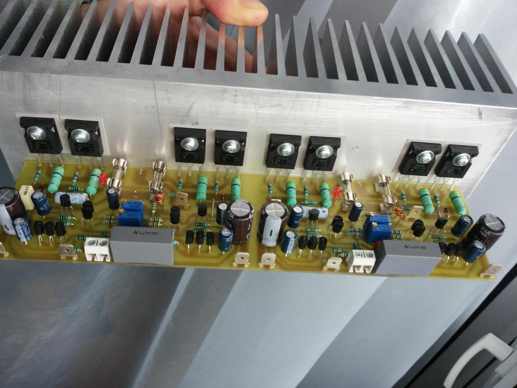

Got both modules adjusted and tested. I played some music yesterday and it seems to be very good amplifier. I cannot tell the full story yet as I prefer giving it 10 hours at least. I'm also going through a bronco-pneumonia and have a hard time on concentration... I had initially planned listening a few albums but ended up falling asleep after 2-3 songs... But what I heard so far seems to be very good.

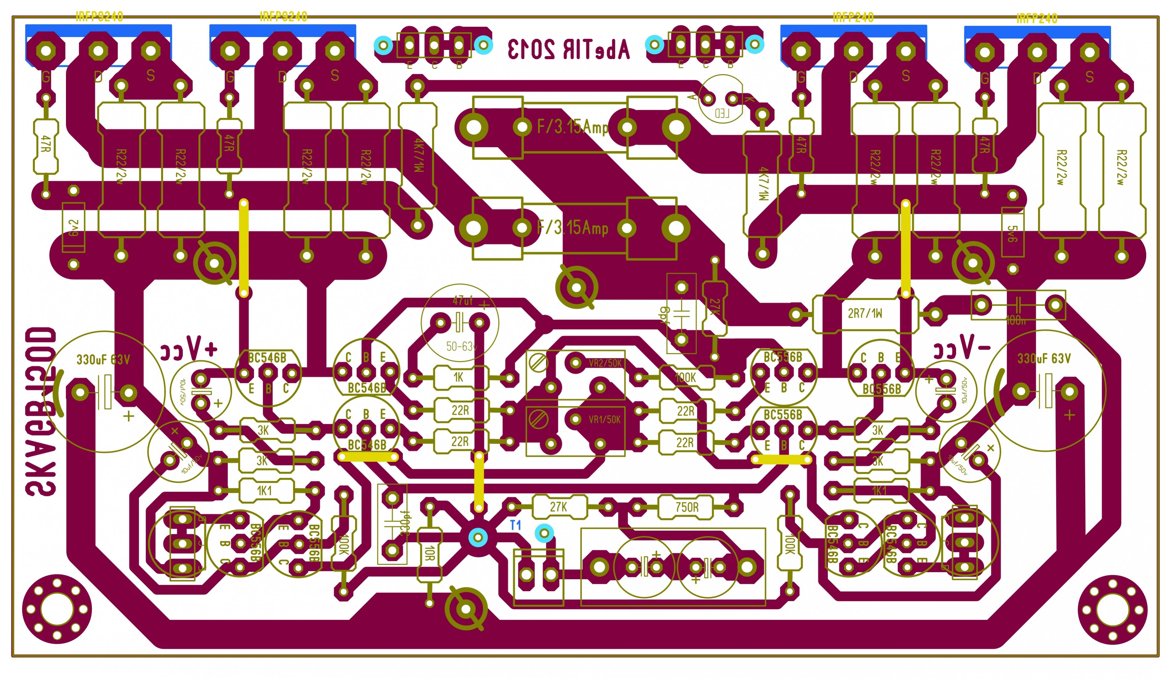

Hello Alex..... single layer PCB , first try .......![]()
Regards Alex
can you tell me what PCB design and schematics software do you use ?
Thank you
Where are the thermal sensing transistors?
The thermal sensing transistors are not placed on the heatsink yet, there will be required to drill 6mm holes for them. Other than that it is nice layout.
