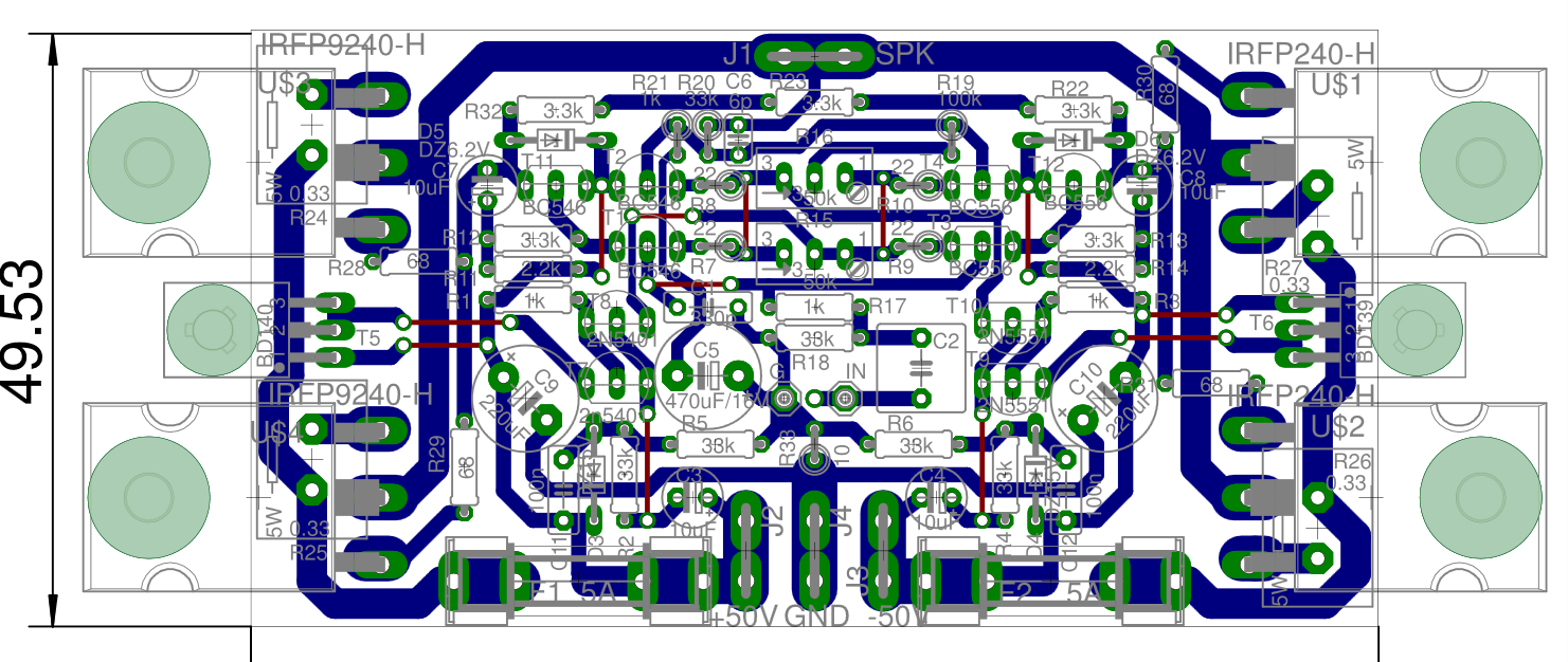

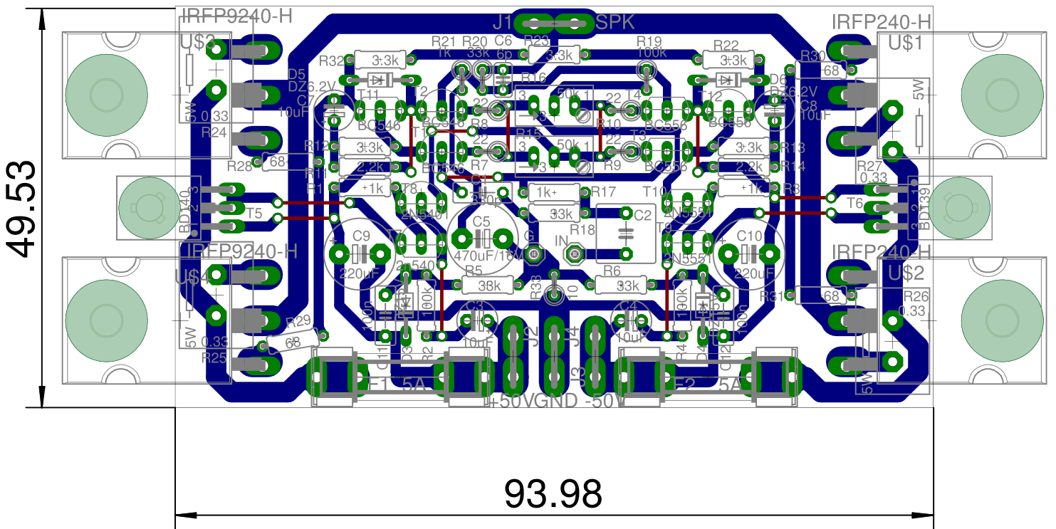

I had some time on sunday and I made v1 pcb, zobel and output coil is fitted in psu board. Why pcb is in that shape ? --> cause It must fitt my ebay enclosure, max hight 60mm and very little room inside (14cm wide only). Later on Ill post some updates.
If someone can spot some faults -- thanks for raport.

Nice layout & great to see more folk taking up the challenge of making their own pcb design. Some quick comments in case it is helpful at all:
Input cap: if you can't fit a large film cap then it's better, in my view, to fit an audio grade bipolar electrolytic. I've had good results with this and so too has Ranchu32.
Power connectors are pretty close together with the GND. Not sure what size fuse you have but I used 2AG size, only 15mm long and readily available from Digikey.
MOSFETs like to self-oscillate, a provision for a 47R in series with 100p cap between gate and drain can be a lifesaver if needed.
R31 is a bit close between the MOSFET pins, why not move it 'north' to the other side of the gate pin (like you did for R11) ? same with R30.
R29 is weird at an angle, why not turn it parallel with C11, bring a short trace out from the gate pin of U$4 so R29 can be oriented north-south ?
R22 & R32 can be eliminated and use 10k 1W for R23 ?
I found it handy to have the input be a connector, if you make the pins spacing 0.1" you can choose to use a small header & connector, or pins, when you build it.
My boards (TGM7) are only 50mm and would fit on your heatsink - but it's much more fun to design your own pcb and mine is SMT which isn't everybodys cup of tea.
Well I take back what I said as 4.7uf is already good so maybe it's no issue.
I used a wire link on my build but I have foot print for two sizes of bipolar, 10mm dia. with 5mm grid (Digikey 493-10847-1-ND) and the other for 5mm dia. 2mm grid (Digikey 493-10824-1-ND). On my TGM8 I'm using the larger one. These are audio grade Nichicon MUSE bipolar caps.

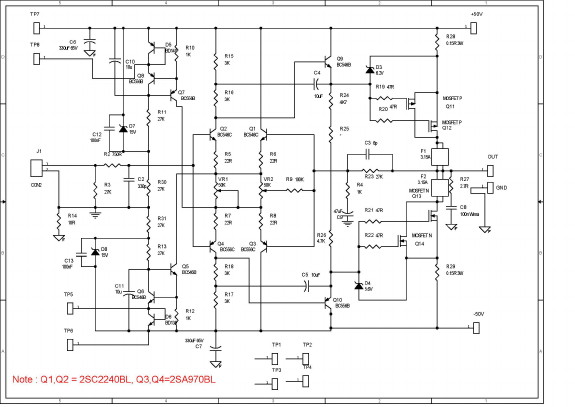

I have to say, after I found "My" mistakes, the amp plays very nice. As a matter of fact I have been listening to it all morning. The Jim's Audio boards don't use the BC*** parts for the LTP, they use 2SC and 2SA parts. I matched them because he said to but I don't know what would have happened if I hadn't. I thought it was important to match the outputs because they share only one source resistor, not one per. Am I wrong about that?

Greg does use a 0r15 source resistor, common to both NMOS and another common to to both PMOS parts, i.e. there isn't separate source resistors for each device. He recommends close matching. But as these devices have relatively high Rds-on the matching is less critical than you might think. I bought a batch of 25 FETs for my TGM7 build and when I tested them I found there was very little variation between them so that there was no need to buy very many of them at all.
