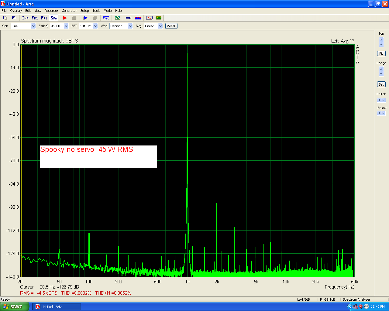

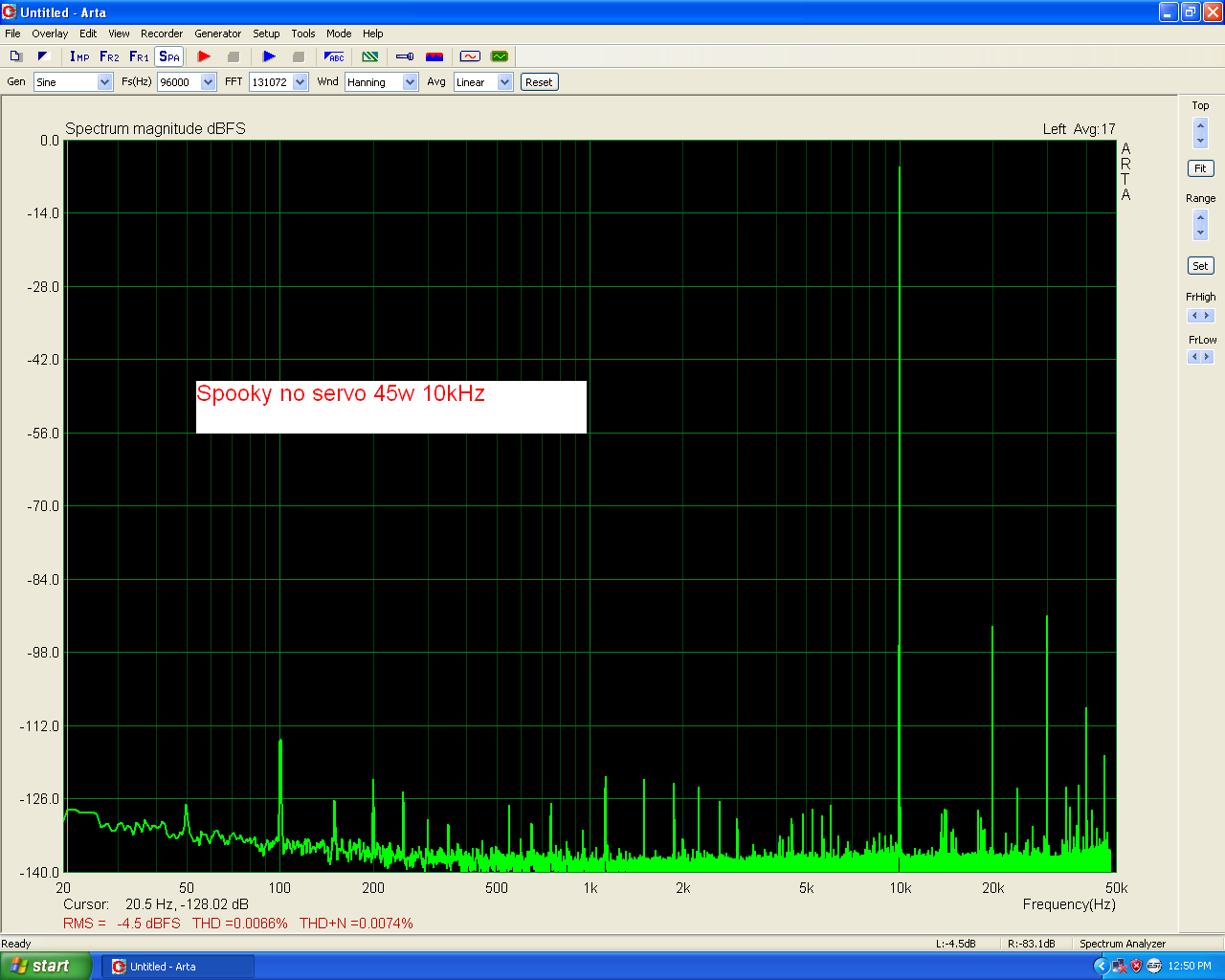

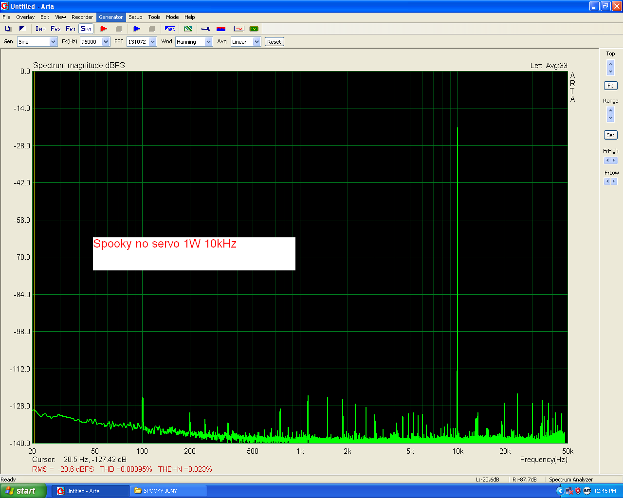

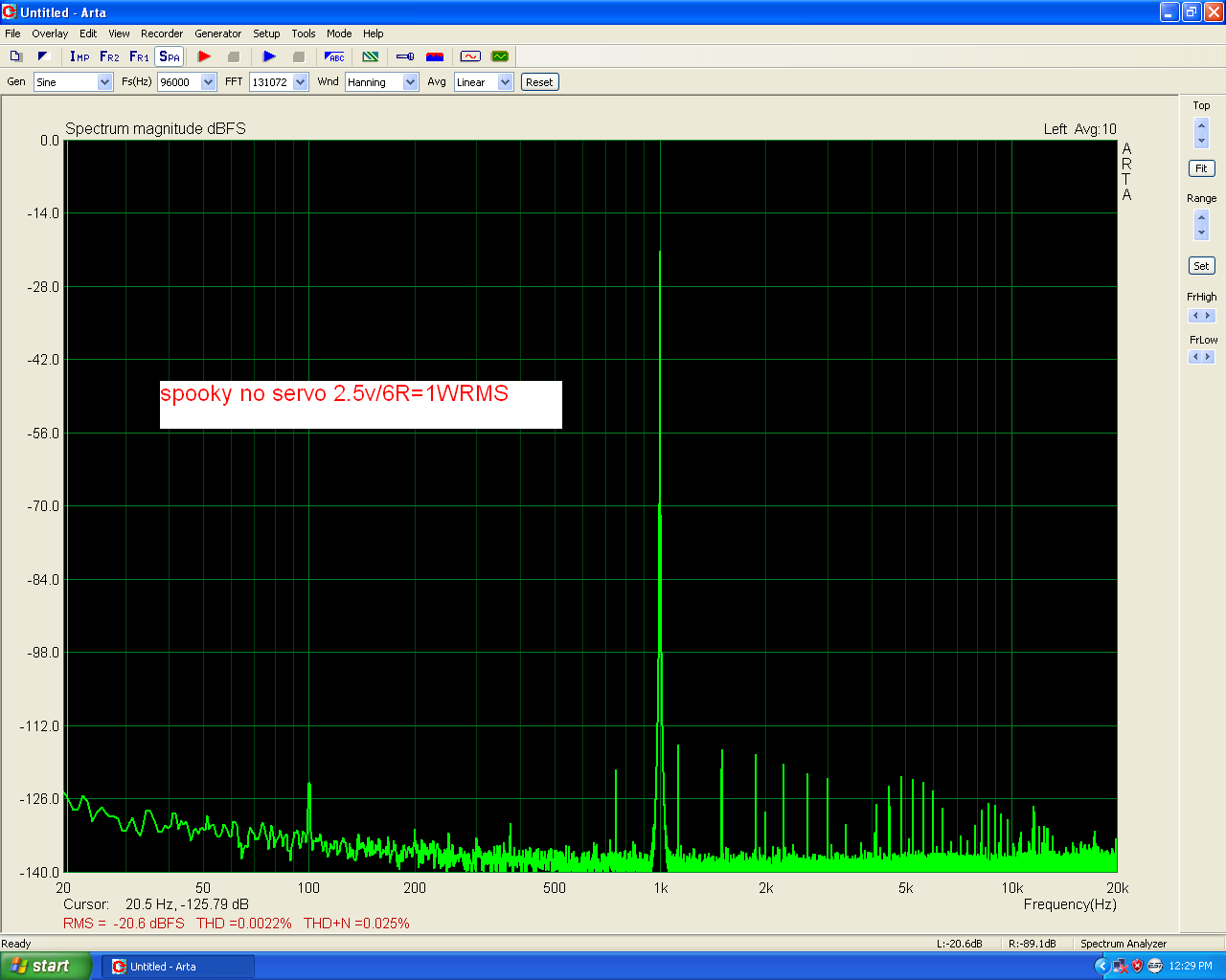

As my spooky has been modified for non servo function the first test was as it.
Power supply=+/-50v
75000uf/rail
offset=15mV
Idle current=0.015v/0.33R=45mA/piese or 90mA/Pair

Looks pretty good without the servo! Is this with the feedback ground connected to the lifted input ground?
Is your software set up properly? In the first graph, shouldn't the 1k spike peak at 0db (I'm still trying to figure out how to use the software)?
