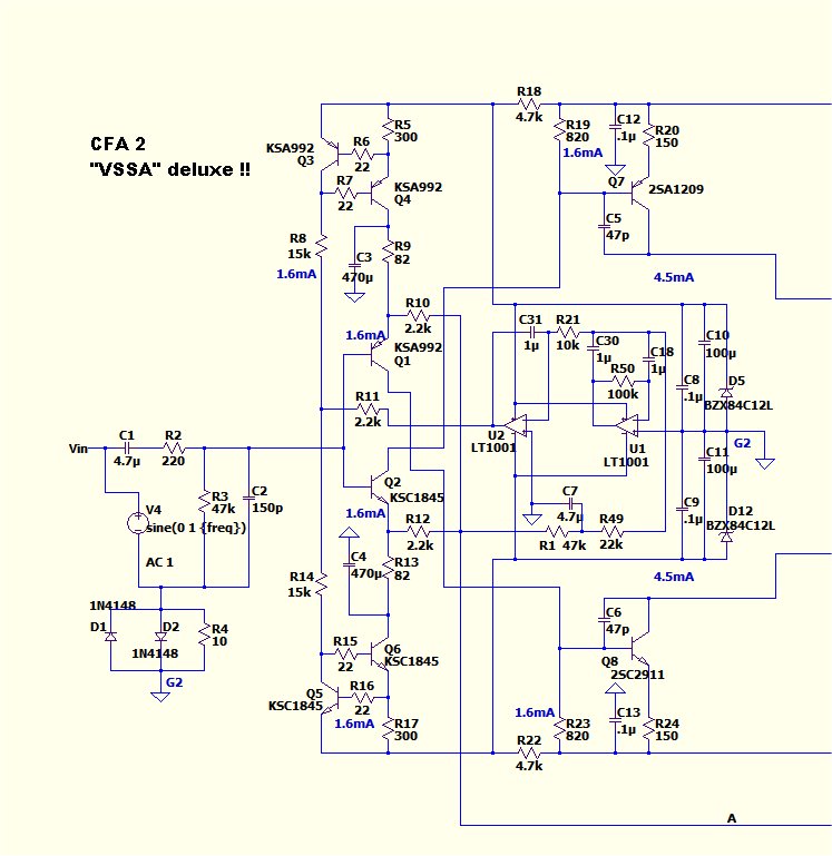

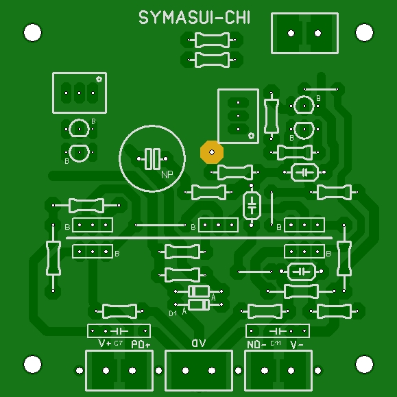

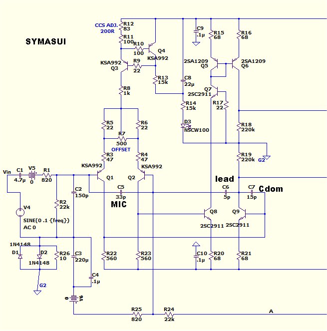

Symasym and ANOTHER CFA !
Almost done with the symasui. This would be a good amp for a subwoofer.
It has rock bottom LF THD.
It is (below 1-2).
Another is the "baseline" CFA , like the VSSA ... just 1 input pair/2 CCS's
and a super servo. (below 3).
PS - .ASC spice files for these 2 cool amps are also below :) .

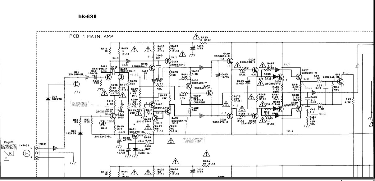

Why do you separate R20 and R21 on symasui? Is it any benefit than connect emitter Q8 and Q9 (like LTP) ?
Yes , you noticed.. Running the active VAS semi's in a "LTP" like
configuration will create more gain and since it is like having NO
emitter resistors ... instability , as well .
The way it is now is just a fancy level shifter/"turn around" circuit that
gives you the other half of the symmetrical VAS.
This circuit only has 53dB LF loop gain , about the same as the "VSSA".
They are perfect "rumble" IPS's ... as they both simulate at 20-30ppm 1/2 power -20K.
The symasui is almost exactly like the HK680 front end , so paired with
the EF3 , you will have the complete harmon kardon. :cool:
OS

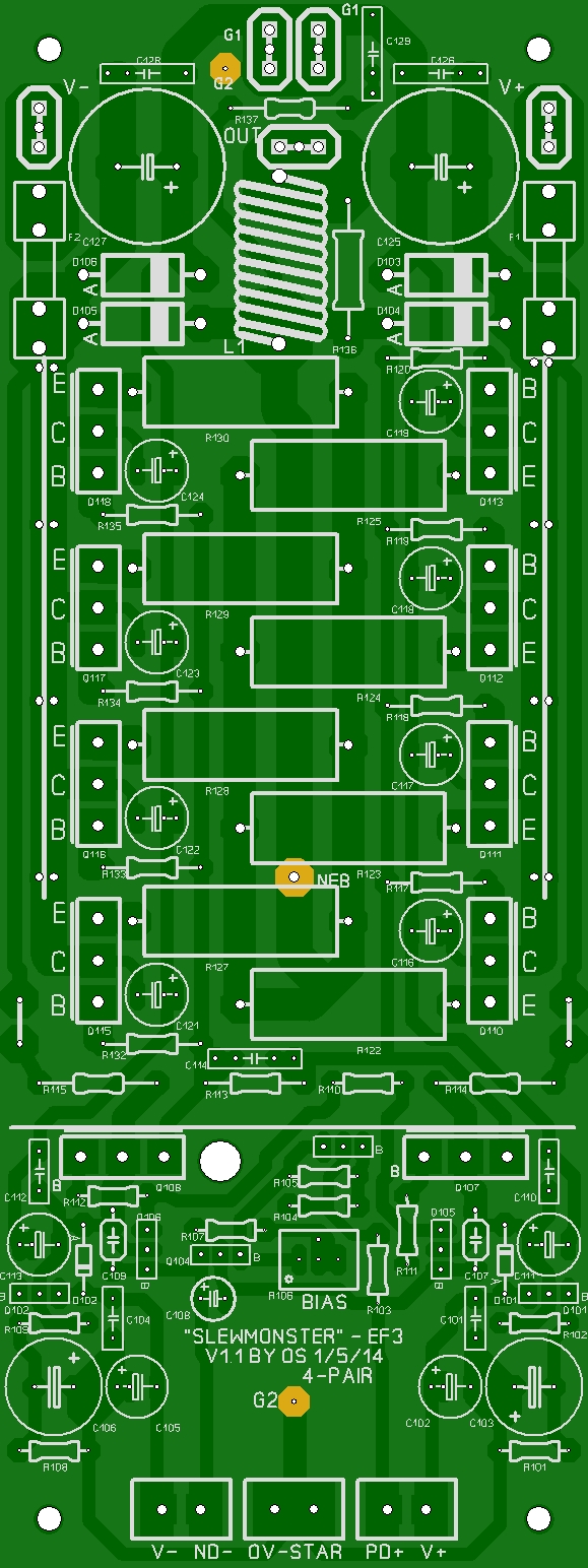

Brings back memories from the "supersym" days ..
A nice 4-pair OPS , nearly the same as my first "BIG" amp here on DIYA... (EF2-4 pair).
Except this is an EF3. 4 pair gets the cops called , I was playing "rush-tom sawyer"
with 120V p-p waveforms !!

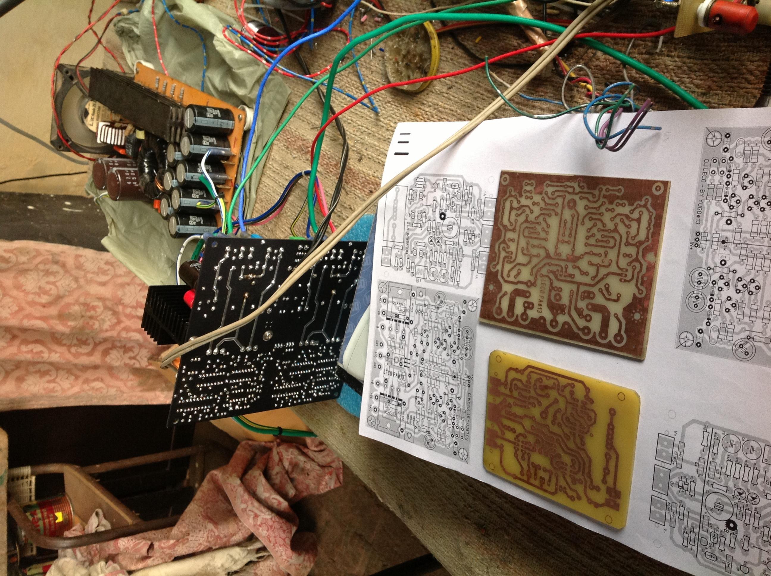

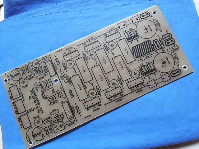

4 -pair = 76.2 X 203.2mm (3" X 8").
This will be mine when the toner arrives.:spin:

Hi guys,
Couple of pointers/links to someone who has not etched a pcb in years. I have inherited, a nice Samsung CLP-510 laser, with lots of toner.
I have used in the past, pre-sensitized, my own sensitived pcb's and toner transfer, using the iron. I was not very successful at it.
I have a drill press too and some of those special shank/pitch bits.
