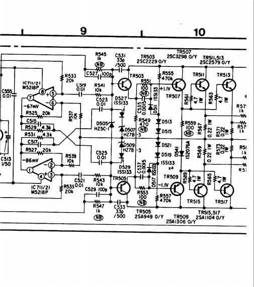

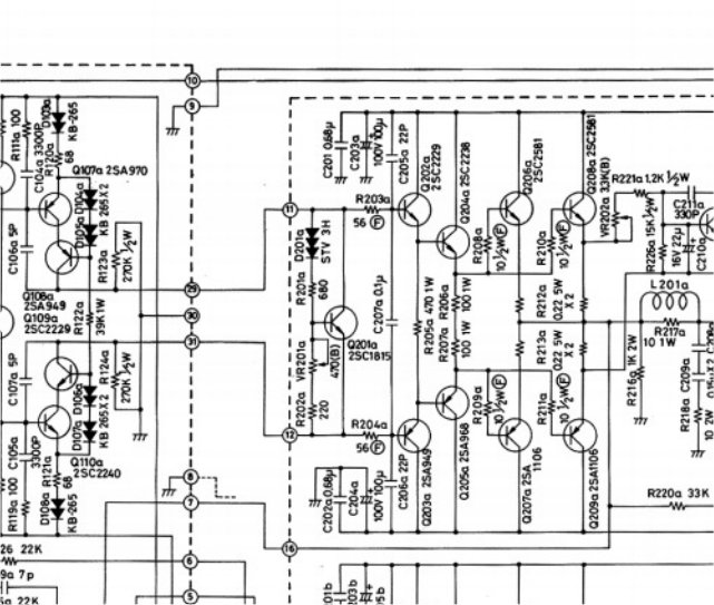

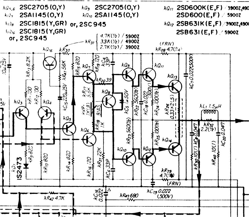

In ALL the 100+ OEM EF3's in my "collection" , the ones that use a fast
pre-driver always use B-C shunts (33-100p).
Dadod may of had good luck with shunting the driver , but I have never
seen this in my collection of schematics.
By far the most common was the 70mhz toshiba drivers sc4793/sa1837.
"fast/ fast/ fast " would be highly unlikely. Very few of the Sanken OP
lineup are above 50mhz Ft.
(3) examples below - all are "fast - Faster -slow " , all use 22p -33p to
shunt the predrivers ..... all I either own/recapped and are 20-30 YO !
For my slewmaster , I have some fast to-3p sankens for drivers , the
good ol' NJW's for OP and the mje's for predriver. Should be ideal.
OS

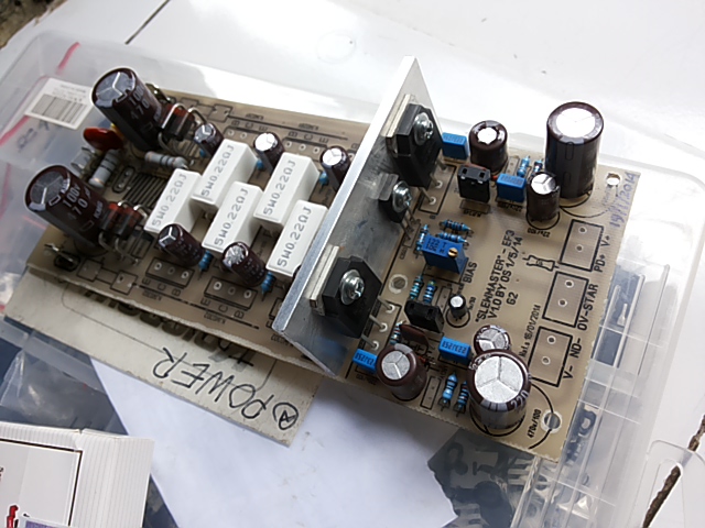

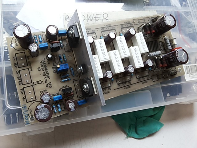

My progress was slow
Insulate the NJW0281/0302 drivers !!
Driver vbe (if all plastic) might not need a insulator.
looks GOOD !
OS
OS
I think that it's not really necessary. Check out the Marantz MA9, or PM11, or SM11. No B-C shunt was applied.
Sajti

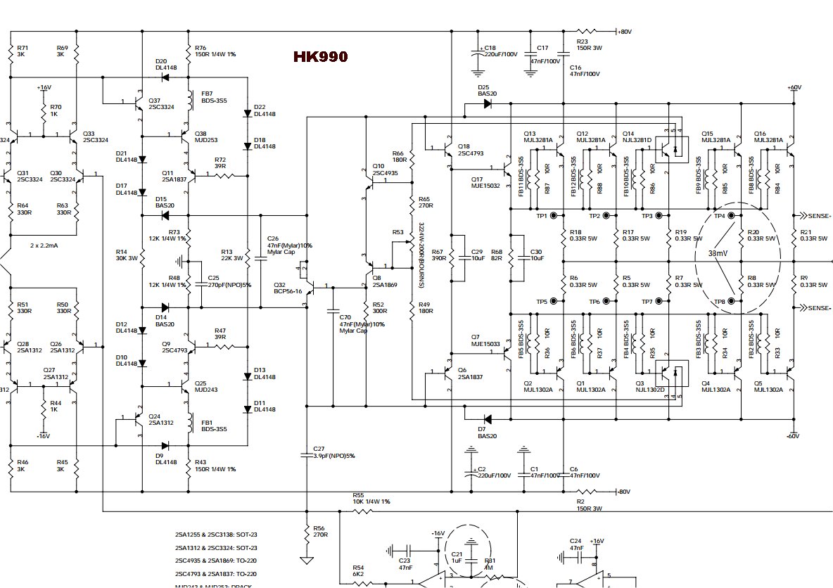

PS - It could also be a symmetrical/asymmetrical phenomena ... H/K's
990 has no shunts but has ferrite beads and inductors on the
output stage devices.
Edit - Actually , looking more closely ... they shunt with 270p at the VAS.
OS
