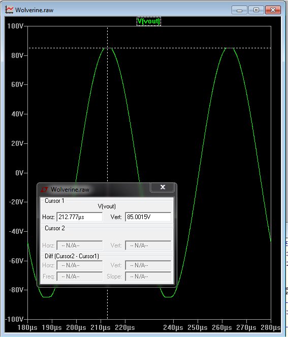

Speaking of IPS permutations, is there a spice model done for the Wolverine IPS? I tried putting one together from the schematic in post #599, but I can't get it to work. Maybe one of you can find the problem.
Thanks, Terry
For you , Terry ... I attached my latest .ASC for the "wolverine".
It is component compatible with the 1.3 layout , it might have a few component "tweaks". use any (semi)models in the circuit , it works
with just about anything (keens models - oem models - cordell .. etc.).

I switched out the devices I don't have and the attempted to add them to the schematic. Not sure if that worked since they are in my library. I couldn't get this thing to clip. I raised the voltage to +-92V because I plan to run one at that rail. Even with 2.5V input I see 135V p-p and no clip. Probably doing something wrong. Interesting.

That makes sense. Wow, 184 p-p into 4R is like 1200wrms. Is the gain low on this amp? Most of the amps I've simmed clip with about 1.5-1.7V input. What has to be changed to raise the gain on this amp?
Thanks, Terry
Holy poop ... 92V rails !
Changing gain too much might compromise stability. R2/28 ---> 22k is OK for
nearly 40X gain.
I set most of my amps for 28X and they clip at 2V with (normal rails)
Thimios/Terry .... Wolverine below - clips ... 170v p-p @ 92 rail ... 2.1v input
OS
Voltage gain - R28/R29 ratio.
But +-92 Ub means for optimally biased class B with 5 pairs output devices at least 90W heat in idle..Do you really need such power??
To be precise, the gain is R28/R29 + 1
Non-inverting setup

It's not that I need that much power, per se, but I have a Leach Superamp that I am going to gut and use the chassis and PSU for one of these amps. It has a 65-0-65vac 800va transformer so puts out about +-92v. It will be a fun experience if nothing else.
Make SURE your 100V caps are REAL 100v caps !!
Or , it might be an "explosive experience"
PS - be aware that standard BJT outputs have a lousy SOA at that voltage. Only those
Semelab "super BJT's" (the only ones that even have >2a @ 90+V) would fit the bill.
Example - MG6331 ... http://products.semelab-tt.com/pdf/bipolar/MG6331%20MG6331-R.pdf
has 2.5A @ DC and 4+A 100ms when running 90+V rails. ON/fairchilds are not even in the same realm.
OS
