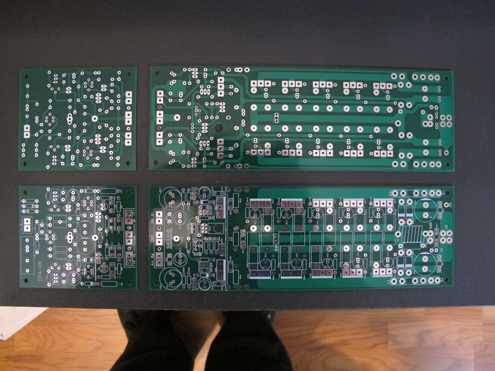

New shipment is in!
Just wanted to drop a quick pic of the latest boards. I'm just home over lunch and don't have much time just this second. I will start a thread or revive the existing OPS thread for these later this evening. Please keep this thread clear for discussion / development. Thanks.
