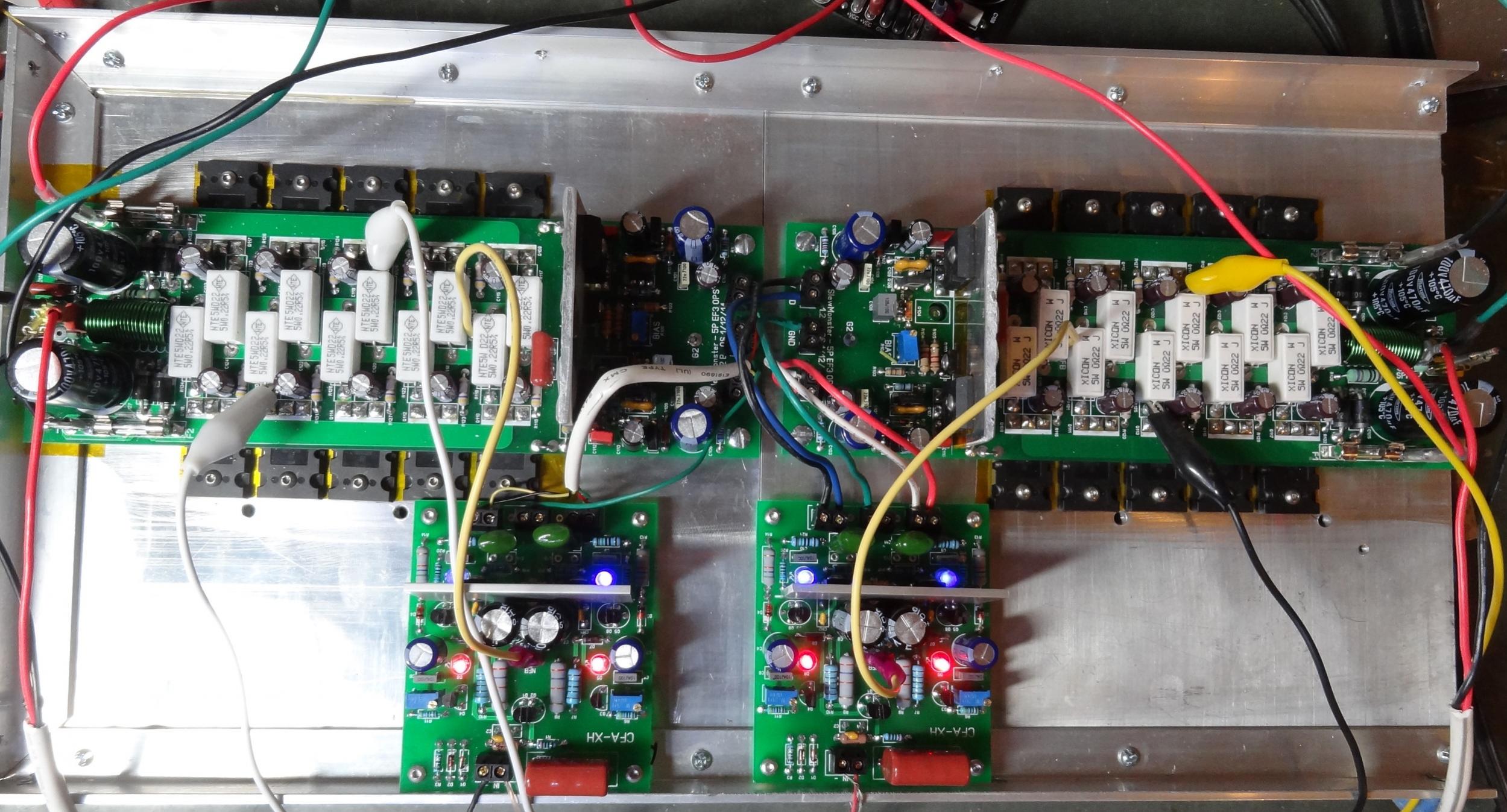

Hi OS,
That did the trick. No more oscillation and playing beautifully.
As for the UV's working as a clipping indicator? You have better have some pretty impressive speakers and a big room. I don't think I could get this to clip with my B1. Bet you need over 2V input to get there.
Hey OS, maybe you should edit post #1 to direct folks to the latest schematic so they won't have to hunt for it.
Oh yeah, how important are the 3K9 resistors? I have the 5K6 per the earlier schematic. Do I need to change those.
Here's a pic of it playing happiliy along.
Blessings, Terry

Cool ... 3K9 is for low rails , your 5k6 should be good for "monster " rails.
You have 90V rails ? .... your headroom must be nearly unlimited. I could
never get my 72V rail "supersym" to ever clip.
90V Clip should be 162V p-p @ 2.9V input. If you want to be outrageous , drop R7/10 to 68R ... stability is the same , but clip = 162V@ 2.2V input.

No I am currently running +-77V rails. The 90V rail OPS is currently waiting until I decide which one will work best for that. It will reside in the case currently occupied by the Leach Superamp. I have already built the OPS boards, just waiting to try some more of these IPS before making a decision. It will be cool if the best turns out to be the CFA-XH since I have extra boards and it is cheap to build. 🙂
I already tried to get it to clip with my sine wave generator but it only puts out 1.3V and wouldn't even come close.

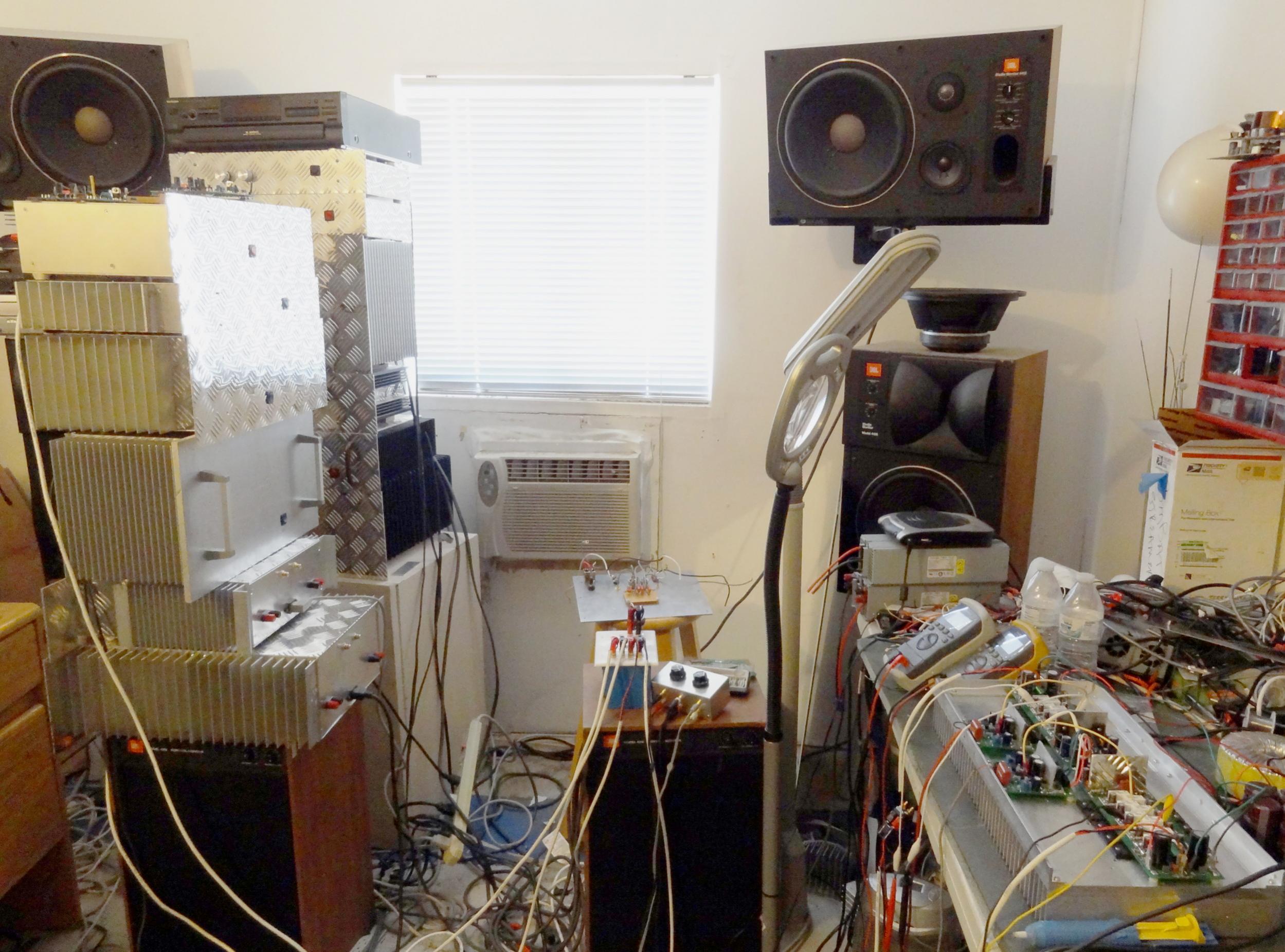

I just got in from my workshop where I was able to do an A/B listening test with the PMI VSSA and this CFA-XH. With the volume equalized, the PMI VSSA seems to be just a slight bit "tighter" sounding. It may be that the CFA-XH has a slightly more extended bottom end and that makes it sound somewhat looser. I am being very picky here because my biggest thought listening was , "how is it that I am fortunate enough to own an amplifier that sounds this good?" I mean, these are both absolutely stunning.
The A/B setup is this. Technics CD player into a Mesmerize B1 buffer. From there it goes to a box with dual 15K stereo step-attenuators that feed each amp. The amps then feed into a speaker switch which feeds into one set of speakers. The volume pots are set so each amp is producing equal output power and then the speaker switch toggles between the two amps while they are playing.
For this test, I had the switch feeding into 4 speaker cabinets. A JBL 4425 and JBL 4412 on each side hooked in parallel for a 4ohm load. I do this because the 4425 has a more extended bottom but the 4412 has a better high end. This makes the sound stage huge and also provides a 4ohm load. I can unplug either cabinet to try out other scenarios.
At the end of the test this morning I actually had the VSSA at unity gain with both the B1 and the 15K pot at full volume. The CFA-XH was slightly attenuated to keep the output equal. This was very impressive. I must say, it does pose the question as to whether it is worth investing in multiple outputs and huge transformers when a two output, +-36V amp can basically hang right in there. Maybe it is just testament the greatness of the VSSA design.
Attached is a pic of the speakers. Forgive the mess, I had to move things around to retrieve the Aleph-X chassis and just haven't taken the time to reorganize.
