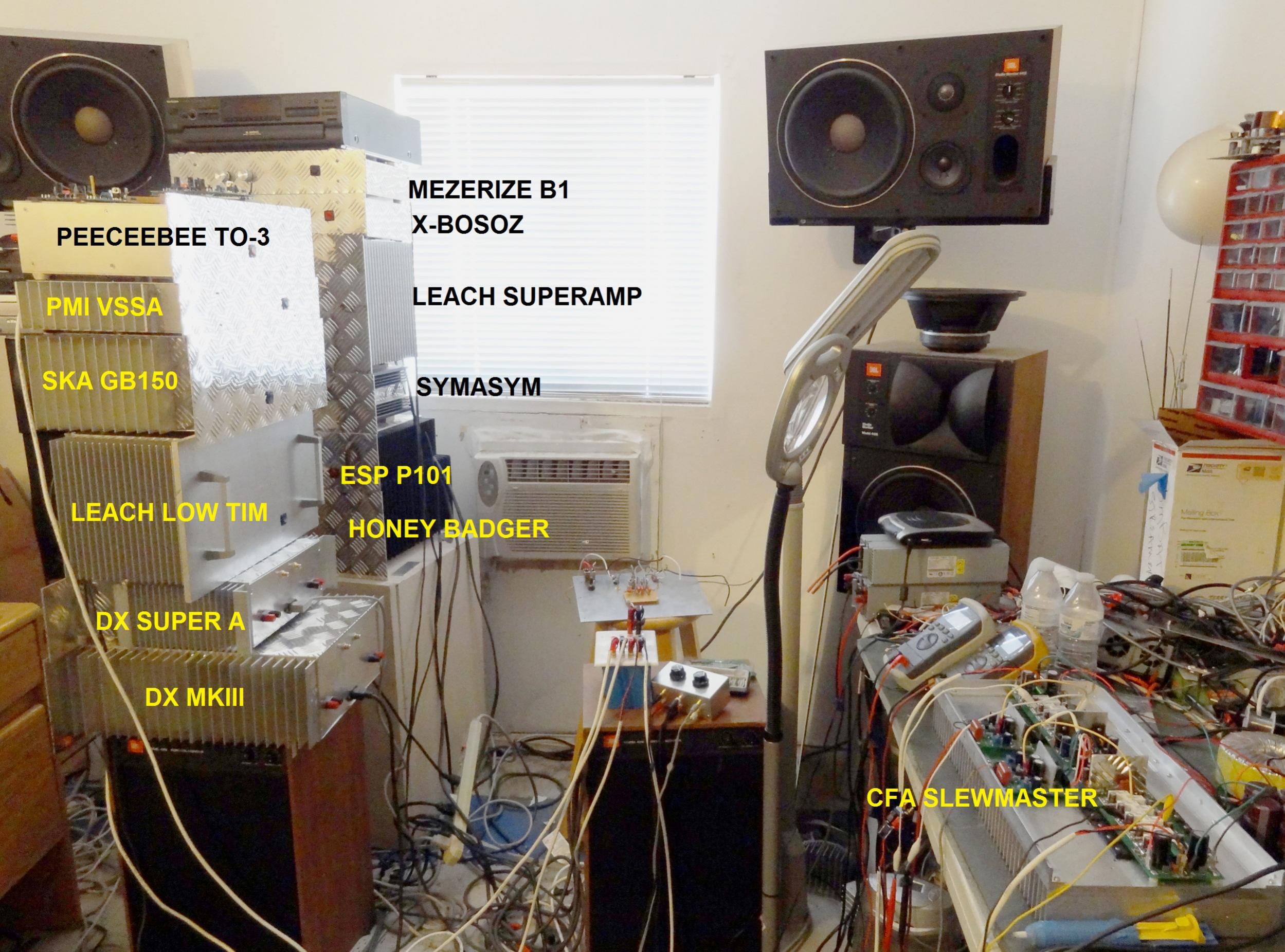

Holy stacks of stuff...I'm jealous.

I'm attaching the pic with some labels on some of the amps I've built. I know diamond plate is not for everyone but I think it's purdy.

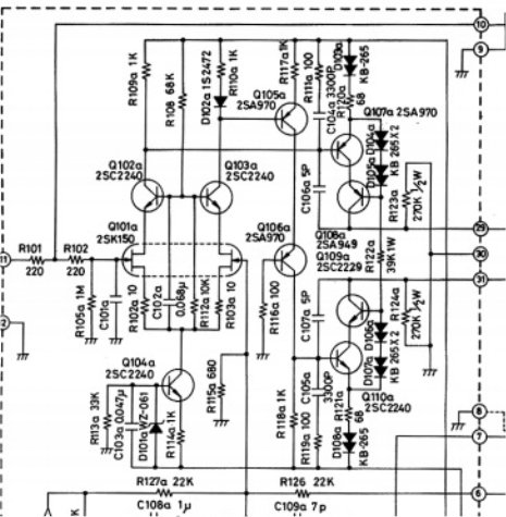

Luxifer ....
No problem , JK ...
Might bring back the "mighty" luxman 120a (below 1/2).
REAL FET input pair ... I think I need more CLG.
This was my first hawksford ... it sure sounded good 5 years ago.
I'll keep it simple and try to find a easily sourced fet w/good specs.
OS

So in your opinion, going for a CFA is a waste of time? Or did I misunderstand your comment?
It would seem that most of the VFAs do offer superior numbers.
Joined 2009
What I can say is that my TGM7 (high CLG) which can be built as CFA or VFA was first built in VFA form. It sounded so darn good I never got around the CFA version. Actually, I was hoping Fab or somebody would try it - I don't appear to have the time or focus that Terry has to spend on building !
