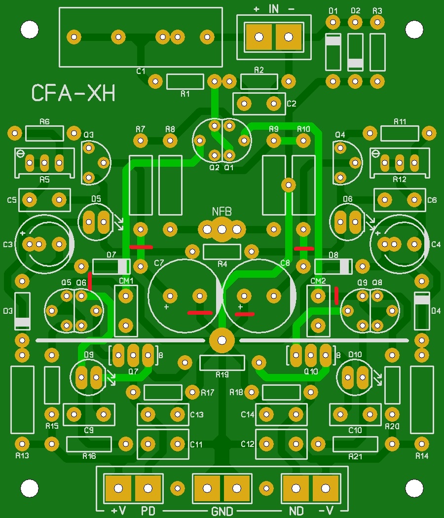

Have a look at these mods to the current CFA-XH boards. Some value changes aren't shown but the cuts and jumpers are.
Let me know if you see something I missed.
I'm not advocating that we follow this direction but since I have extra boards I want to try it. DIYA baby!
That looks like it ...
You are right on top of things , terry !!
This is a safe mod , I ran the hell out of the sim. It works and
definitely performs quite a bit better. (nothing is lost).
don't forget the 10k's from Q1/2 collectors to the hawksford CM's !

I built the CFA-XH V1.3 Mod1 that BV posted. On the pic of the board with modifications that I posted earlier, I missed the two new 10K resistors off of the collectors of Q1 & Q2. There are two more cuts that need to be made. I added the resistor under the board. I am attaching a revised picture. I tested the IPS but didn't have time to hook it up for a listen. Square waves look very clean and square. I will do more in the morning. Adding a pic just showing the trace cuts for clarity.
