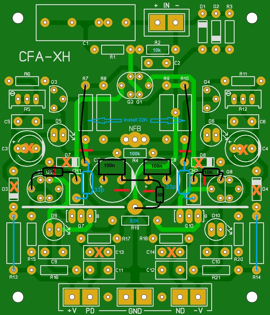

I built the CFA-XH V1.3 Mod1 that BV posted. On the pic of the board with modifications that I posted earlier, I missed the two new 10K resistors off of the collectors of Q1 & Q2. There are two more cuts that need to be made. I added the resistor under the board. I am attaching a revised picture. I tested the IPS but didn't have time to hook it up for a listen. Square waves look very clean and square. I will do more in the morning. Adding a pic just showing the trace cuts for clarity.

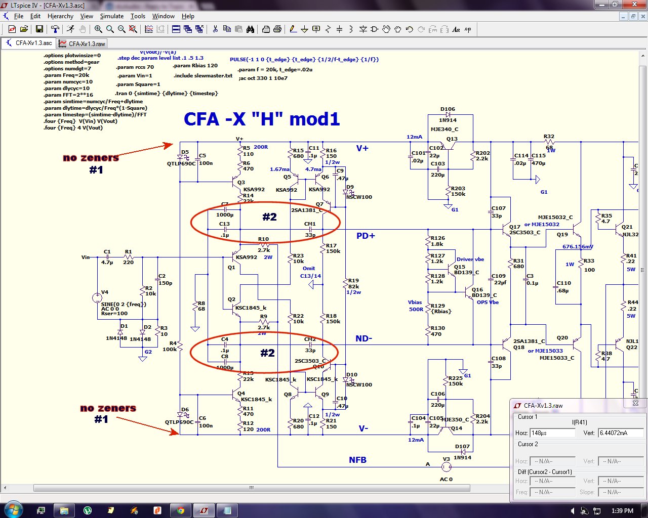

Terry ,can you say what compensation has you put there?
Value and type if it's known

Hi OS is this the correct schematic with all modifications?

I am waiting listening impression for the new compensation. Please Thimios, Terry do it. I will try it next week, may be.
With simple cfa (no diamond buffer), new compensation, and 2ef output, I get THD 0.006295% at 20 kHz, 60W/8Ohm with power supply +-44V. 😎
RC filter on transistor driver power supply can increase PSRR almost flat at 128 Hz to 3kHz but reduce maximum output voltage (I can accept this trade-off). With capacitance multiplier on VAS, it can achieve 126 dB PSRR at 100Hz. Slew rate is 760V/uS. At least on simulation.
I agree with OS. This kind compensation can beat VSSA 😎😎😎

Hi Thimios,
I just checked and I did install 82p there. Maybe it is not needed, I don't know.
I noticed that I had some errors in the last picture I posted. I have reworked to reflect exactly the changes I made to my boards to match BV's last schematic. I will be testing it shortly.
