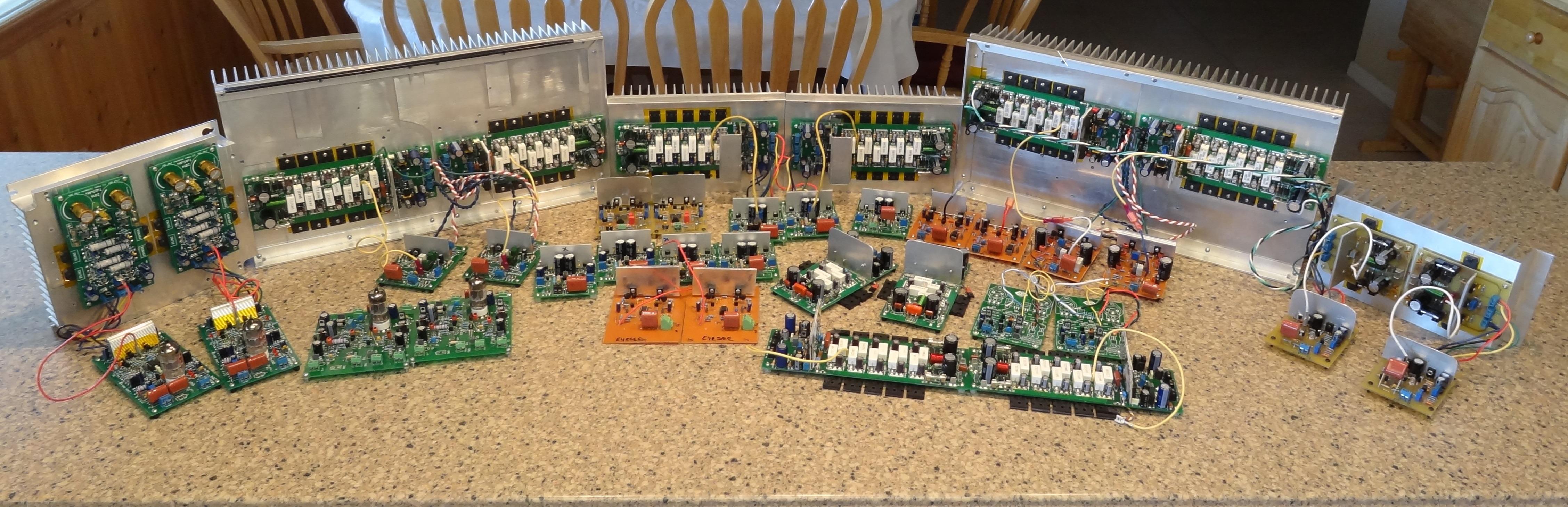

That's impressive Terry. Do you have a least favorite among them?
I suppose that would depend on what you are looking for. I have not finished proofing the Kryptons or the Tubsumo so I can't fairly judge those. The rest sound stellar so all I can recommend from is the build. CFA-XH is the easiest save maybe the Eyesee, but I haven't finished it. The Spooky and Symasui have a servo so they are the easiest to setup. The Hybrids require extra equipment and setup. The AX-14 IPS is from and Apex design and has the "super pair" that seems to be deemed problematic, but works great in this design.
Probably not much help but the best I can do.
Blessings, Terry

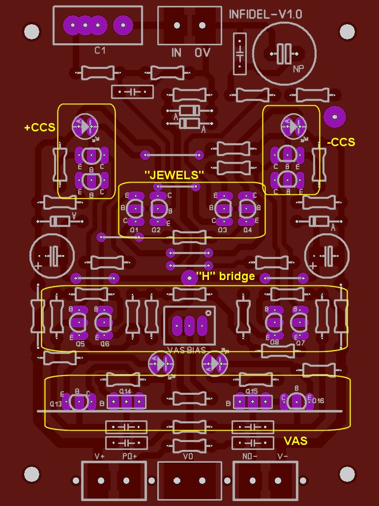

Infidel 1.0 - H bridge/ CFA killer.
Attached below - all done !![crazy :crazy: :crazy:](https://files.diyaudio.com/forums/images/smilies/crazy.gif)
PS- toner people , look it over. Think I traced every connection while labeling.
This one has 2 diamond buffer rail X-overs - a bit harder (like 2 NAD amps
back to back).
OS
back to back).
OS

Today kinda turned into a play day. It started with cleaning off my work bench and once I got all the stuff pulled out I couldn't help but get a picture. I needed a little break from chasing oscillation. I'll get back to work on it tomorrow if I can keep myself from building the Infidel.
What a range of "technologies" there!
Isn't that the truth. By the time we finish the Slewmaster series, there will be no stone unturned.
Blessings, Terry
