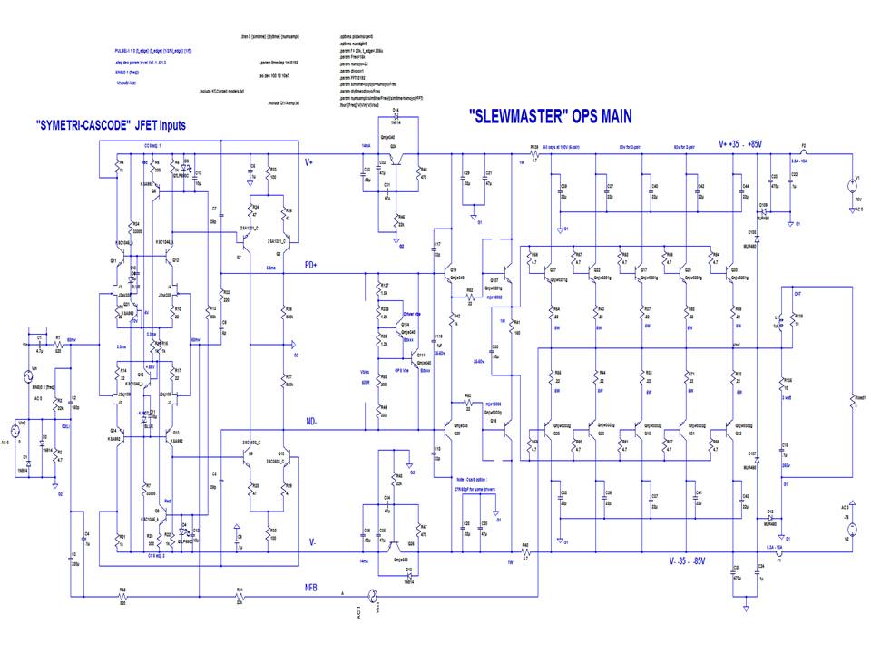

... Cascoding the Symetri inputs also allows using ultra low (2db)noise JFETS as input transistors.
Has anyone here built (offered up??) a JFET version of Symetri?
The "SYMETRI" simple complimentary (Bimo) has many supporters. ROBUST topology.
"Symetri-Cascode" post #8349. You can run the .asc file to confirm ~ 25% lower THD with your models.
The "spookyamp" (leach amp) also uses complementary cascoded inputs, with a Hawksford VAS instead of the second complementary diff VAS used in Symetri. The BC5xxC transistors have a 4db noise figure. Cascoding the Symetri inputs also allows using ultra low (2db)noise JFETS as input transistors.

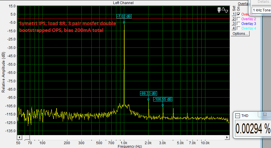

The "SYMETRI" should use high local negative feedback and use Miller compensation as small as possible. I tried it using double emitter output and PSU +-45VDC, and I pleased. Here the simulation result:
Phase Margin = 84
Gain Margin = 19
Slew Rate = 140
THD at 70W/8Ohm, 1kHz -> 0.004852%
THD at 70W/8Ohm, 20kHz -> 0.008530%
PSRR 1kHz -> 103
Normal JFET input conversion.

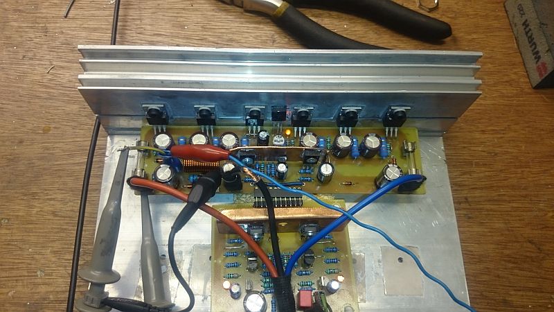

I have no idea how does the Symetri j-fet sounds like but with mosfet OPS sound really nice. Just look at the harmonics level - like in the good old book![]()
There is an interest to use Jfets as input devices, as they don't demodulate HF parasitic components like does the diode of bipolars. But to take full benefit if it, you need to low pass their outputs as they are fast.I have no idea how does the Symetri j-fet sounds like but with mosfet OPS sound really nice.
Hello Borys,
I am interested in your mosfet OPS. Could you please point me to the details? I presume that it swaps in place of and Slewmaster OPS, correct?
