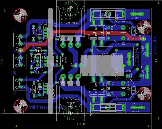

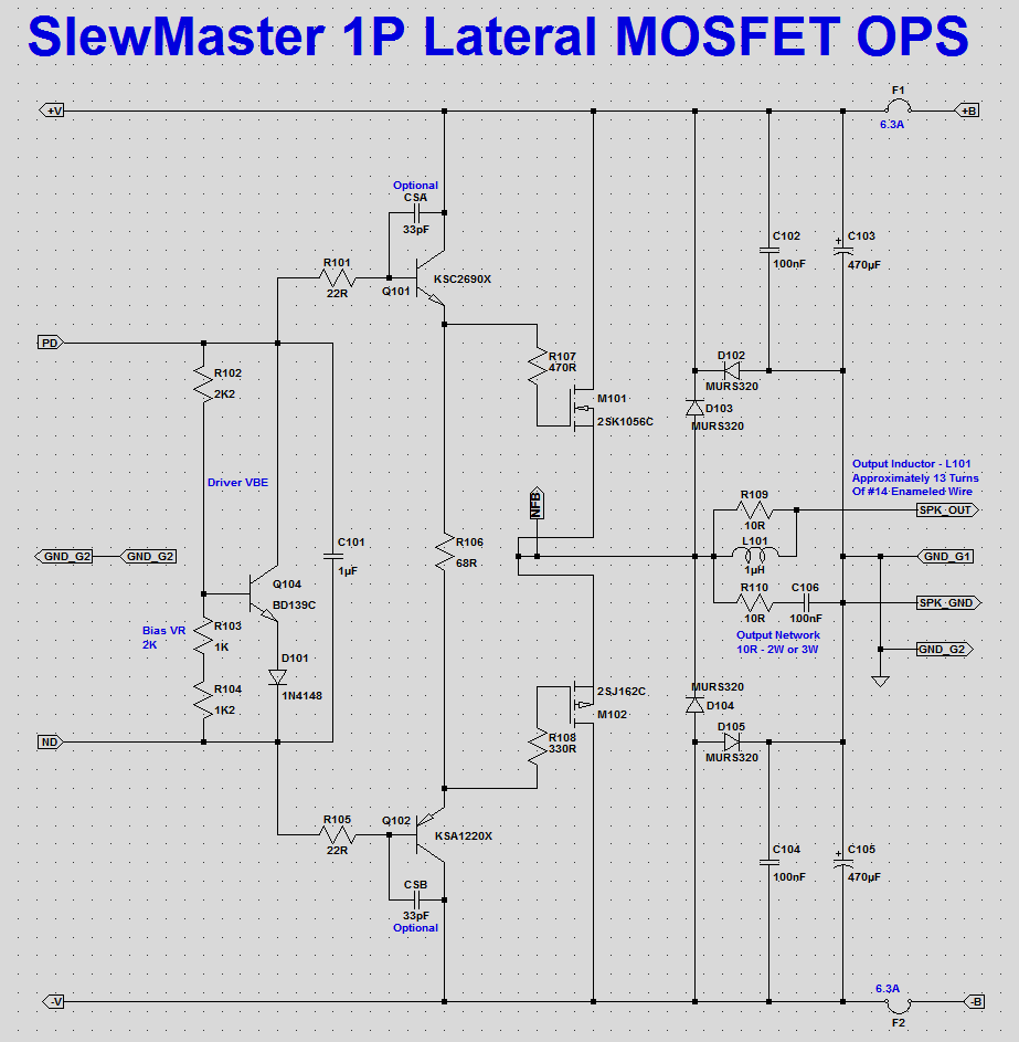

Development snapshot of a compact OPS
Here's a nifty little option to the bigger OPSs we have been concentrating on. It is a single pair of Lateral MOSFETs with an EF driver on a 3" x 4" board. it is a very stripped down implementation for lower power applications, say +/-50V max rails. Any interest? If there's interest I'll consider ordering some when the Spooky IPS is ready to order. Post your interest / thoughts on it please.

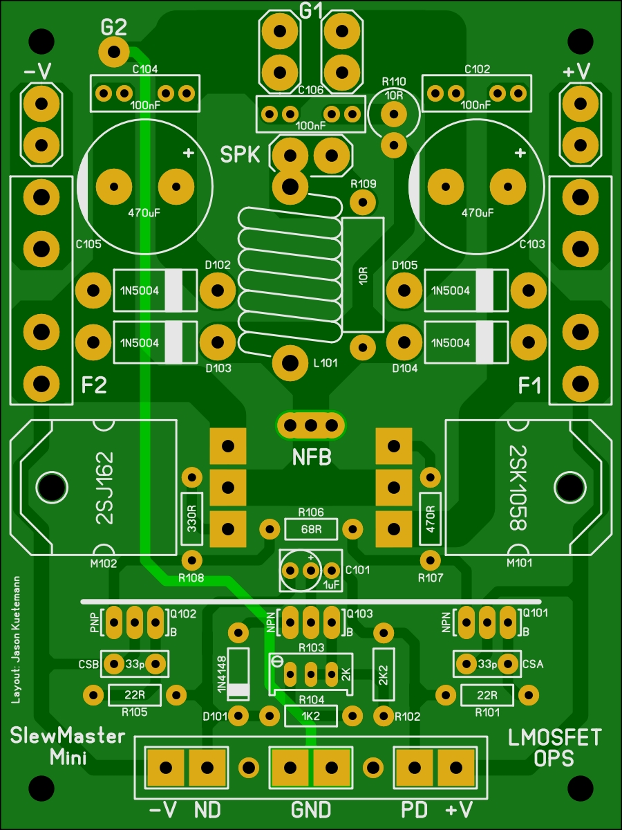

OK, points taken. I'm not sure I have the room for the bigger devices, at least not if they are to stay completely under the board. It would also be required to place gate protection diodes onto the layout. I'll play with it to see, but this might just remain a TO-3P / TO-247 layout. I keep forgetting about the ALFET / Exicon products since they are virtually non-existant in North America (certainly the case here in Canada).

As it's a "minor concern people" situation the To264 devices don't needs to be completly under pcb (if the whole can lay on a 100mm wide heatsink). As i watch you latest screen i think you more than enough space around may be you should displace a little Lat fet toward Driver section but not a lot and as i suggest lat run V+ and V- tracks before and not after the 2SK/2SJ Hole screw facing the middle line of the board.
Marc
If you're not going to try to fit on a 3" heatsink, why not just use the original layout? The whole reason Jason moved them under the board was for the narrow heatsink.
Because of heat transfer i like better to have more centered Output devices instead to have them more near to heatsink outline but that nothing more than details..

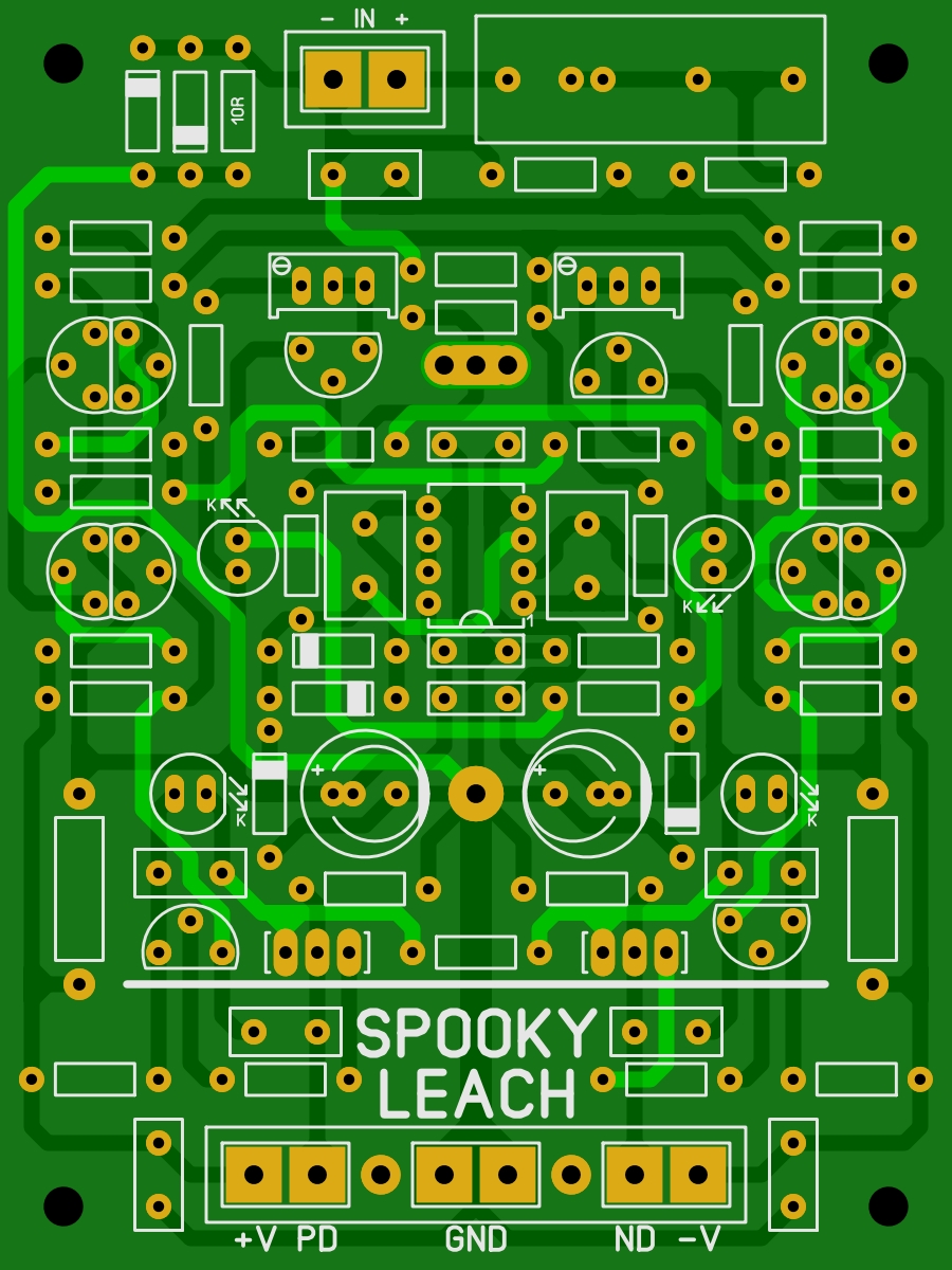

Spooky Leach
Finally making some real progress. No designators / values as yet but this should be close to a final layout. Time to mark everything up and start going bug-eyed checking it over...
