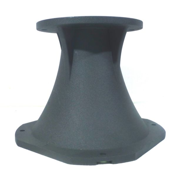

Just to follow up, I'd recommend this one, already mentioned above:
2" Throat Horn Bolt-On 18"x10"For Assorted Bolt On 2"Exit Drivers 90degx 40deg(398) | eBay
The polars are about like the K-510 but note that this horn is about 50% larger volume than the K-510 (but that's still relatively small). It will require equalization with its mated 2" compression driver. Again, I'd recommend Faital Pro HF200 series drivers if you've got a choice.

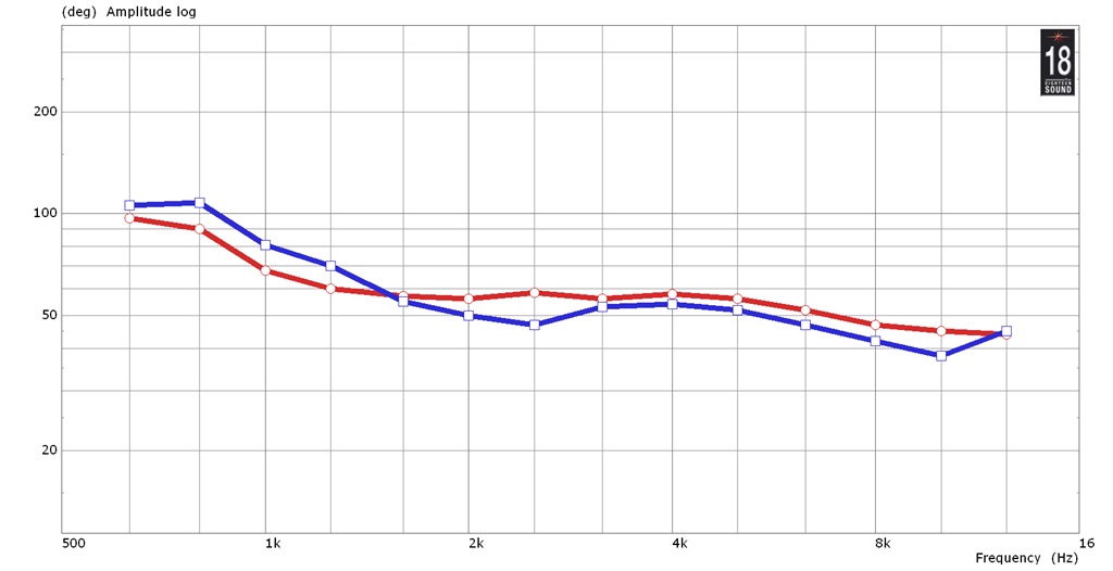

Hi all, Interesting thread !
FWIW, I've been crossing a 1.4" BMS coax CD at 650Hz running really loud.
I'm sure I could take crossover down to 500Hz using either a RCF HF950 or a little bit larger 18 Sound XT1464.
But since my application is live-sound and rattling my house, I play it safe at 650 Hz.

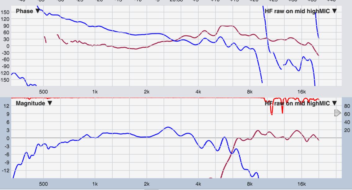

To help add some objective info to my last post...
Here's a couple of on-axis raw plots, of the two coax sections of a BMS 4594HE on a xt1464 horn.
500Hz looks doable, yes? .... gonna give it a listen...
