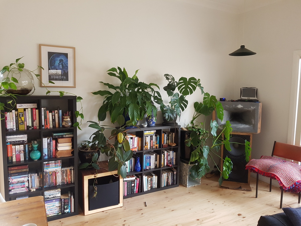

Looks like I can replace / rebuild this system (pictured: 80cm wide horn + bass box) as a single box straight-walled MEH.
Single box: because the 2-box stack has poor space efficiency, with ~120 litres of wasted volume behind the horn.
Straight wall: partly based on Chris' advice, partly for ease of build.
MEH: partly out of interest and partly cos the current sound is let down (especially in the current room) by the low mids & bass.
As the photo indicates, it is a fairly big living room, not a dedicated audio room (or man cave), with plenty of hard surfaces. One wall is mostly glass. The LF sound quality changes hugely as the speaker moves; the corner is much better than a previous spot.
While the dimensions of the current horn are OK (80cm width), my GF doesn't love the industrial aesthetic. I want to build with ply & apply a pretty skin of 5mm bamboo (non bendy), hence simple = good (the fewer angles I have to do, the better). The secondary expansion would be a hand-shaped roundover to a laminated panel, like in this project, which is the nicest effect I can get without having l334 woodwork ski||z.
I chose the dimensions + angles below (by trial and error) to get a simple horn with reasonable angles that can be cut using router bits I already own (the angle z = 45 degrees, 'r' = 22.5 degrees).
FULL SIZE, SINGLE EXPANSION VERSION
90 degrees - horizontal
65.52 degrees - vertical
400Hz - horizontal pattern control (vertical should be ~600Hz)
31mm throat (shape to 44mm round - this is ~actual driver size if measuring to the middle of the surround)

Syncalc + Hornresp tell me I should be OK going 2-way (crossed at 500-700Hz) using the 2" Tympany driver plus a quad of 6.5" woofers. The Tmmphany SDS-160F25PR01-08 are cheap, only 1kg each, and would work well with ~30 litres each. It looks like I could cross them (digital filter) anywhere from 500Hz to 1kHz.
Does all of that seem reasonable?

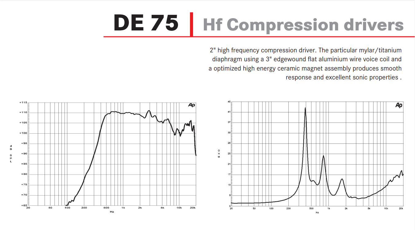

Earlier in this thread reference was made to some 2" drivers, among which the Faital Pro HF20AT, TAD TD-4002 and 2 B&C drivers.
In post #30 Chris (Cask05) referred to a plot "that was done in the Klipsch anechoic chamber in Hope AR using a K-402 horn and a B&C DE75 compression driver."
and:
"They now use a B&C DE750 driver, which they call a K-691 driver. I can post plots of that driver's performance if required. It performs well."
Many Altec and JBL afficionados know: "change isn't always for the better".
Among the Econowave crowd it is also a well-known fact that early production B&C DE250s are of higher (sound)quality compared to later series.
As mentioned by Chris, before the current DE750 was introduced, B&C DE 75 drivers were used by Klipsch.
The DE75 was close to being phased out by the time the 402 and 510 Horns were released.
The available specsheet of the B&C catalog is from 2002.
The older drivers apparently had some issues with diaphragm durability under prolonged abuse in PA applications.
This, amongst other things, probably led B&C to change the design.
The 2" drivers I refer to are: BBC & B&C DE75, DE75P.
"P" stands for Plastic Phase Plug.
Characteristics of the DE75PTN, the immediate successor to the DE75 and DE75P, and the predecessor of the DE750 :
One thing thing you can rely on is the accuracy of B&C's published specs and measurements.
From the datasheets:
- IMPROVED POWER HANDLING OF 110 WATTS AES STANDARD & 220 WATTS PROGRAM
- B&C's DE75PTN 2" exit HF driver features an ALL-TITANIUM diaphragm for increased durability and accurate response.

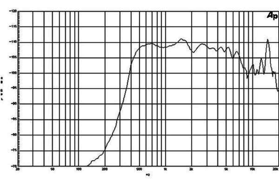

A number of years ago, Art Welter (Weltersys) compared several compression drivers and posted audio clips he made during these tests. It's quite illuminating to hear how much better the larger diaphragm drivers sound at lower frequencies.
The B&C DE82 compared favourably:
"The B&CDE82 has most all the elements I look for in a compression driver: low distortion, extended bandwidth, high output capability, relatively low weight and cost. It was not the most efficient driver, but was the flattest overall, and appears to handle the extra power it requires over the others with no problems. The only small complaint are some response glitches at the very top end of it’s response"

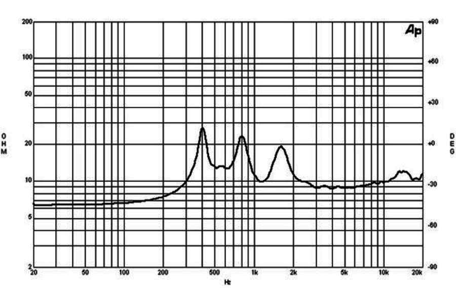

And this is the response according to B&C:
