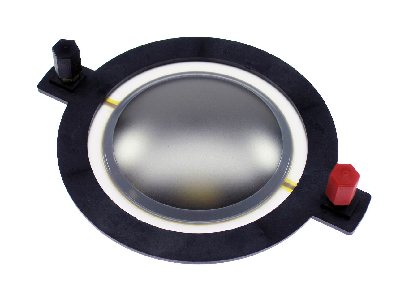

I wonder if somebody has ever compared diaphragms of (Klipsch) drivers.
This showed up as a replacement for the K-691:
  • B&C MMD3ATN8M Diaphragm for DE72TN DE75TN DE82TN DE85TN DE700TN DE750TN.JPG

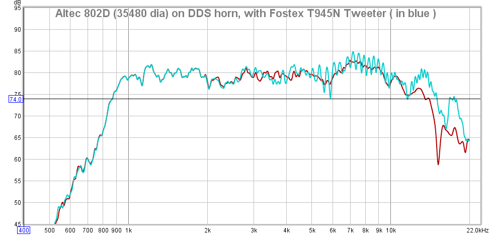

As you might remember, I've gone without tweeters ( though I own many ) for at least 15 years ( while getting tweeterish sounds from my 288-8Ks ).
Sadly, for some time now I've been noticing that above @ 4K they just aren't as responsive as they once were.
- Naturally based on my 60+ age I was blaming my ears ( until I swapped in some Celestion CDX1-1745 drivers that restored that range in spades.
- The thing here is that the loss of response does not show-up in any response sweeps that I've made.
So I'm now faced with buying new diaphragms from GPA for my 288's ( not going to happen any time soon ) or finding a way of making do ( while restoring the lost responsiveness of that range ).
To that end I've just recently started using a Fostex T945N aimed at the wall behind the speakers ( it's an ongoing experiment, especially when paired up with other mid drivers ).
For instance; when paired up with my Altec 802D's ( which are about 4-6db less efficient than the Tweeters ) the tweeter splash is still very much present in the over all sonic presentation ( even though the tweeter faces rewards ).
See;
attachment.php
Even this single tweeter is quite noticeable due to the extra "air, haze or ambiance" ( pick a term ) that it adds.
- I'm sure that if I wire up two tweeters I'll be turning them down by a decent margin.
Aimed backwards, it has yet to spoil the superb imaging I'm able to enjoy ( though I can certainly hear it softening-up some of the usually razor sharp transients that do help with imaging ).
  • Altec 802D (35480 dia) on DDS horn, with Fostex T945N Tweeter ( in blue ).png
@EarlK, which DDS horn is in front of the 802D?
