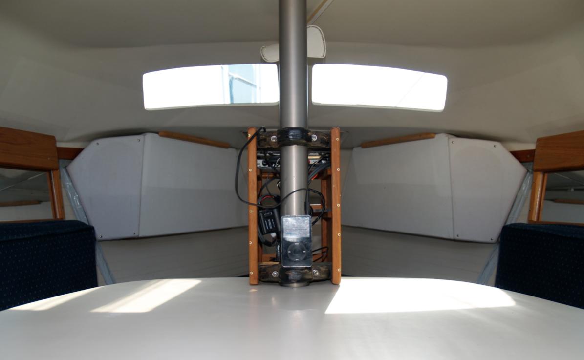

Don't know what your SPL requirements are, but I a pair of cabinets using Seas P 17 Coax with a Vifa bass assist cone in 1996. At the time had never heard of Seas or Vifa, being pretty much only into pro sound. Took it all on faith from Bob Oswood that they would work out, and they did, surpassing my expectations.
The P 17 coax went in a .4 cubic foot box tuned to 45 Hz, a port 6 square inches, 12 inch deep.
The Vifa woofer (bass assist cone), the model number which has escaped me, went in a 1 cubic foot box tuned to 37.5 HZ, a port 8 square inches, 11.2 inches deep.
These ports are rather large, the area they take up is added to the box dimensions, as is the cone/driver displacement. Fiberglass insulation was put on two sides of the interior.
The cabinets were put in the “V” berth of the boat, and to achieve the correct toe-in, the speaker baffle was angled in around 45 degrees. Since the speakers are only 6.5” (as I recall) that angle allows the cabinet to be only about 5” deep from the side wall, but because it is so thin, around 3 foot deep, tapering thinner at the back of the cabinet, which is in the forward (pointy end) of the “V” berth. I put the ports on the outside, running flush against the hull.

In the boat cabin they could do around 110 dB down to the mid 30 Hz range using a stereo 10 watt amp.
I miss that stereo more than the boat....
Art

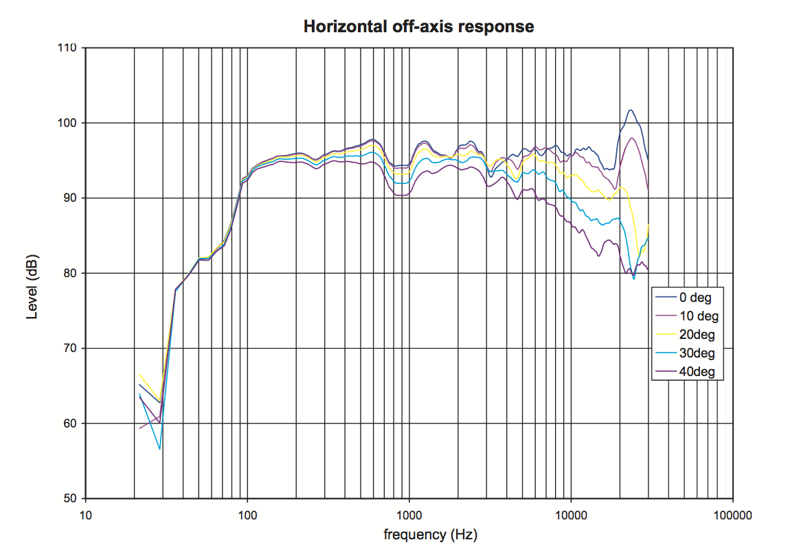

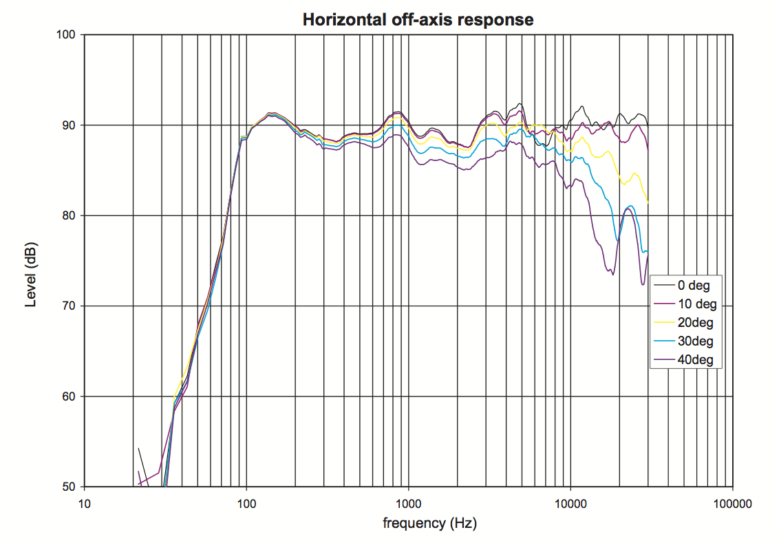

At least Tannoy's own detailed on- and off-axis FR measurements of the Definition Install series don't seem to show such a behaviour.
12" model:

8" model:
In what frequency range does your driver exhibit this behaviour? Do you have some measurements to illustrate it? That would be very helpful!
