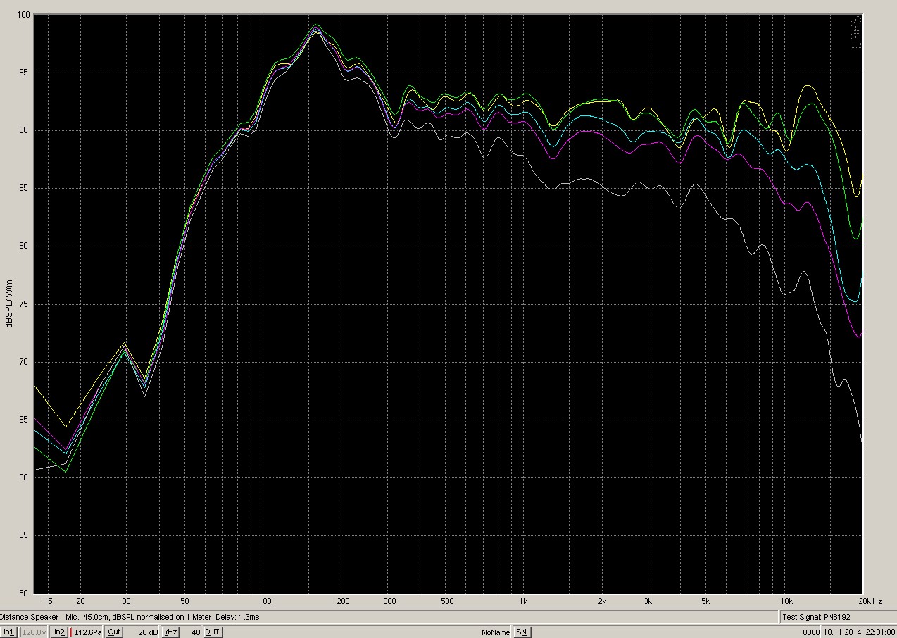

I finally got some measurements for the PHL coax mentioned in the very first post. Dieter Achenbach of Achenbach-Akustik was so kind measure his Point P25, which uses the 10" PHL X25-3491 and a 1" 18sound HD1050, crossed at 1.4 kHz.
First are frequency responses for (roughly) 0°, 15°, 30°, 45° and 60°, measured from 40cm and 1/3-octave smoothed. (Bass emphasis and disproportionally strong fall-off at 60° are probably due to the short measurement distance.)
Second is frequency response and phase at 0°, measured from 105.5 cm distance, windowed and (again) smoothed.
The response seems balanced and acceptably smooth: The dips at 1.3 and 4 kHz should be fixable via DSP since they appear under all angles; the dips around 6 and 10 kHz seem to be less easy to control, but they disappear beyond 30° and are quite high up in frequency.
The HF portion of the response seems to be quite constant in directivity up to 5-6 kHz beyond which this combo, again, starts to beam.
What do you guys think about the combo, especially when compared to the alternatives mentioned and discussed before?

The PHL charts look pretty good to me for a coax. I think it would be a solid choice.
