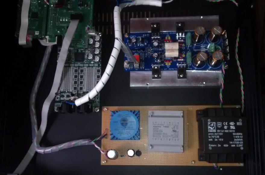

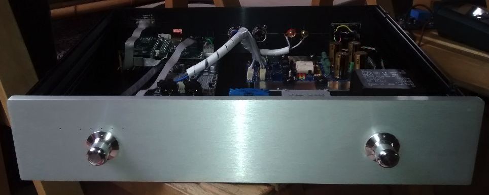

This is my DAC DAM1021 with Normundss input switch board and RaspberryPI2-B with Moode.
When Raspberry Pi is not used, no problems. But when used, and especially when accessing network drive, a lot of jitter is generated.
I think it's because noise input by ground. DAM1021 is connected to the chassis by metalic fastening screws. Input switch board and RaspberryPI2-B also are connected to chasis by metalic fastening screws.
To solve the problems I have buy nylon spacers to isolate DAM1021. But it will take 45 days from China.
I have put DCB1 board at output. But I have problems with the ground too.
To solve the noise in DCB1 board I will use the Salas power DCB1 to DAM1021 so that they share common ground to see if it disappears.

What do you mean by "mass"?
Your problems are of the type I would fear as one introduces a lot of HF switching close to delicate audio circuits by introducing a "computer". This should be avoided if one seeks the highest fidelity reproduction. Its frankly the wrong architecture if one seeks high end natural sound.

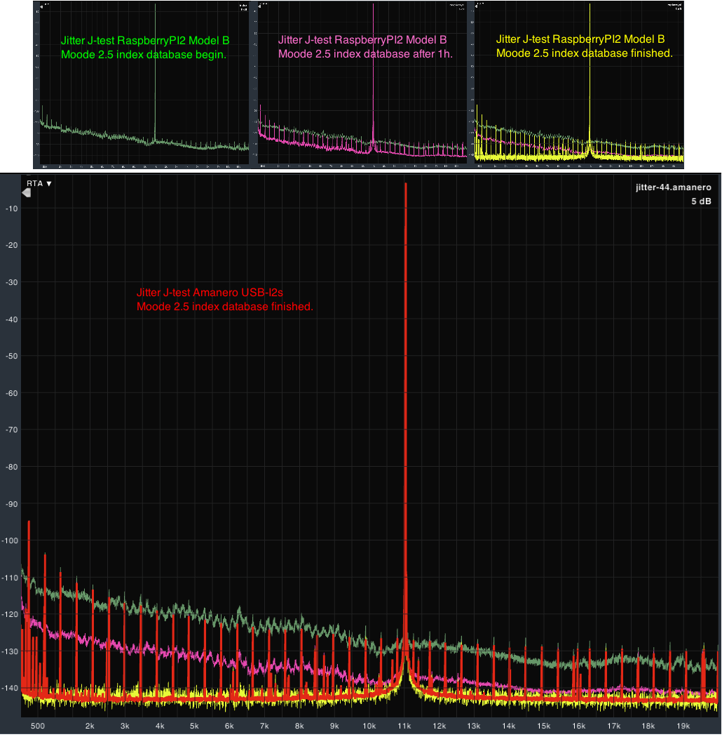

This is the jitter signal with j-test.
I2S input: Moode on Raspberry Pi and MAC with Amanero have the same jitter. While doing update MPD database is very bad, especially at the beginning of the update.
And then, when the update finished, the two have a very low jitter.
I hope it's for the wrong isolation ground. With the nylon spacers and screws I hope is resolved.

I can't read the jitter numbers or the scale in the smaller graphs.
So it's kind of impossible to compare your graphs, at least for me.
I'm also wondering how you're measuring jitter?
But my thoughts are if the jitter changes depending on what the Pi is doing, then adding nylon washers is not going to help.

Sorry for my English. Ground.
I hope that a DAM1021 chassis separation solve everything.
Not if you were able to hear the audio quality of Moode with DAM1021. When he is not doing update MPD. It is really exceptional.
In the worst case I have to wait "only" one day to complete MPD update.
Small are the same that are superimposed on the large. They have the same colors. All with the same amplitude of 11.025 kHz. I hope you look good values in the large although all the harmonics of 229 Hz are covered.
I thought that the gradual superposition of the measures would be understood.
