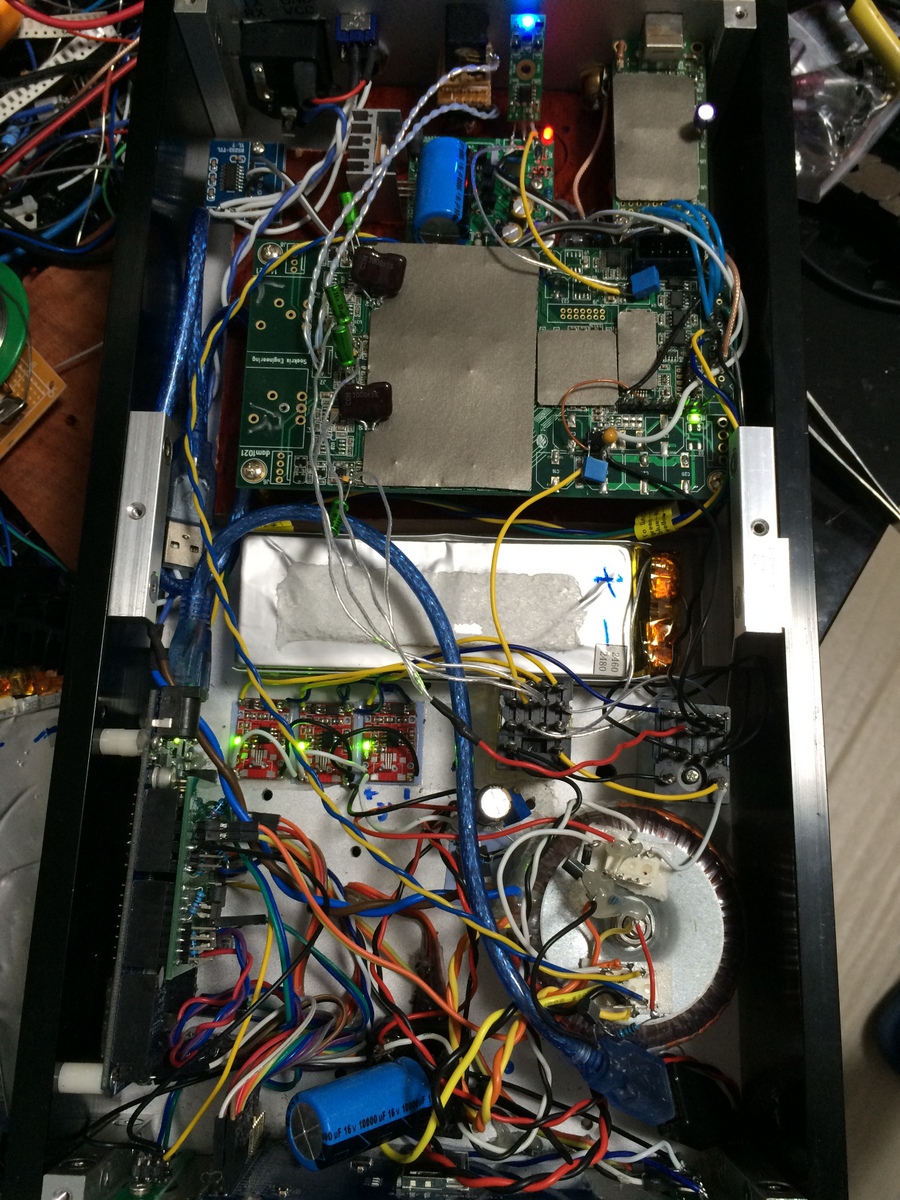

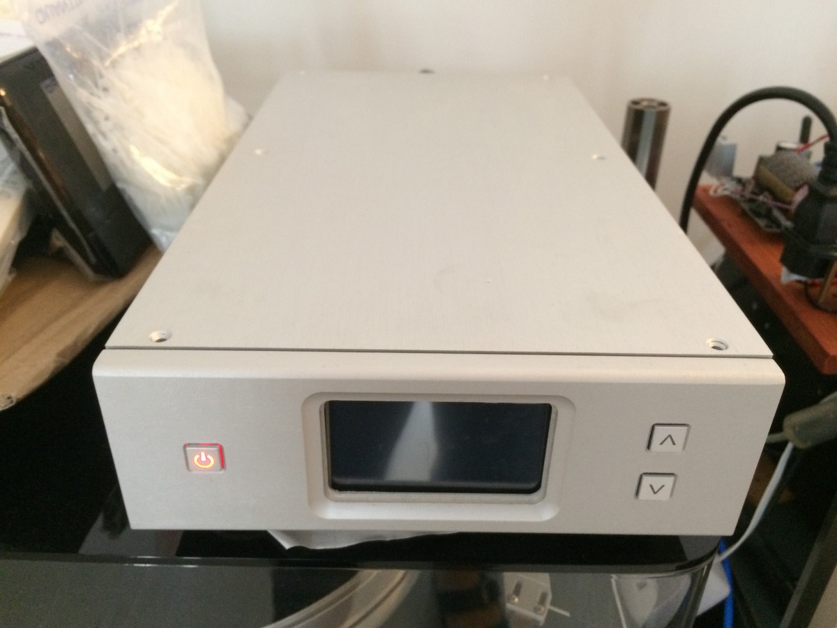

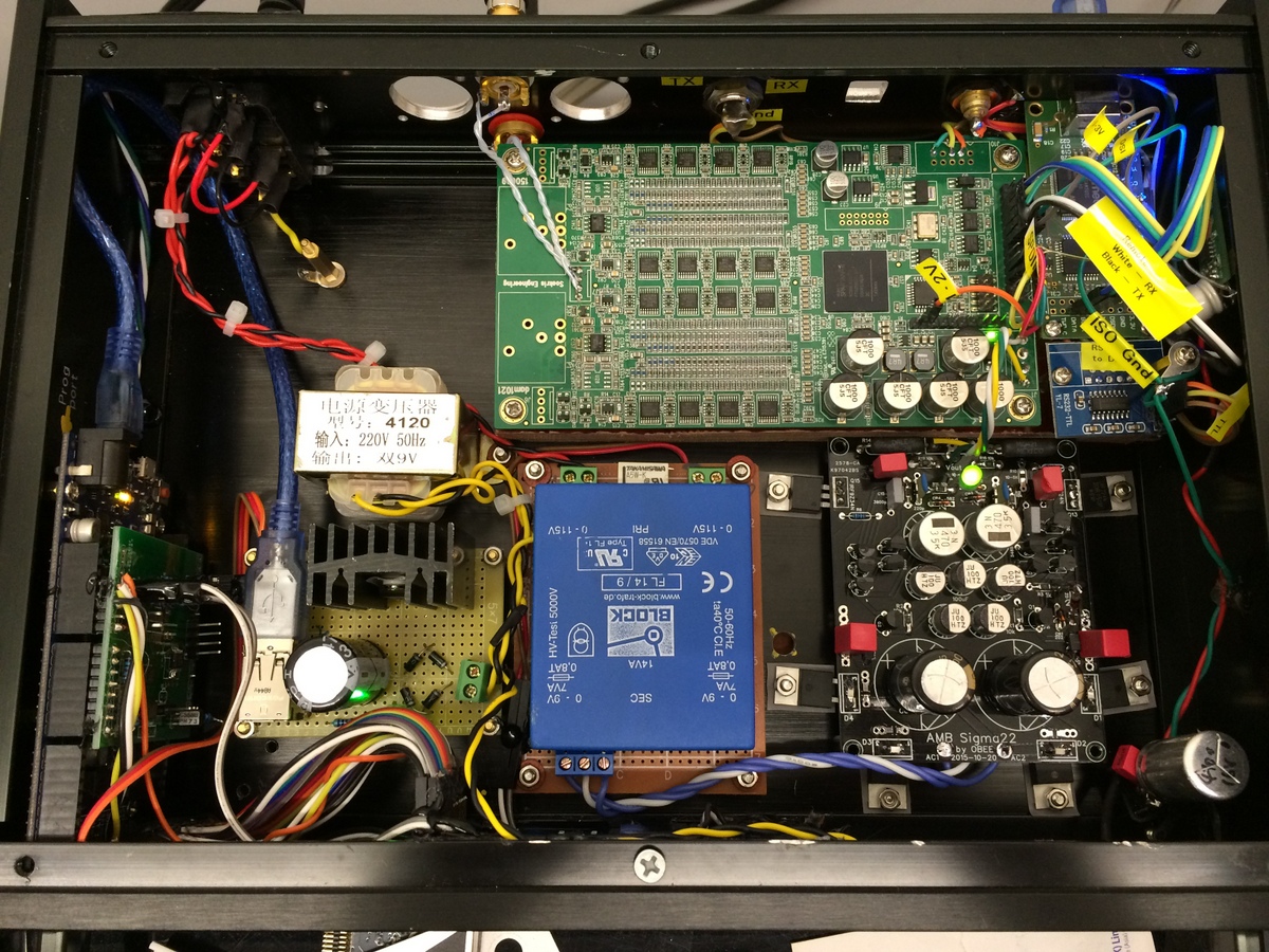

Another implementation with display module modified from dimdim's arDAM1021 project.
It's a single rev2, powered by sigma22 to AC_In P1. ISO3.3V powered by NewClassD 3.3v LDO.

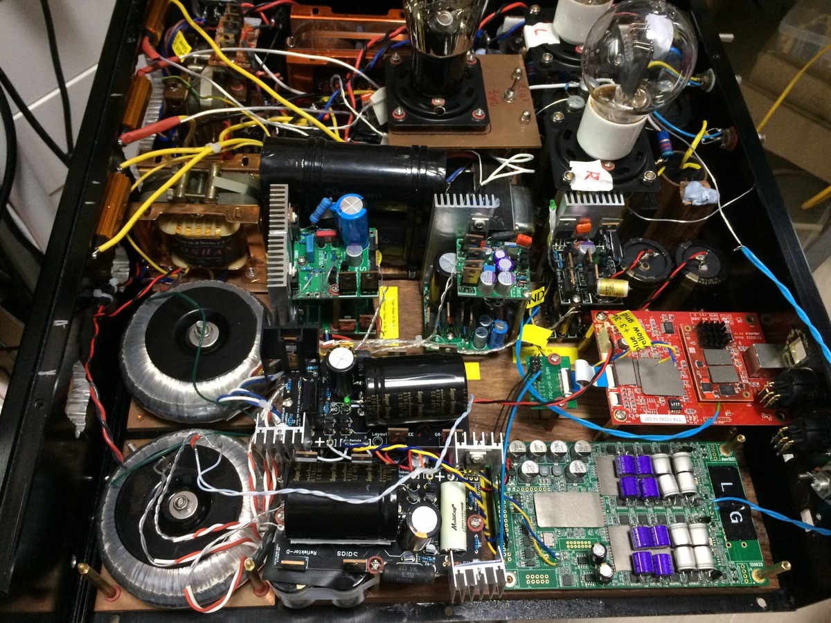

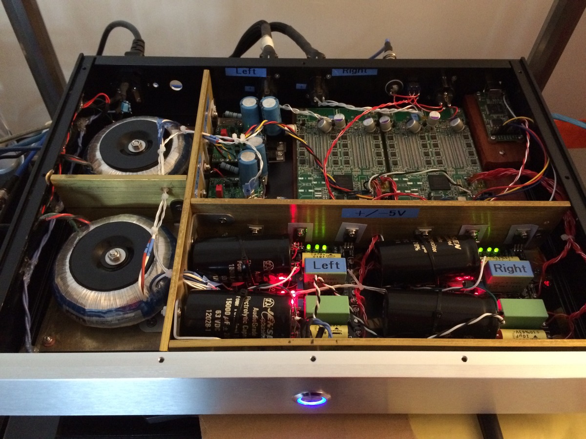

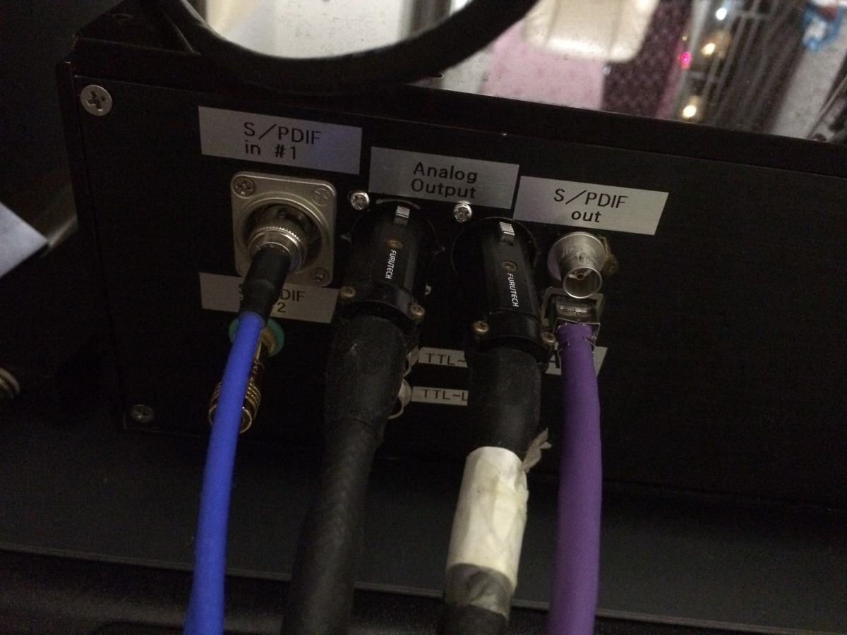

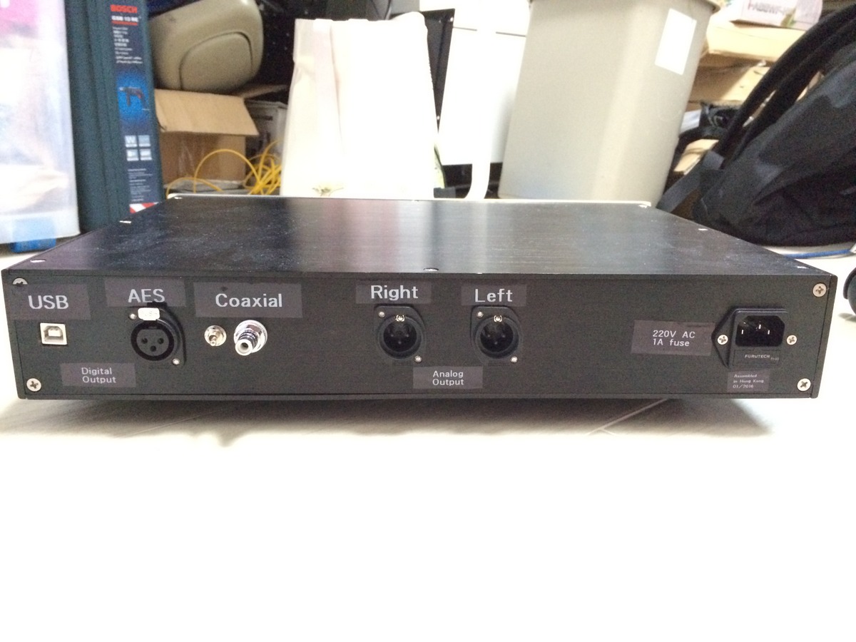

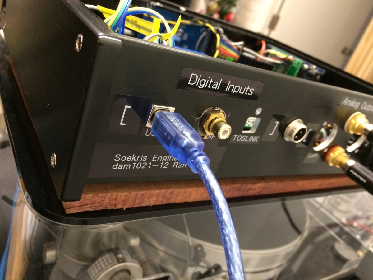

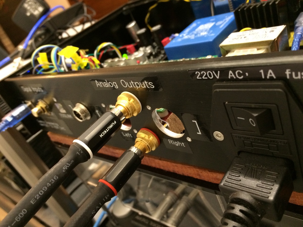

3rd implementation in dual dam1021 configuration. XLR output, no display (so it is auto detection of inputs); Dual salas bi-polar to replace the stock +/-5V LDOs; Salas Reflektor-D 3.3V+1.2V for onboard and ISO3.3V. Overkill copper walls and plates under the transformers.

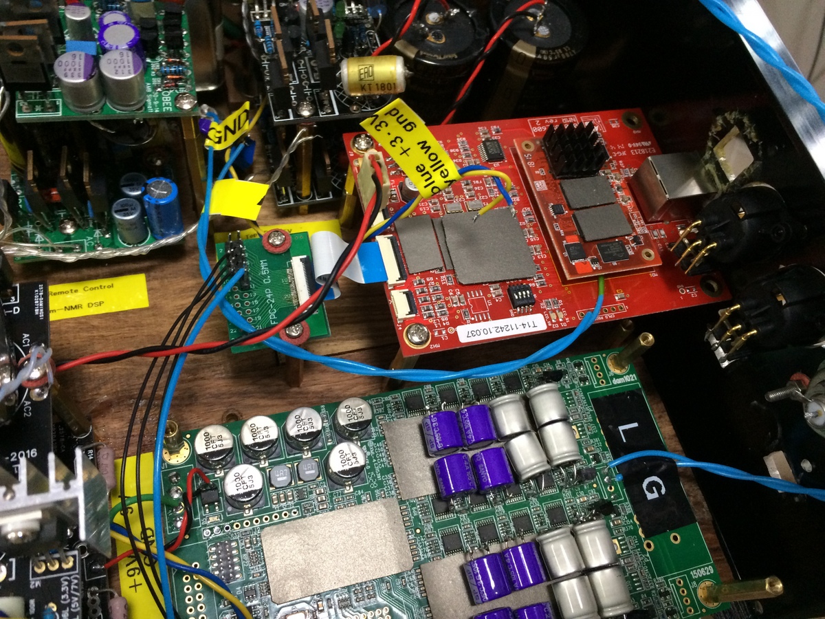

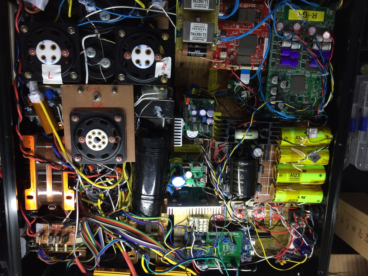

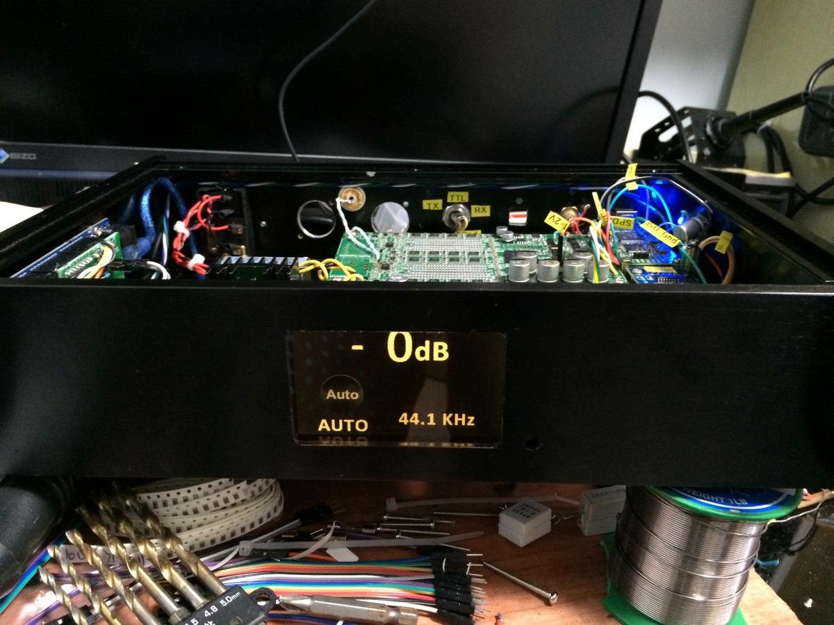

4th implementation, dual rev2; AMB sigma22 to P1 to prevent muting; Integrated with NMR (DLNA renderer so that I can push music data thru LAN to it then the dam thru I2S); With tube buffer after the RAW output. R2R shift regs are powered by A123 lifepo4 batteries.
(the cover still under construction)

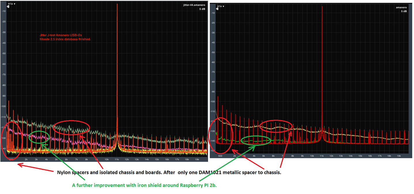

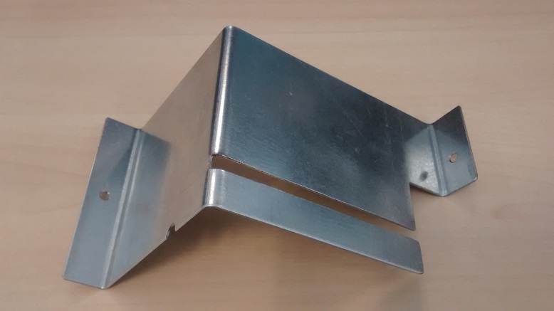

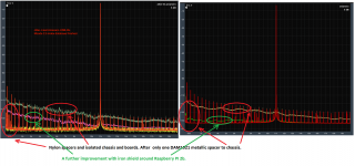

Nylon spacers to all boards. Isolated between chassis and all boards. After, only one DAM1021 metallic spacer to chassis. All power supply grounds, audio grounds outputs and audio grounds input direct to this point. DAM1021 power supply now is the Salas DCB1.
Less hum noise 100 hz, 150 hz, ... and less Amanero input J-test jitter, with Moode 2.5 data base indexing.
A further improvement with iron shield around Raspberry PI 2b.

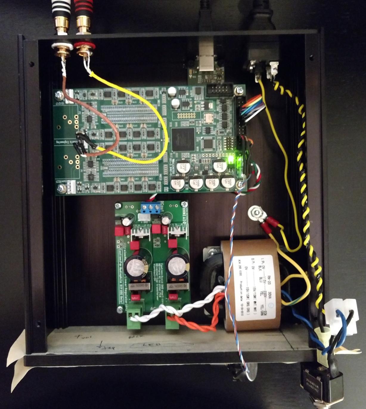

A few questions:
  • How does the layout look (see attached pic)? Notice the I2S wiring between the dam1021 and Amanero is awfully close to the IEC inlet for AC power. The live and neutral wires are twisted. The non-twisted yellow wire is chassis ground/safety earth. I don't have any problems with drop-outs, but after I screwed everything in place I started second-guessing myself. Now I think I should rotate the dam1021 board 90 degree counter-clockwise, and move the Amanero over to the left. I'd keep the transformer in basically the same spot but have to move the DC power supply board to be to the immediate right of the dam1021. Thoughts?
  • What is the voltage of the status LED header from J3? I want to know for selecting the right current-limiting resistor. (I intend to have two chassis LEDs, one simply connected to the power supply, and one connected to the dam1021 status header. I want them to be the same brightness.)
  • Anybody running their dam1021 in a chassis without ventilation? This chassis I'm using doesn't have any vent holes in it. I know vent holes can't hurt, but I'm lazy. :) That DIYINHK power supply gets a little warm to the touch (particularly the filter coils). Hard to get an idea how much worse it will be in a sealed enclosure. Thoughts?
  • Any other thoughts/comments on the build thus far?
Thanks!

Some suggestion:
1. rotate dam 90 degree, output face up (back of chassis), AC input J1 face down (front of chassis)
2. regulator place right bottom or left bottom, transformer place right under AC IEC
3. no need ventilation, the regulator might be hotter than the dam in fact, esp if you are running shunt regulator. However, your case seems not shunt reg so it's ok for zero ventilation IMO.
