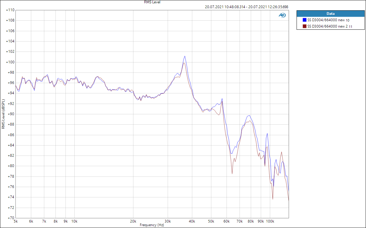

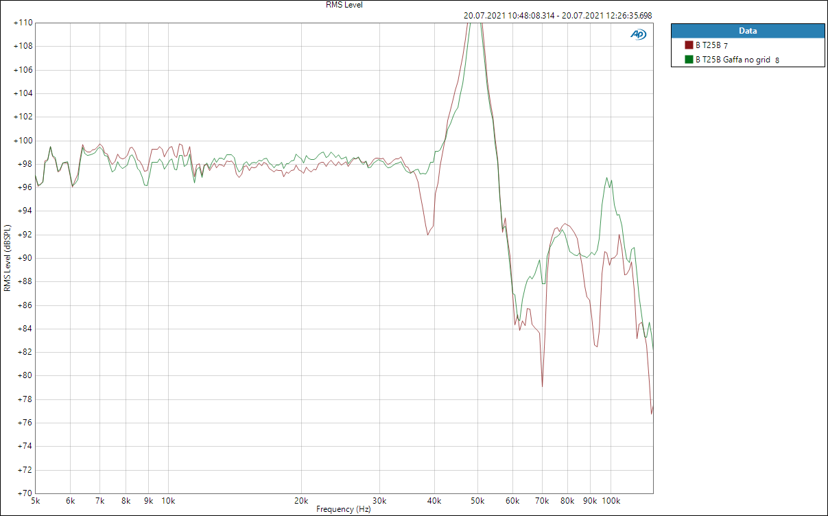

I found a few measurements from tweeters at very high frequencies - maybe it's interesting for someone. They are done wit a 1/4" free field microphone in an anechoic chamber on a small test baffle. 2,83V at 0,5m. Don't remember the power amp but it's very likely it is already down a few dB at 100kHz - no compensation for that.
First my reference and favourite - Bliesma B25T. This membrane is incredible.

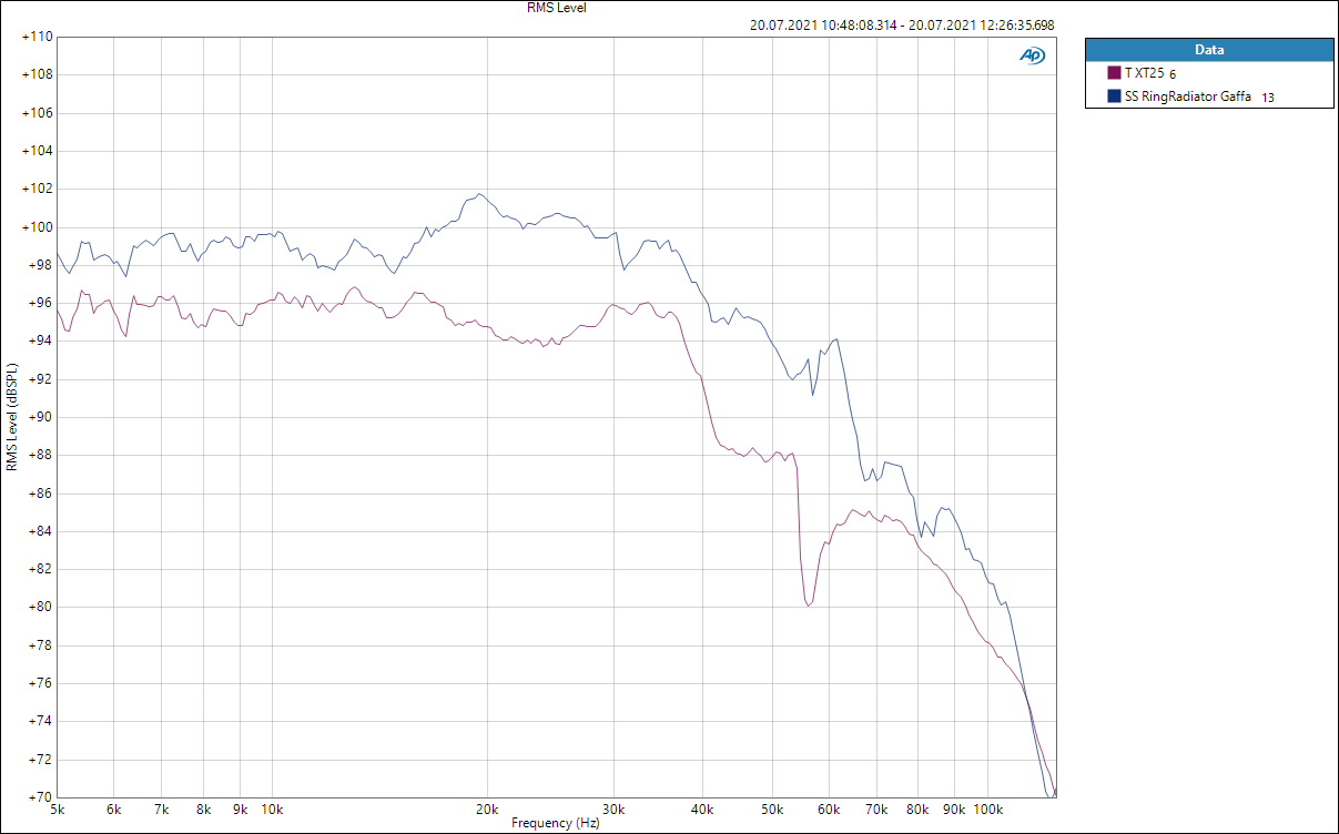

Next some ring radiators which behave very nicely at high frequencies.
And 2 Beryllium ScanSpeak tweeters to check if there are big differences of the resonances - seems pretty stable.
I build measurement speakers with pretty crazy specs and therefore I need to know what's going on up there. When listening to Spotify it's probably less important ... ;-)
