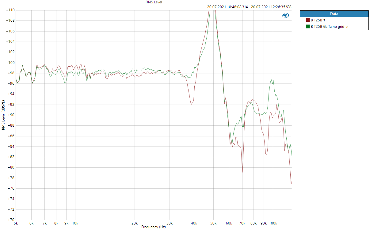

Does one just ignore this spike when filtering?Bliesma T25B. This membrane is incredible.

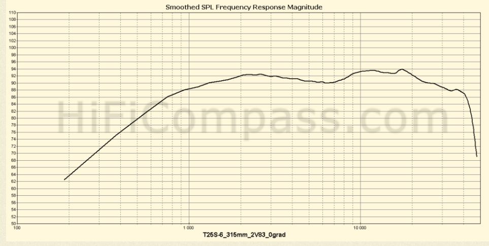

In comparison to the otherwise ruler flat T25B, what's up with the broad valley and rising response of the T25S?
Is this better used with steeper slopes?
You mean the spike at 50kHz? Hard to hear ;-)Does one just ignore this spike when filtering?
The T25S membrane does not behave like a piston - you see this in the frequency response, esp. off axis.
Bliesma soft membranes are made for a typical sound and use thin/light material to get this.

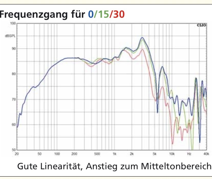

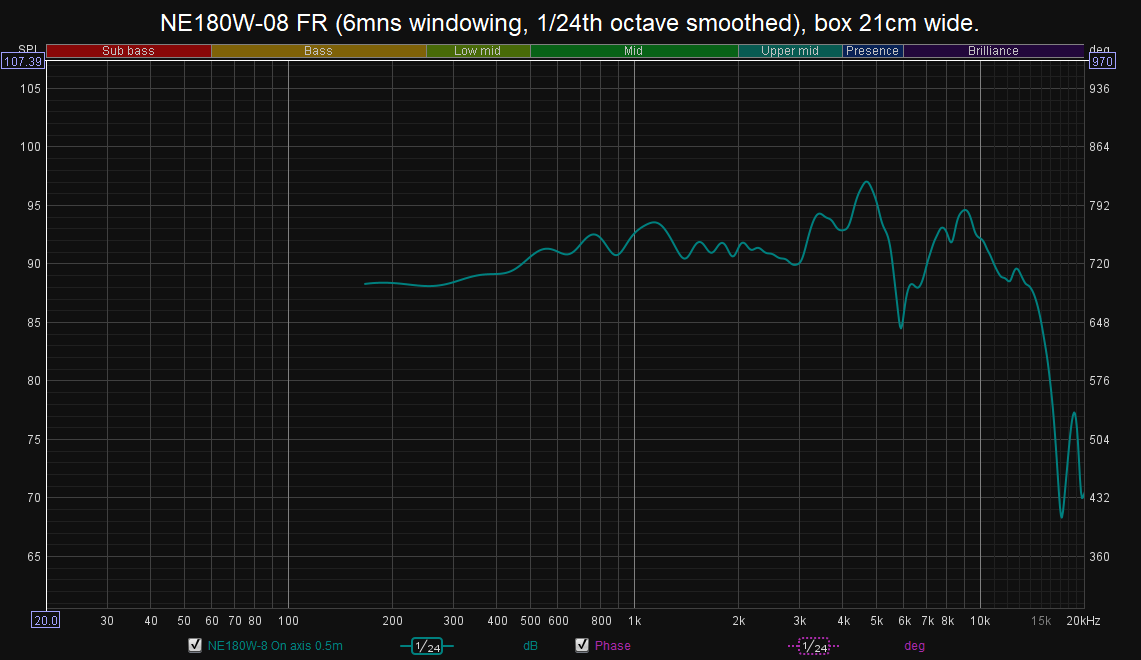

I have measured the NE180W and although it is a good value unit; the breakups means you need to throw more parts at it for a flat smooth response, with a passive crossover. IMHO probably why it was never a big hit. Oh and soon it is unobtainable.
I feel the modern version of the classic paper unit from SS is better (and available) ie. 18W/8542-10
