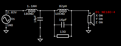

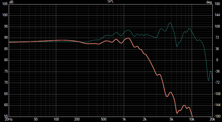

I'm building a pair of nearfield MTMs with NE180s and a WGed Seas T35C002 for my son's home studio setup. I'll be sharing the build when I'm done with the enclosures. Xover should be around 2100 hz 3rd order. There is a minor resonance around 4.5k on the NE180s which should be notched out, otherwise it falls a little under 25dB and can be noticed with piano and female vocal tracks. Most people wouldn't notice, but I can hear it now that I'm more aware of it. This 4.5k 5dB peak is really the only bad quirk on the NE180, but minor considering the price and performance. What a shame they dropped it from the diy market.

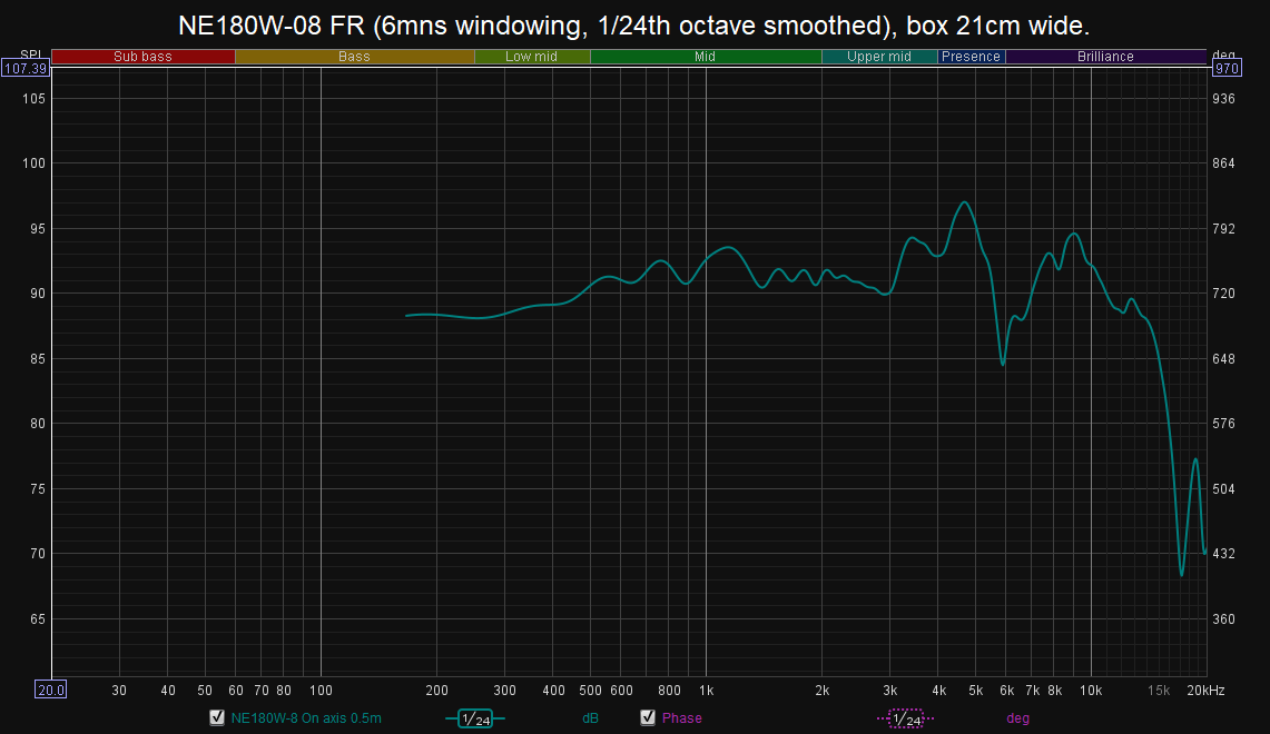

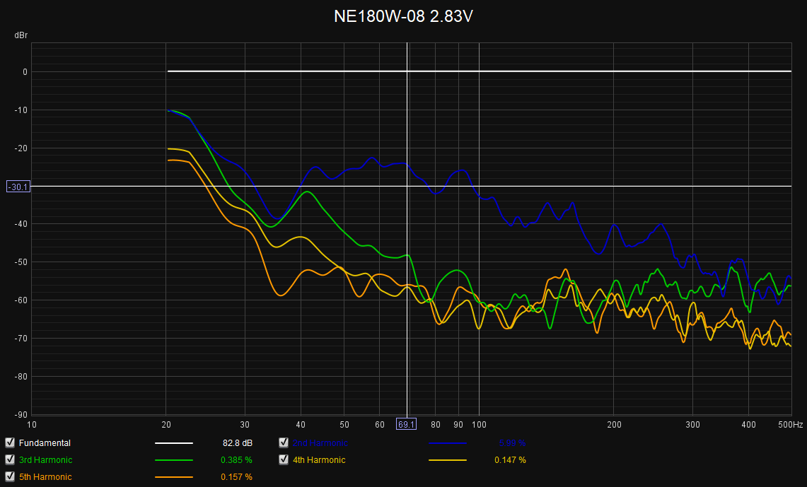

I’m not as enthusiastic about the NE180W-08

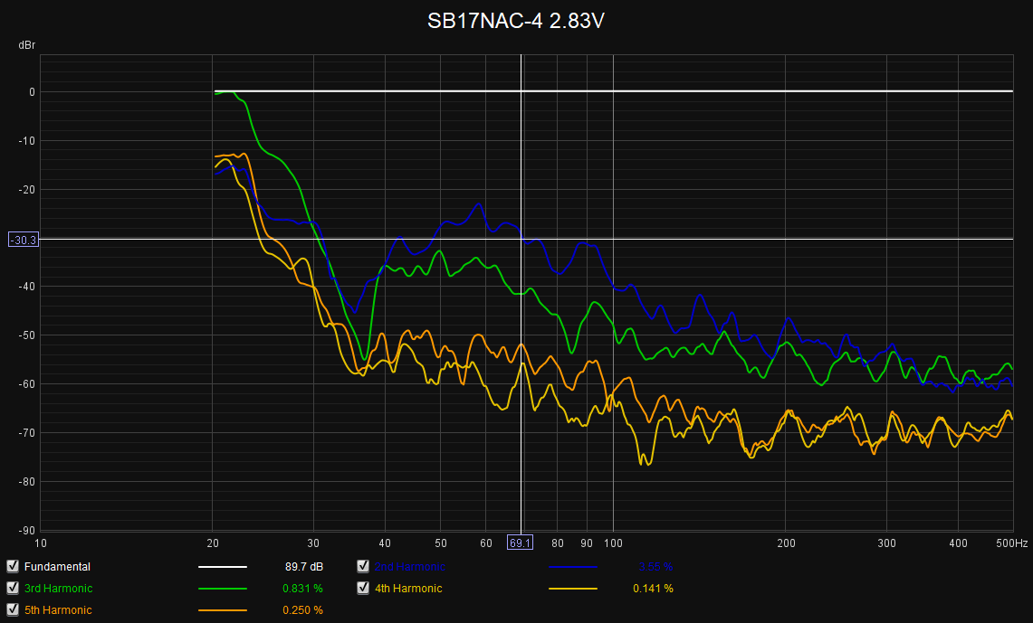

I investigated this driver as a potential candidate to turn into a coaxial due to the 40mm VC. Buoyed by @TMM ‘s measurements, I purchased a single unit. My build date was fairly recent; but it measured more like Zaph and @HiFiCompass ’s samples- not as smooth as Tim's measurements. It would be a challenge to flatten the FR without DSP. The bass is certainly better than the SB17 though.
Both measured in same box (0.7 cu ft sealed with baffle 17" H x 8 1/4" W, and same conditions (50cm, 6ms window). These are not anechoic quality measurements, but gave me enough data to not move forward with it.
All in all, measurements more similar to Yevgeniy's than Tim's.

One will probably manage to "flatten" the FR wiggles around 1k, by damping agent on the rubber surround. Just as so many of the common rubber surround midwoofers, with untreated surrounds.
