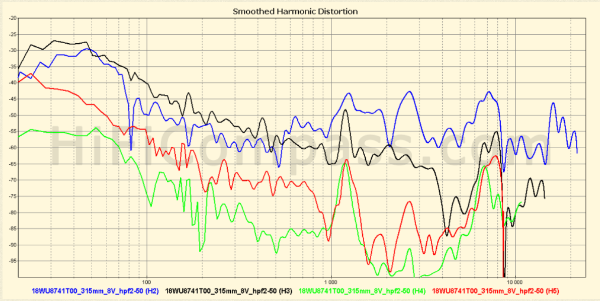

In the measurements of Hobby Hifi, this is a bit more clear (because of the relative/percentage scale)
It seems to be mostly 2nd order distortion from their measurements.
But a brought H3 across 100Hz - 900hz.
I stand to be corrected, apparently, there are some different measurements results.
See:
http://website.audiocomponents.nl/download/scan-speak/18WU-8741T00 - Hobby HiFi 2012-2.pdf
A SB Acoustics NBAC performs better there. (even compared to the 8ohm version)
When it comes down to 100Hz-2kHz.
The 4 ohm version really has some weird things going on?
http://website.audiocomponents.nl/download/scan-speak/18WU-4747T00 - Hobby HiFi 2010-4.pdf
Left is SB NBAC, right is SS 18WU both @ 90dB

Yes of course. Very transparent speaker with high resolution and pleasant timbre but quite different from Revelator series.HifiCompass: Thank you... did you have an opportunity to also listen these 18WU?
You can check my thread about IMD vs HD. I guess the story is similar for SB17 and 18WU.In the measurements of Hobby Hifi, this is a bit more clear (because of the relative/percentage scale)

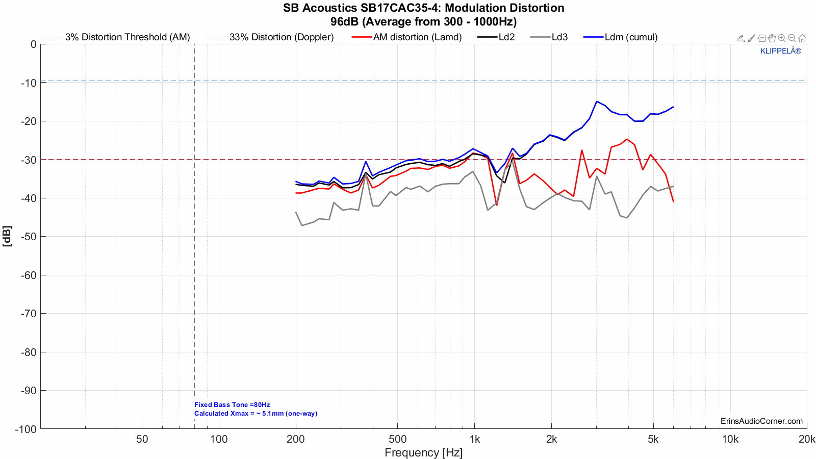

8V corresponds to 94dB, so it would be more correct to compare distortion plots at 5.6VIn the measurements of Hobby Hifi, this is a bit more clear (because of the relative/percentage scale)

I am aware, I was talking about relative differences.8V corresponds to 94dB, so it would be more correct to compare distortion plots at 5.6V

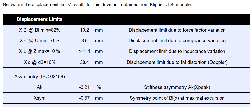

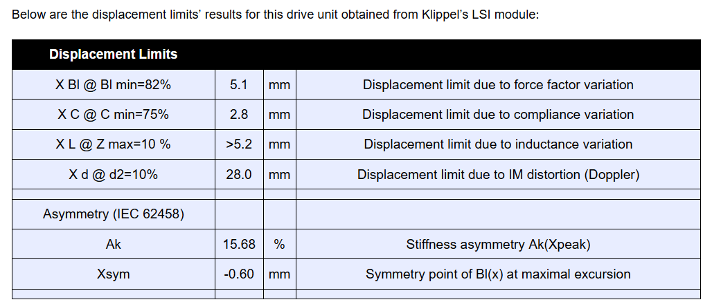

Here are the Klippel measurements from VoiceCoil Testbench;
https://www.scan-speak.dk/datasheet/reviews/15WU-4741T00_18WU-4741T00-VoiceCoil_2009-2.pdf
Also with the smaller 5 inch version.
As well as Erin's measurements;
https://www.erinsaudiocorner.com/driveunits/scanspeak18wu4741t00/
Both 4 ohm version.
Looking at the BL(x), Kms(x) and Le(x), it's pretty obvious the gain you will get when being used full range (aka below 100Hz).
Why the IMD is so much better (when being used full range!)

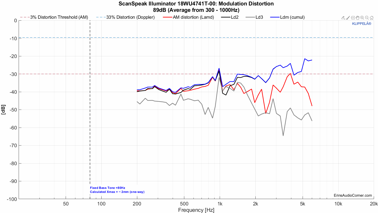

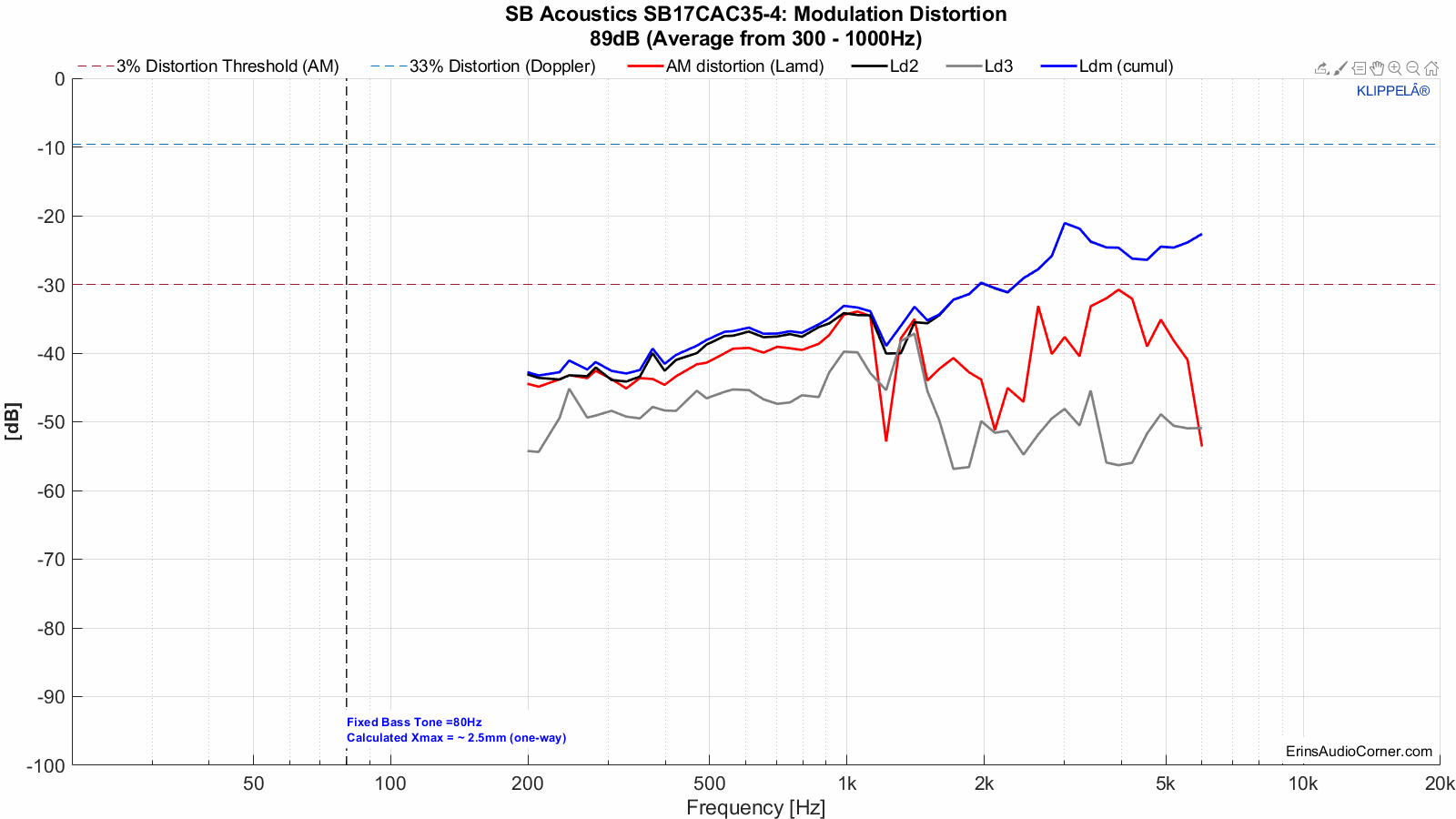

And when we look at IMD from 80Hz (not lower frequency or Fs), the picture looks all of a sudden very differently!!
Both at 89dB
source:
https://www.erinsaudiocorner.com/driveunits/sbacoustics_sb17cac35-4/
(I extracted the gif image)
Both at 89dB
source:
