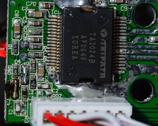

Hey! I thought you were supposed to bridge C3 and C4? Have I misunderstood something?Lostcause said:
That's the cookie ringed in green.....
My board looks like this now:
Hi Ree, that post was discussing the BIAS cap NOT the INPUT caps.
Your board looks good, nice bridging.
TTFN
TTFN

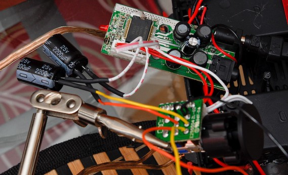

Anyway, I used a couple of 2200uF 25V electrolytic caps for the stealth mod. The music cracks and pops a great deal just after i turn the amp on, but after 15 seconds or so it sounds good. Is this normal? Could it be bad caps or something?
I used kind of weak unshielded internal cables, is this a problem somehow?
I've tried to get a grip around this C10 business.. What do I gain from replacing it? And could I use another 2200uF 25V for that? I also have 1000uF's of the same kind..
I'll post some more pics from my modding..

Wooooooah!!! Dude! NO!
Don't use those caps for the stealth mod on the input mate
![bigeyes :bigeyes: :bigeyes:](https://files.diyaudio.com/forums/images/smilies/bigeyes.gif)
![hot :hot: :hot:](https://files.diyaudio.com/forums/images/smilies/hot.gif)
You only need 1 uf to 2.2 uf for the inputs
The 2200uf are for C10 replacement
![attention :att'n: :att'n:](https://files.diyaudio.com/forums/images/smilies/attention.gif)
And yes... the replacement of C10 is probably the best mod you can do to improve higher volume base response.
You need to recap more of this thread before you go any further.
Good luck
Lee
Haha, thanks for your reply Lostcause (who's the lost cause now
Yeah I actually realised my mistake shortly after my last post. I confused 2,2uF with 2200uF thinking people was talking about the same thing. I've gone through this thread a lot lately. Perhaps too many times, as I've seem to become blind to the numbers..
Luckily nothing seems to have been damaged!
Wierd thing that it worked fine after a short while though..
I'm gonna try and sort this out tomorrow..

Ree said:Ok, I got it all sorted out with 250V 2,2uF films and a new 16V 1000uF (sanyo) for C10. Sounds much better now
But i've got this humm now, probably from my weak unshielded cables.. I'm not sure what wires to use. Suggestions?
