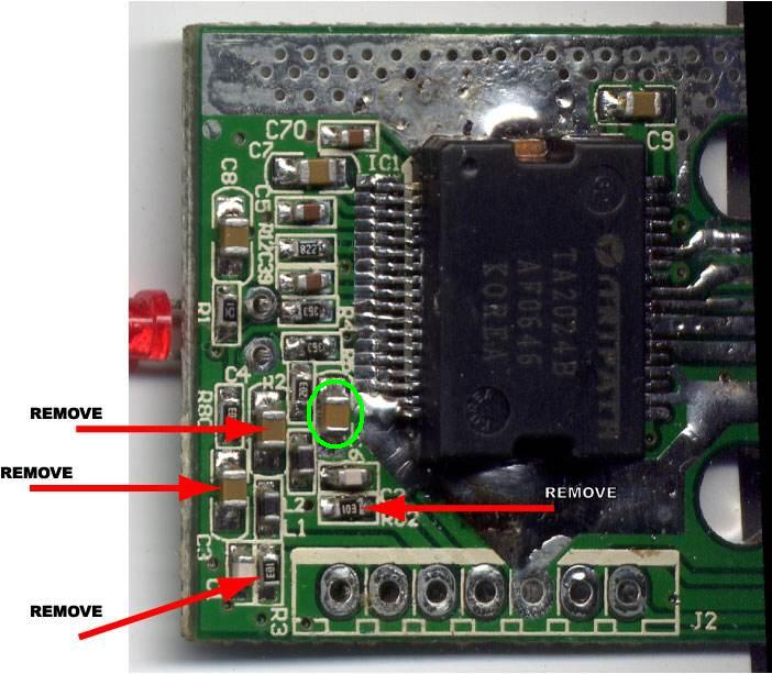

That's the cookie ringed in green.....

Bringing up kind of an old post but I decided to start to mildly mod my SI T-Amp following this picture:
http://www.diyaudio.com/forums/attachment.php?s=&postid=783363&stamp=1133905808
My question is if i primarily use this amp with my ipod will I need a volume control? Can just just wire C4/C3 to the 2.2uf caps straight to the RCAs? I also noticed that in that picture it lists the resistors in between the caps and the RCAs as optional...what benefit will i get from installing new resistors?
