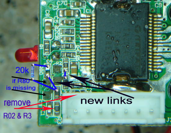

Re: mistake?
gychang said:
I have rev D, just took off C3, C4, did I take off too much?, no place to solder the new caps to (actually wire).
Can this be salvaged?
gychang
It looks as if you may have removed R80 as well 😱 You will have to tread carefully now and make sure you don't lift anything else.:bawling: Still salvageable at the moment.
Re: Re: mistake?
I have found the R80 and replaced it. Not sure how to connect or trace the C3, C4 though... there is no solder trace on the back of the PCB on the latest version of T-amp.
gychang
Hope this picture makes sense, be careful and good luck..
audio1st, thanks very much.
1. I will replace R80.
2. removing R02, R3, what effect will it have? My main purpose was to improve bass by replacing C3,4. (I am not too good at desoldering...)
3. I can do the links as you suggest.
How can I connect my new C3,4?
Your suggestions are very helpful, and I will resurrect this if possible.

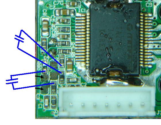

gychang, you are best using the stealth modification when replacing the caps, this is why Audio1st mentions the removal of R02/3.
If you are only replacing the caps and placing them in exactly the same position in the circuit then you just need to use the new connection points shown in Audio1st's picture.
Rough and ready picture........
Lostcause:
thanks very much. If I follow your suggestion. I will end up.
replacing input caps (I have the proper part), without further surgery.?At this point, I want simple solution. I think I soldered the R80 correctly. (I unsoldered it by mistake)

gychang said:
Lostcause:
gychang
If you just want to replace the caps then yes, use wire-wrap wire or something similarily thin and flexible to connect your new caps to the board as shown.
Don't try and use too thick a wire or you will end up pulling off more components and traces......
Good luck....
Good luck....
thanks so much. will tackle this soon. I have some thin wires.
gychang
