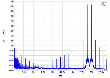

Keeping on measurements vs sound , i would like to hear comments regarding the two graphs below, causes, good/bad, expected sonic signature ...?
Graph 1 : spectrum of 50Hz sinewave, DC–10kHz, at 201W into 8 ohms (linear frequency scale).
Graph 2: HF intermodulation spectrum, DC–24kHz, 19+20kHz at 401W peak into 4 ohms (linear frequency scale).

As for the graphs, I am unsure they show anything particulary relevant to sound quality.
I have heard amp's that had better measured performance than that in these test that sounded very bad and I have heard amp's that had worse measured performance in these tests and sounded rather good.
Ciao T

Hello T,
This is what i'm trying to get a grasp on, what is good, what is bad , what is absolute ..? I mean the soulution amplifiers measured immensily low ..... sonics..?
