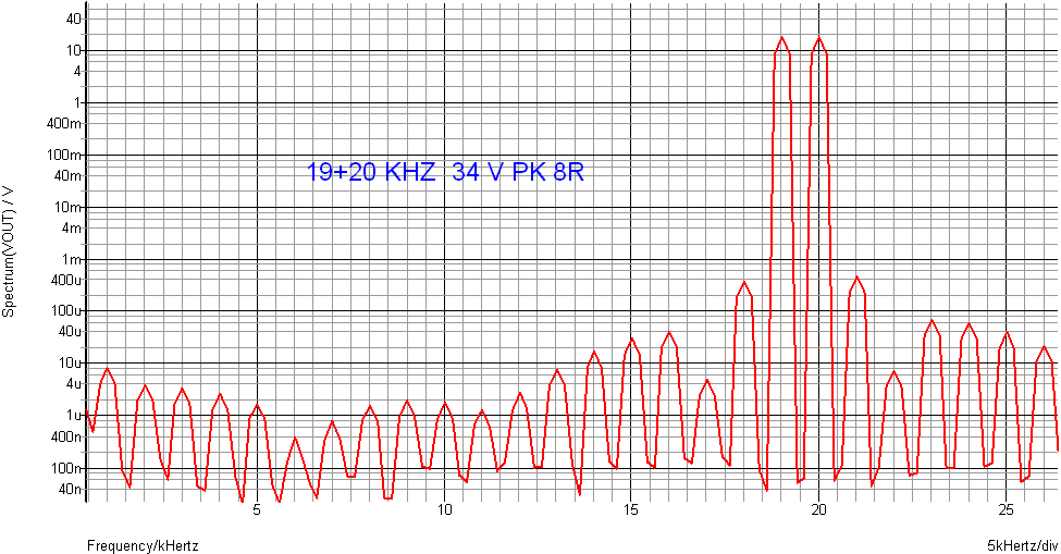

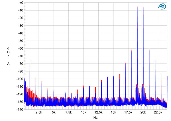

Show me graphs of the same amp, but for 150W on 8 Ohm, and 300W on 4 Ohm. Also, for 1 and 10 W, so I may suggest you something useful.
Those previous graphs are of the same amp , this one is of another ....difficult to get exactly what you ask ...

a.wayne, there is NOT enough info to tell anything about the actual distortion at 1W. This is a critical flaw in this measurement combination. We are not fooling! Look at the THD curve with power. How much is distortion and how much is noise? That would depend on how hot the amp ran into Class A. Do you know?

I will check john......I guess JA uses best case when testing , to avoid the obvious ....
I generally run the amplifier into visible waveform clipping on a 'scope with the mix of 19 and 20kHz tones, then back off the level by about 3dB.
Edit: Meant to add that this is done with care at the end of the testing, as with inexpensive amplifiers this can sometimes let loose the magic blue smoke. :)
John Atkinson
Editor, Stereophile
JA just measured it, incompletely. He did not do anything wrong. However, he did NOT show the distortion at the transition between Class A and Class AB which is usually worst case until you get near that absolute peak output of the amp. The higher order distortion is AWFUL in the Plinius and probably pretty bad in the Soul--- amp. Look at the idle current, which you can derive from the idle power, then measure at the transition, especially at 4 ohms. That is what I do.
John Atkinson
Editor, Stereophile

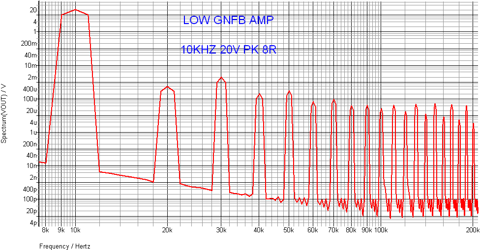

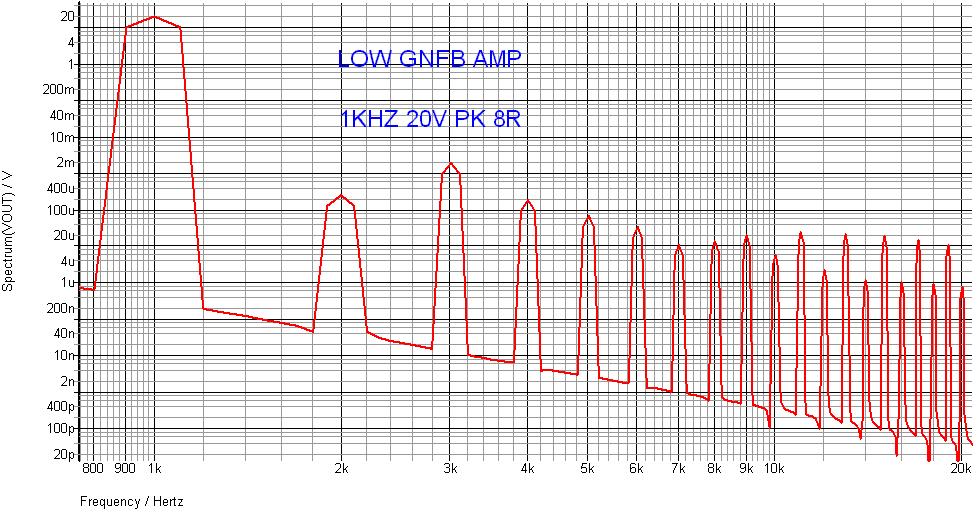

Whatever the topology the trend will be the same.
High feedback designs will see increasing THD and IMD with increasing
output level and frequency while some low feedback designs will see
only a slight increase of THD and IMD with rising power but less with rising frequency, not that they are better but they simply start with way higher distorsions at low frequencies and then see a more or less constant( but high in magnitude ) distorsion with frequency, as in the exemple below.
