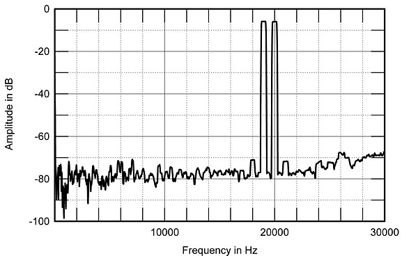

From the tables even at huge SPL the thirds are small. For a weakly non-linear system the seconds would go down at twice the rate (-20dB fundamental, -40dB 2nds). So it looks like .01% at low levels is possible. They infer the distortion from a two tone test, using two speakers and care in keeping the IM only from the mic. I have seen this used in the industry, and it makes intuitive sense that the mic can't be greater than the residual unless there is some strange cancellation. OTOH their result for the high frequencies being worse is counter intuitive since the displacements have dropped? This is out of my expertise at this point.
IM test signal (19k + 20k).
With an horizontal linear scale that start at 10KHZ...
Seems that they didnt understand that the main interest was to
see byproducts at 1KHZ...
Anyway , that was enough of a numbered exemple for Thorsten...
Err. OK, but why the sudden rise at 20K ...what is this telling us ?
Need glasses? The linear scale starts at 0Hz...
Seems they use the kind of measurements common at the time (over 20 years ago) and the 1KHz product would show up.
If you do not like the way others measure, why don't show some actual measurements of your own (not that they actually per se matter BTW)?

The "sudden rise at 20KHz" IS the signal.
The signal in this test uses equal levels of 19KHz and 20KHz signals, giving a second order product at 1KHz which is easy to quantify and loads of higher order rubbish that is a bit harder to account for.
BTW, "intermodulation distortion" implies two signals to intermodulate across a non-linear system, you cannot measure IMD with a single frequency signal.

What graph are you looking at? The one posted by Thorsten shows DC=>30KHz.With an horizontal linear scale that start at 10KHZ...
