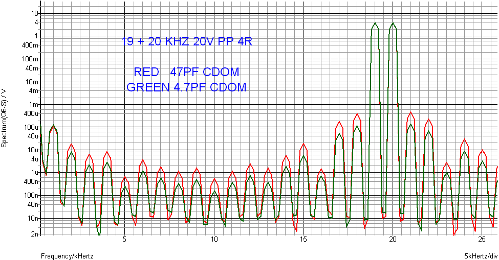

Why do we need to have any 1kHz? That is second-order. The 18 and 21kHz are third-order. You can have one without the other. The apparent absence of 1kHz second-order IMD says precisely nothing about the presence of third-order IMD at 18 and 21kHz.wahab said:To assert the presence of 1KHZ residual there should be peaks
comparable to the 18 and 21KHZ ones , that is the peaks have two clear bars
with a minimum of width between them.
If there were any 1kHz, it would be a single peak - not two peaks with a gap between.
This is a linear scale so a peak at 1KHZ if there was one should
appear in the graph with the same shape as the mentionned third
order products.

And it is there, compressed in width due to the use of linear scale.
So, please note:
1) There is a 1KHz at around -70dB (~0.03%) in the Plot
2) If 2nd hd was very much lower it would not show up at all
Ciao T

First, my name is Thorsten. It is actually quite clear.
Second, there is a peak at 1KHz. It is above the noisefloor.
On what basis do you claim that the 3rd order products "are high for a so called high end amplifier".
Can you present evidence that suggests audible problems being introduced by around 0.03% 3rd HD/IMD at 7V output (that would be a peak SPL of around 92dB in room for a stereop pair of "average" Speakers per JA's research).
And do you have evidence for Loudspeakers that have less than 0.03% 3rd HD or 3rd order IMD when having 7V RMS applied?
Ciao T

The 1KHZ peak is quite non significative , i think you ll be agree
on this point.
As for the 0.03% ratio i agree that it s surely below audibility
but since IMD is nastier than THD and that current technology
allow for a magnitude better numbers , why not ?...
High distorsion of speakers should not be an incentive
to neglect amplifiers parameters that seems to largely
surpass the speaker s possibilities.

I agree the 1KHz peak measured for the Goldmund Mimesis 8 Amplifier is low in level, but it is at the level I would expect from the THD Measurements.
But why? I fail to see any merit to doing so.
Sure, we can make it better than this, but what do we expect to gain for making it better? And what price do we need to pay to attain such an improvement?
As for IMD being nastier, IMD is simply a different angle on HD, if the underlying non linearity is simple and consistent. If the non-linearity causing the HD and IMD is inaudible then it is inaudible, no matter if you measure HD or IMD.
But what is the benefit?
The Speaker will limit the system performance, an amplifier with much lower 3rd HD than the speakers will not benefit the system.

This one :
Goldmund Mimesis 8 power amplifier Measurements | Stereophile.com
When you did display their IMD measurement i was surprised
by the difference with simulations , but i had a doubt about
the sample that was sent to stereophile so i made some sims
and approached accurately the measurement results by increasing
the two 4.7pF Cdom to 47pF.

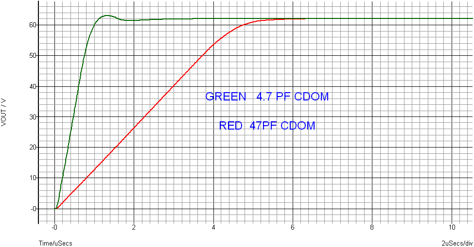

Then reading stereophile review of the Mimesis , i noticed this sentence :
the risetime, judging from the 10kHz squarewave shown in fig.7, was significantly higher than expected at 4.4µs vs 0.7µs.
Well , Goldmund did send a sample that was way more compensated,
surely to tame down the worst thing that can be said of an amplifier
in a review ,far ahead of other parameters as THD/IMD/DF ect
, i.e, instability...
Below are the sims of IMD and rise time of the Mimesis 8.
We clearly see that the rise time given in the review correlate
with the increased compensation....
