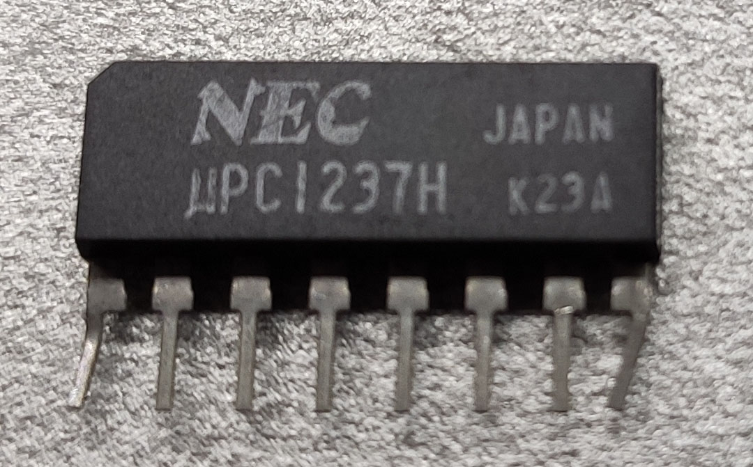

Here's a picture of the uPC1237 I got form St Quentin Radio in Paris.
Seems legit.
Jacques, looks good - you just have to try it!

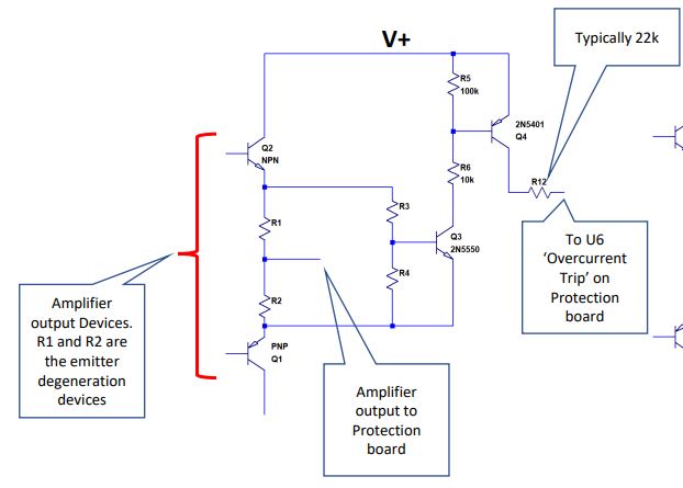

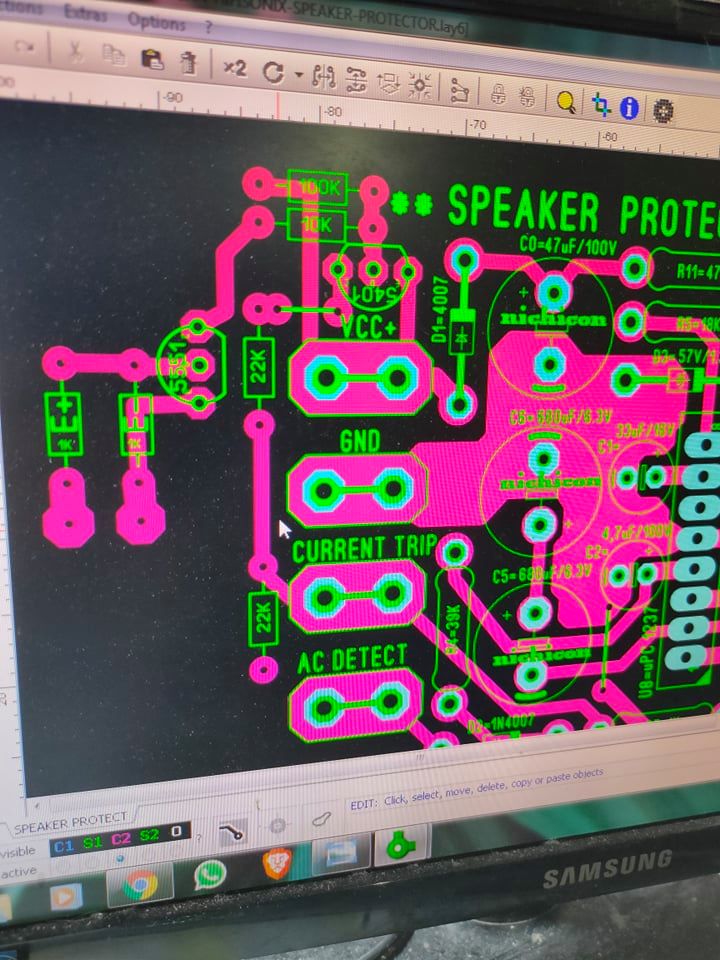

Hello Bonzai
greetings just want to ask you in the schematic posted where
on pcb will Amplifier output to protection go .This is for one ch
have to build same circuit for second ch will both 22k resistors
go to U6 input .
warm regards
Andrew

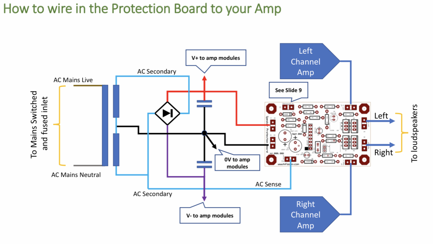

Andrew, for the current trip input, the ‘trip’ signals must be wire-OR’d.
The example circuits Inshowed do this. If any one of the two trip inputs pulls high, it will shut the output down.
The max current you can allow to flow into the trip pin is 3mA, so adjust the series resistors (I showed 22 k) for something below this. 1-2 mA will be fine.
For overall hook-up, it’s per the diagram in the presentation here:-
