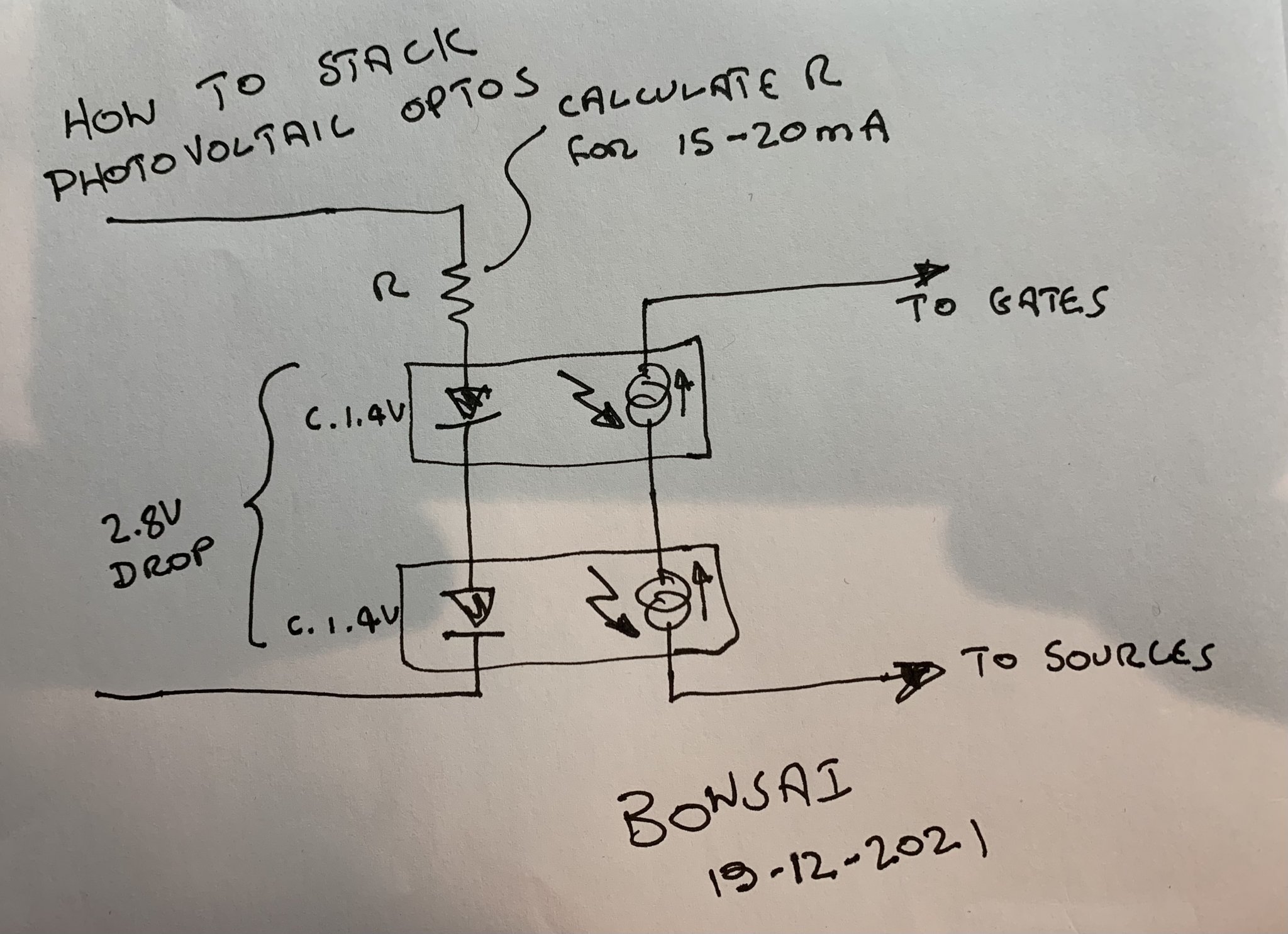

Thank you for providing this information! Because I neglected to read the data sheet for the optocoupler I was unaware that it provides isolated gate voltage supplies to the MOSFETs.The optocoupler is photovoltaic so no gate voltage source is needed. The FETs have reverse body diodes but they have milli-Ohm on resistance so it is unlikely the drop across them will reach the diode forward voltage.

Yes, but you will need to feed each opto LED with a separate resistor - ie don't just stack the optos on top of each other as one of the LED's may hog all the current. The other method is to put them in series - this is what I've done in Model 1721 and it switches c. 60A in <100us.
Thanks bonsai,can you post the circuit with two opto in series?Yes, but you will need to feed each opto LED with a separate resistor - ie don't just stack the optos on top of each other as one of the LED's may hog all the current. The other method is to put them in series - this is what I've done in Model 1721 and it switches c. 60A in <100us.
Thank you!
