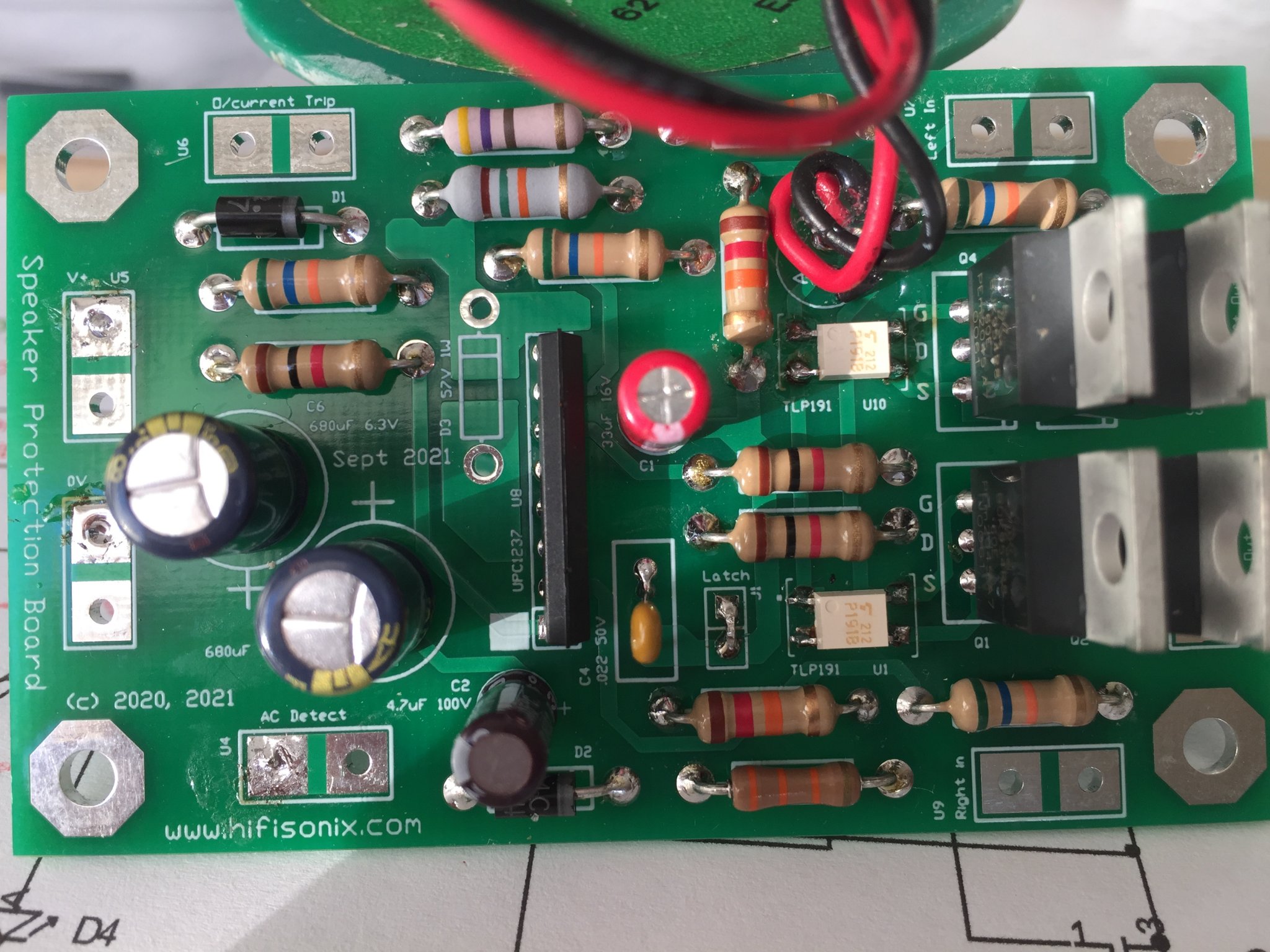

Hi Bonsai,
Eventually I completed the parts and did put the board together. Testing the board under the conditions you showed in the here enclosed drawing I get rather different V-readings from yours.
Voltages on pins 6, 7 and 8 ( UPC1237 ) read according to the drawing.
What can be the reason of the big differences on pins 1, 2, and 4? Please see attachment.
Used mosfets: BUK954R8-60E.
Hi Bonsai!Hello Ed, your voltages are within range on pins 1 and 2. Pin 4 looks a bit high.
What is the secondary voltage of your transformer?
For this testing I used a lab-ps on exactly 55Volts, DC.
So not built in in the amp.
Got them from Mouser.From where you got TLP191B?
I see that is out of stock everywhere,same for vom1271t
Thanks,probably in the past...Got them from Mouser.
You didn't connect the A.C detection,C2 not charged.
You didn't connect amplifier out,C5,6 not charged.
That's why you seen different voltages.
