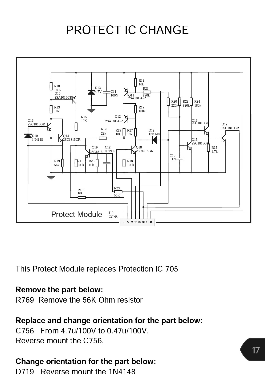

HI Thimios,If you want to go for a new version ,here is what NAD publiced as replacement because to upc1237 end production.
thanks for the share, could you share the model # in which this was replaced by NAD
wanted to see the service manual

- Speaker Protection Board
