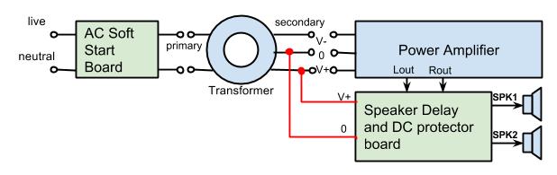

I'am not sure if the attached schema is ok. Hope it is clear. If it works I'm going to build both boards (SoftStart & Speaker delay and DC protection)
Hope someone can tell me... (total newbie....)
Thanks,
Saverio
That is how it's done. Good luck on your build.

Kindly check all your transistors. Check their values and especially their pinouts. There should be a 4-8 second delay which means the LED will blink for about 4-8 seconds before it goes steady ON.
At this stage there should be continuity between in1 and spkr1, same as the other relay.
If using a separate psu, it is of course mandatory to ground reference the separate psu to the psu of the amp for the DC protect to work.
