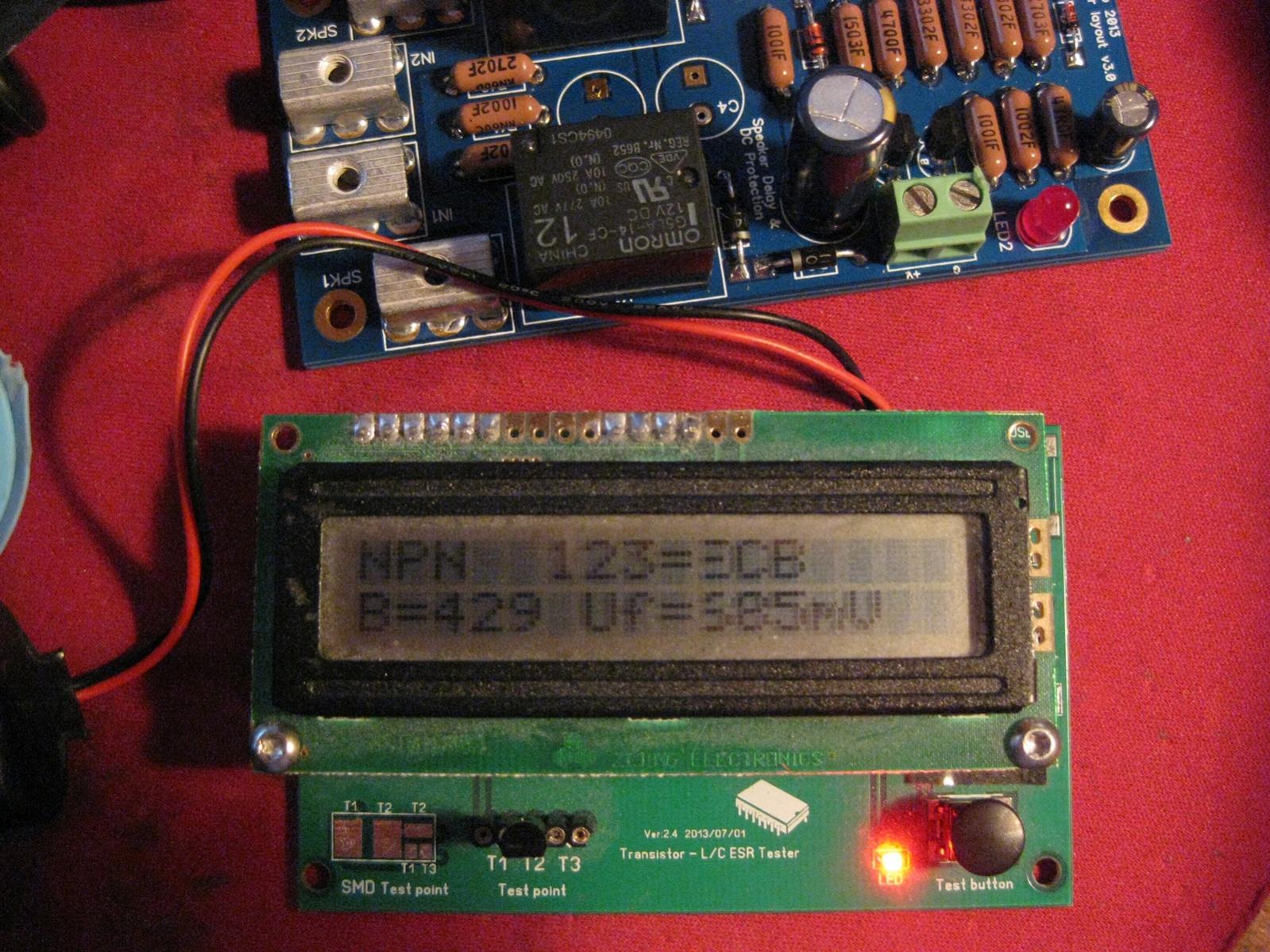

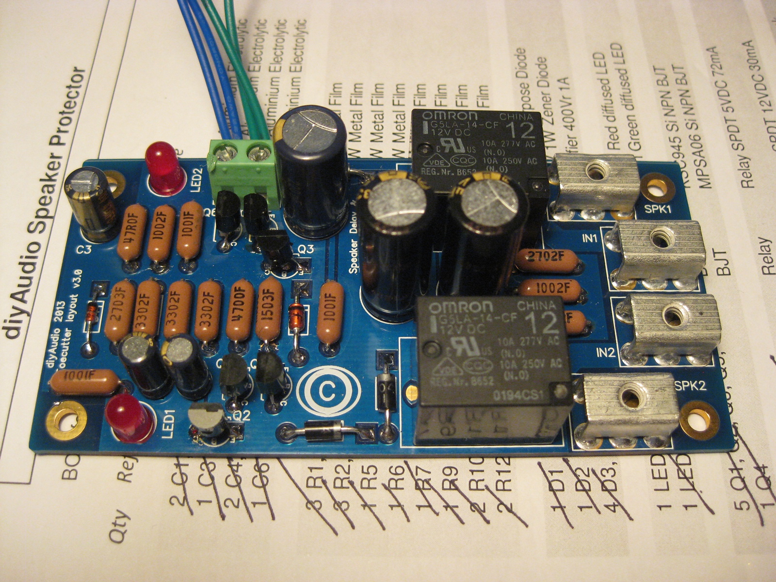

If you look under ordering information the part number listed is one with a C after the 945 which i interpret as being the center collector version. The ones i have look identical to the ones 6L6 shows in his images.
I also have one of those cheap eBay transistor tester at home so i will unsolder one tonight and see what it says.
Confirmed the pinouts are ECB for those transistors, did the leg shuffle with all five of them, and rotated those four capacitors the correct way around and its working perfectly. LED1 flashes for ~six seconds on power up before the two relays turn on. DC cutoff on mine starts @ 1.95v, its not immediate as you need to apply DC for ~six seconds before it trips out.
Also for reference, i'm using an Antec AN-0124 10VA 24V Transformer, each relay coil has approx 13.4v across it.
Looks like its good to go, thanks again for the help Jojo, much appreciated :drink:

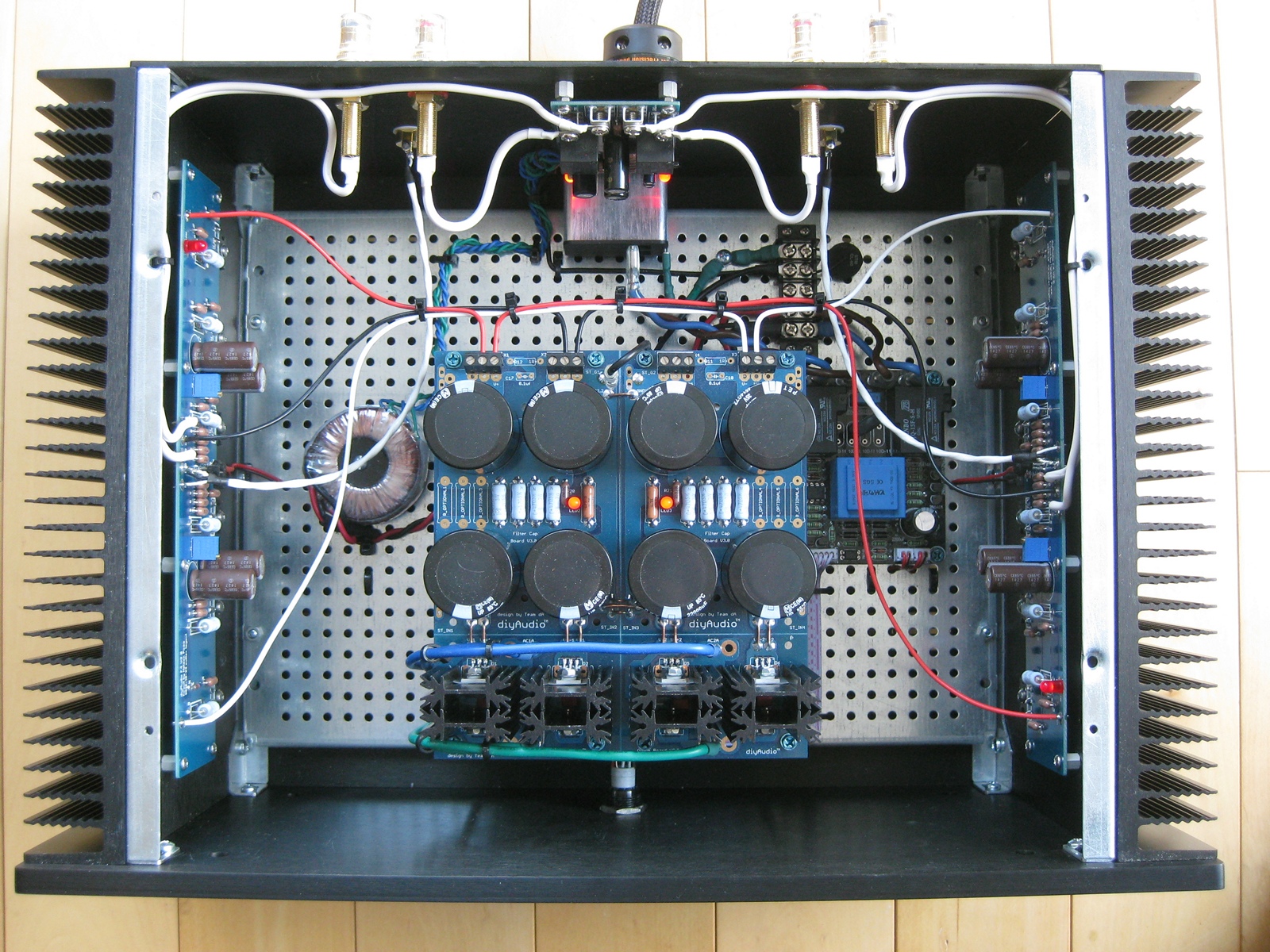

I didn't find it obvious either. Center tap is not required so i paralleled the two secondary windings of the Antek, you will also need to run a wire from the ground side of the PCB otherwise the DC detect function will not work. It detects + DC in relation to ground.
You can just about make out the wiring in the pic below..
