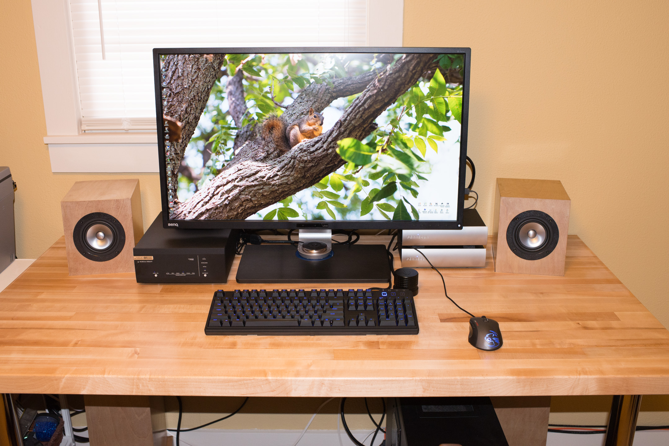

My small speakers would be perfect here:
Fostex FE126E in a small passive radiator enclosure. Tune as low as you want to go, and then EQ the result. Have 10-20w/ch available, and you're good to go.
FWIW, I got flat to 40Hz with that, but it needed a lot of cone excursion. Fine for sitting at a desk, but wouldn't fill anything bigger than a small room.

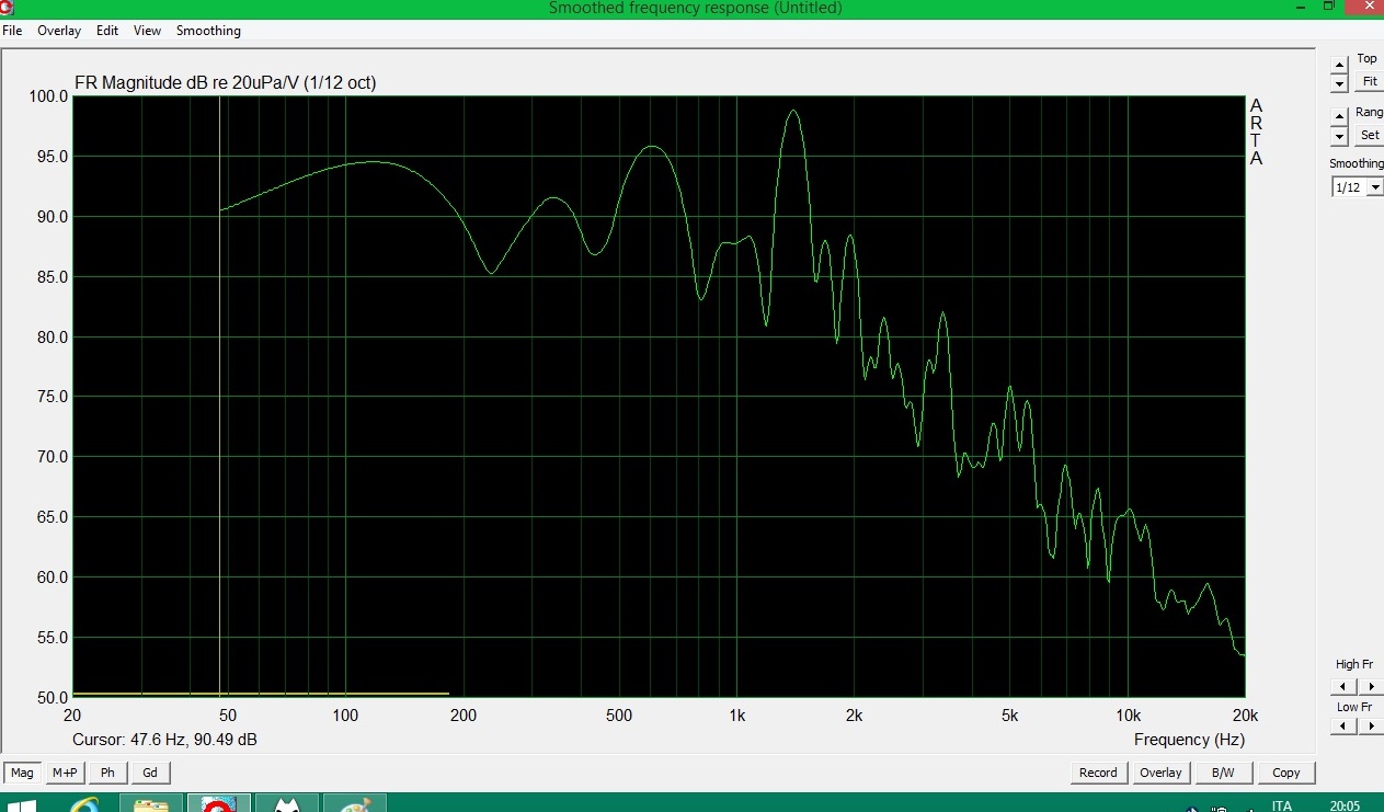

Some performance plots using an AMT-1 and Cornwall bass bin with first order (EQed flat but no delay needed). You don't need a Cornwall bass bin, but some box size would be necessary to get full 12" woofer extension and fidelity with headroom. You could also decrease the woofer size and box size, but note the increase in modulation distortion and loss of headroom.
(See the red trace below for AMT-1 after break-in and no DSP delay)

@ JR_W: cool setup. I can hardly ask my brother to cut off his desk but I must admit it's a nice idea if you have the freedom to do so.

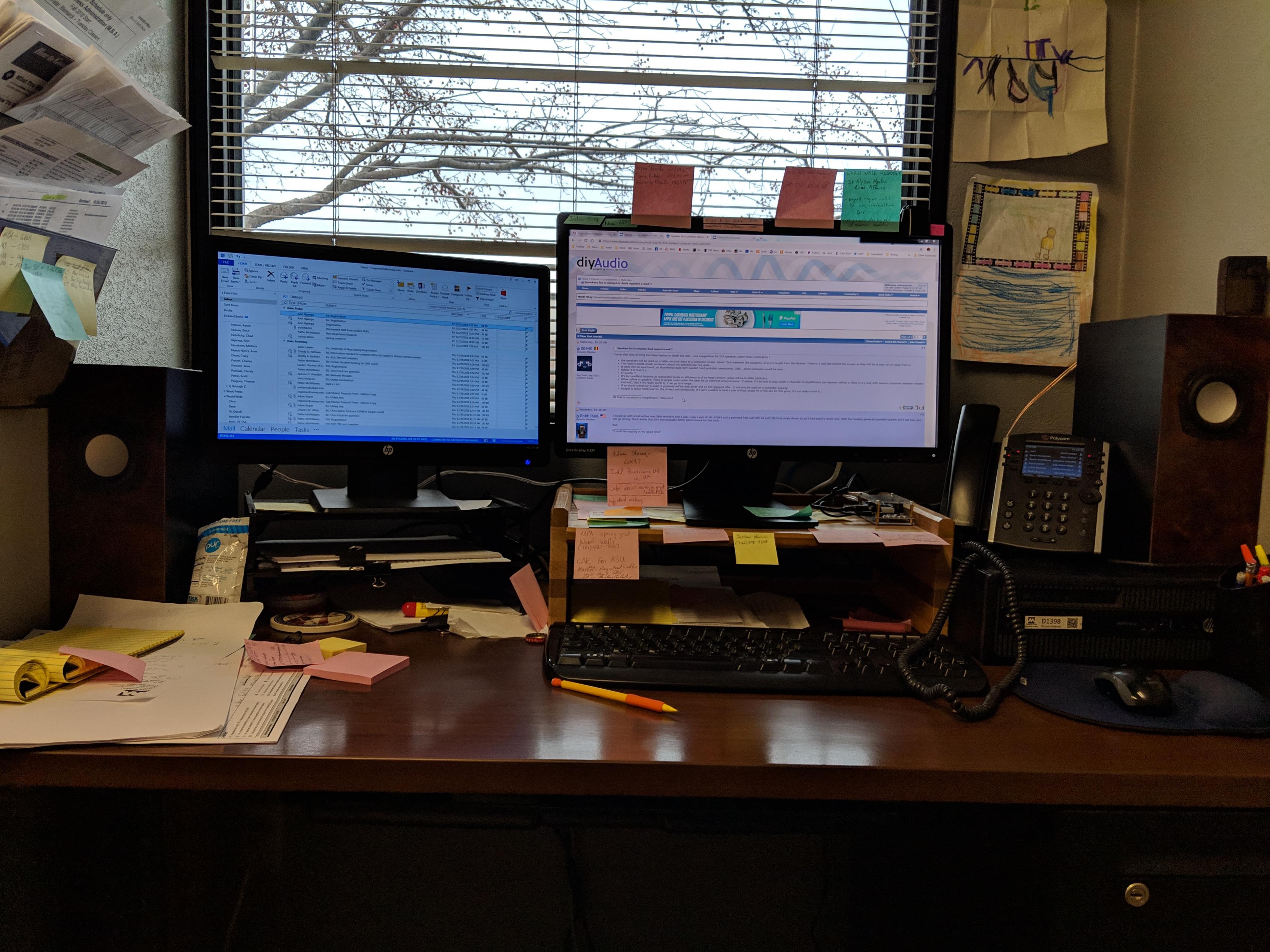

I went very simple, but enjoy my office system quite a bit. I have a pair of Baby Lab Red Eyes and a Drok amp. The speakers are about 8 inches away from the wall.
http://wodendesign.com/downloads/Woden-BabyLabs-241018.pdf
It's quite a compact system, but really does the job for me.
I've included a photo, so don't mind the state of mess on the desk (busy this time of year!).
