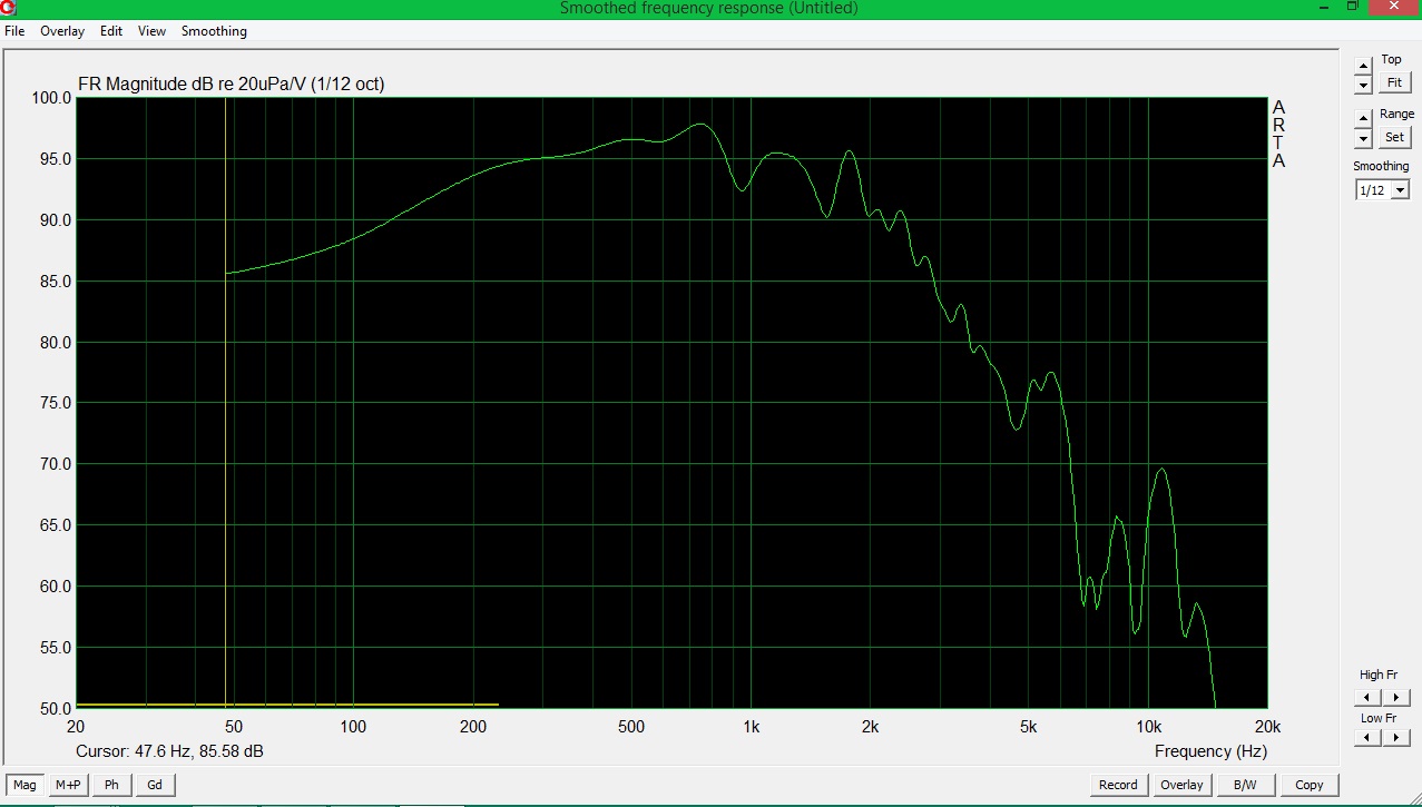

Finally considering two options. Both are 10l internal volume, -3db @55hz. They also both use a pair of Dayton DS175-PR passive radiators on their sides.
First option:
- 2x TB W6-2313 6.5" coax - 320€
- 4x DS175-PR -95€
Total= 415€
Second option:
- 2x Seas CA15RLY 5" woofer - 150€
- 4x DS175-PR - 95€
- 2x Dayton RST28F tweeter - 72€
- 2x Visaton WG148R waveguide - 29€
Total= 346€
Hypex is getting rid of the last AS2.100d for 200€ a piece, that's fairly tempting...

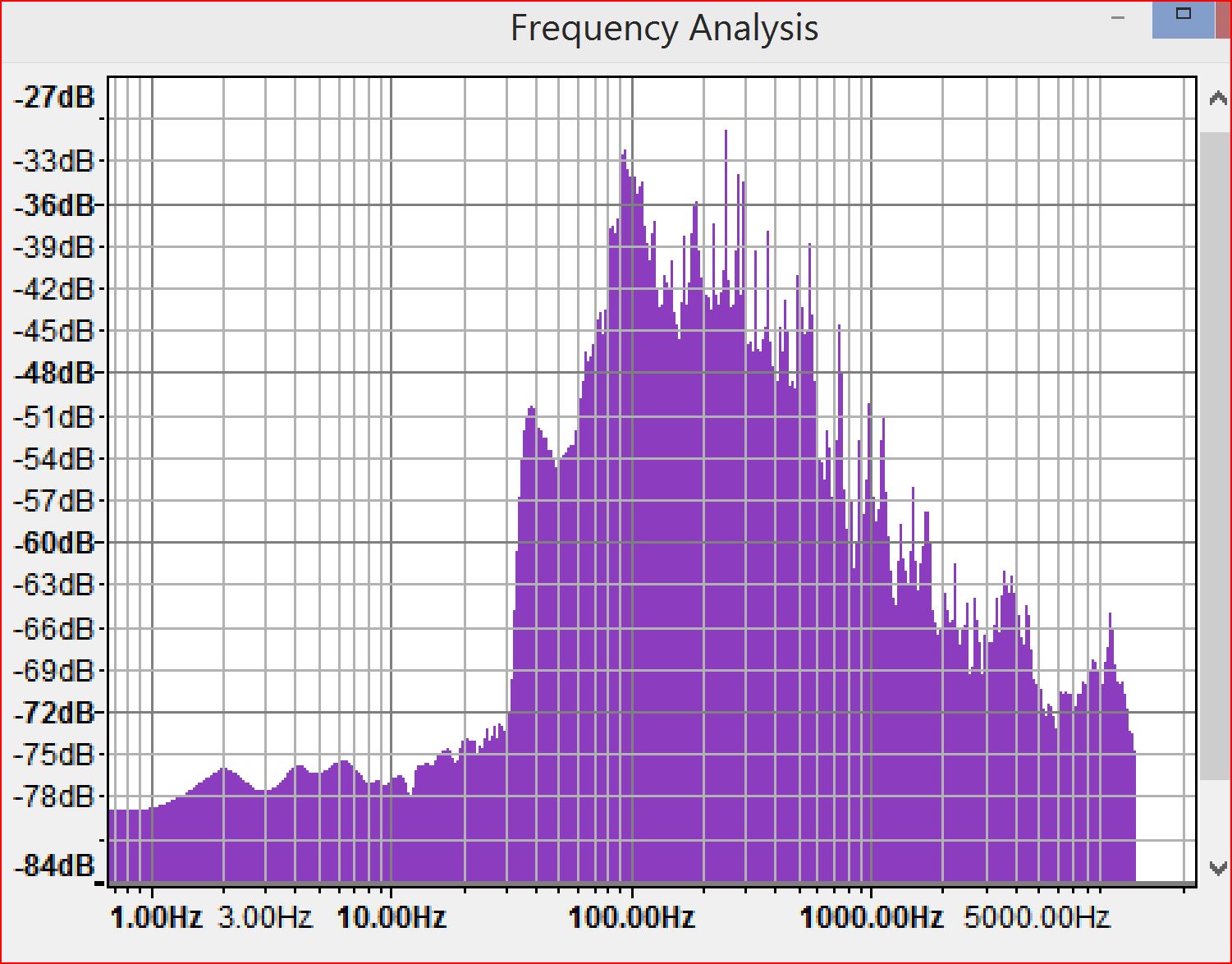

Well... to put it in another way. Attached is the spl achieved with the two options described above, a bit before xmax is reached. Being a 6.5", the TB goes 3db louder than the Seas. There's no way to achieve this kind of figures with a small full range, unless crossed relatively high with a sub. Power required isn't that bad btw. 25W at worst for the Seas, 40W for the TB.
Now, I know I don't exactly need that much power, especially in the kind of setup the speakers will be used, with probably no BSC needed and some frequencies that will need to be padded down. But I'd rather have too much in reserve than too little.

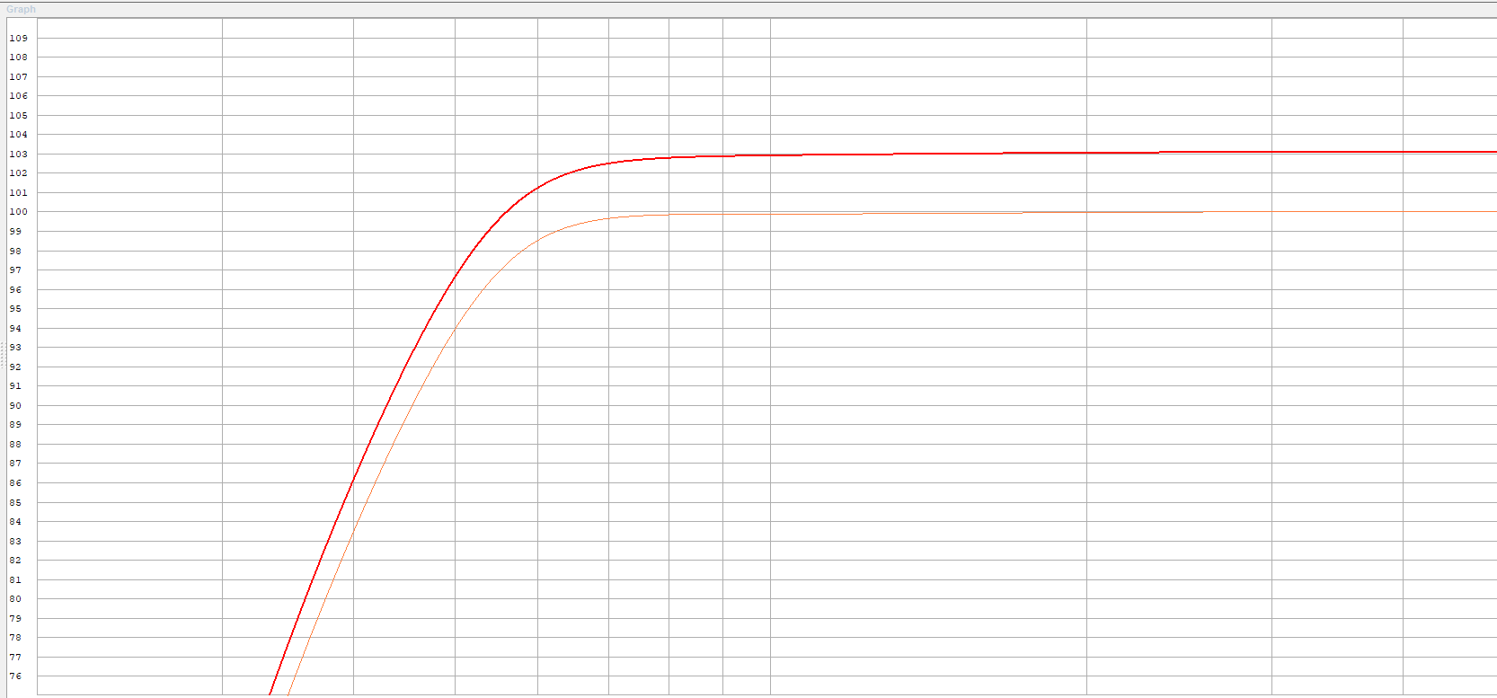

In a sealed 10l box with a LT transform and a relatively aggressive HPF @35hz, you can go up to 97db with a -3db point at 50hz (94db thus) before hitting xmax. It's quite efficient so only 15W are needed at the worst point.
Furthermore, I would only need one stereo amp. It's even more tempting to get one as2.100d, which could power both and serve as external DSP. Less problems than a software solution in the long term.

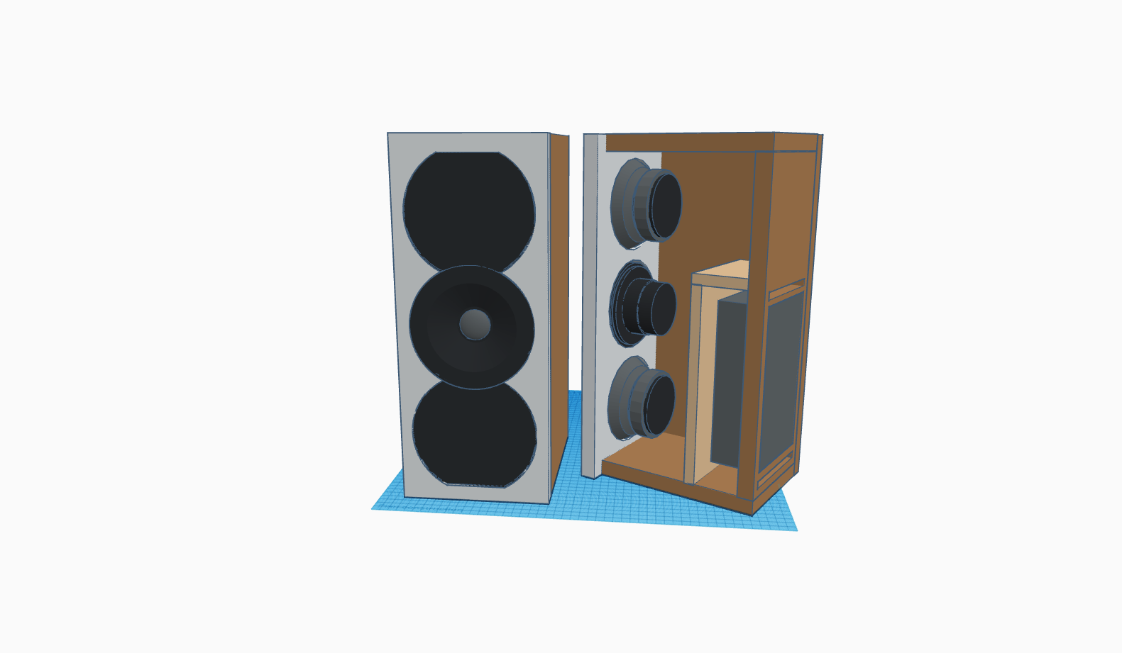

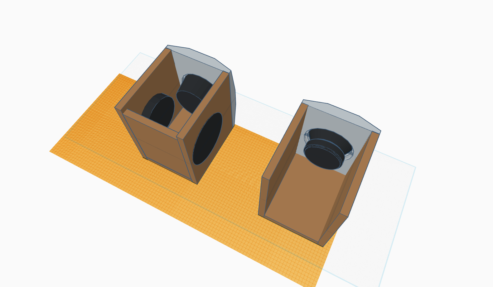

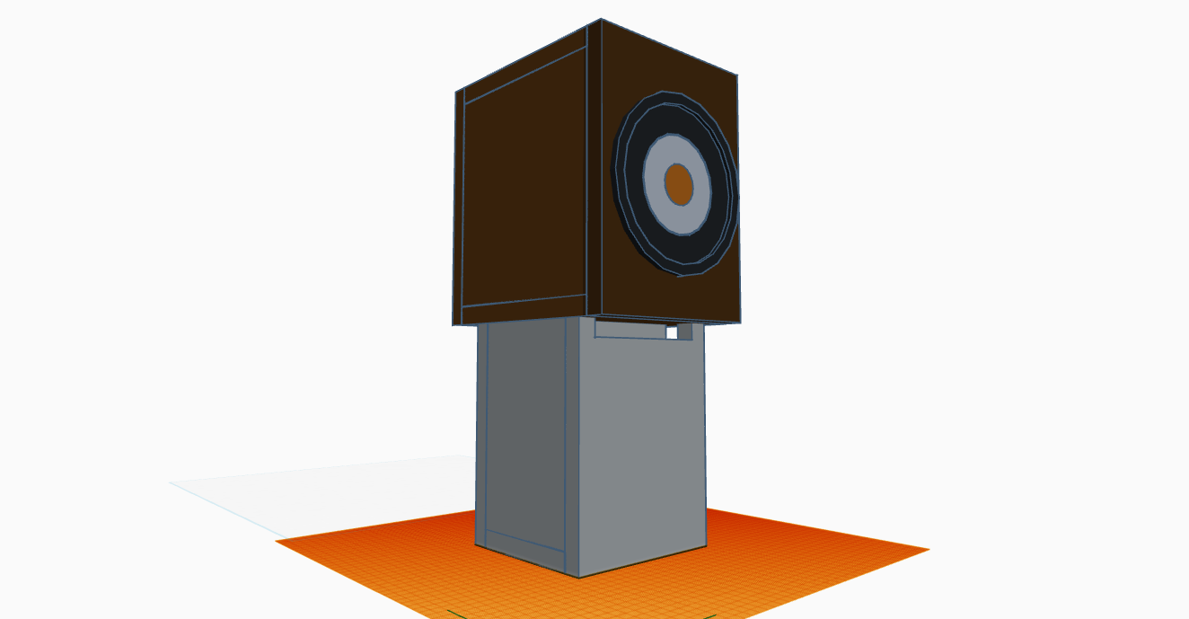

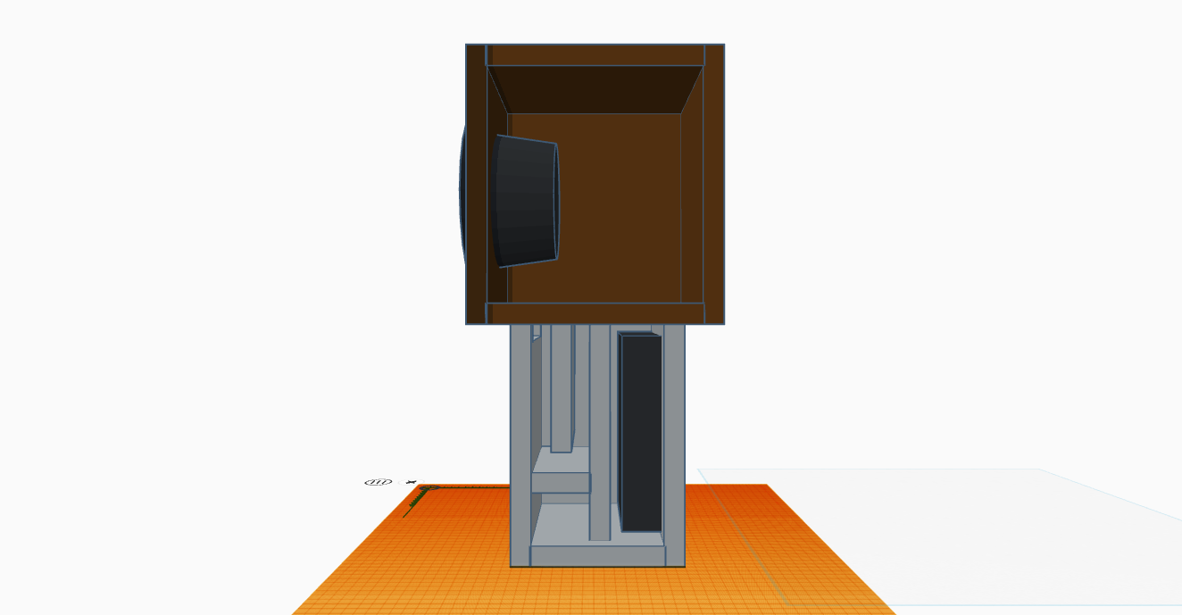

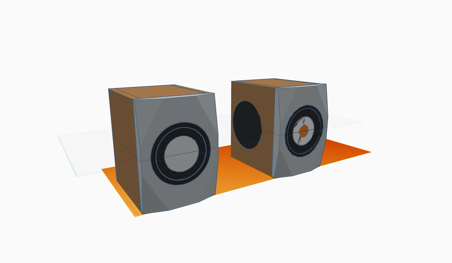

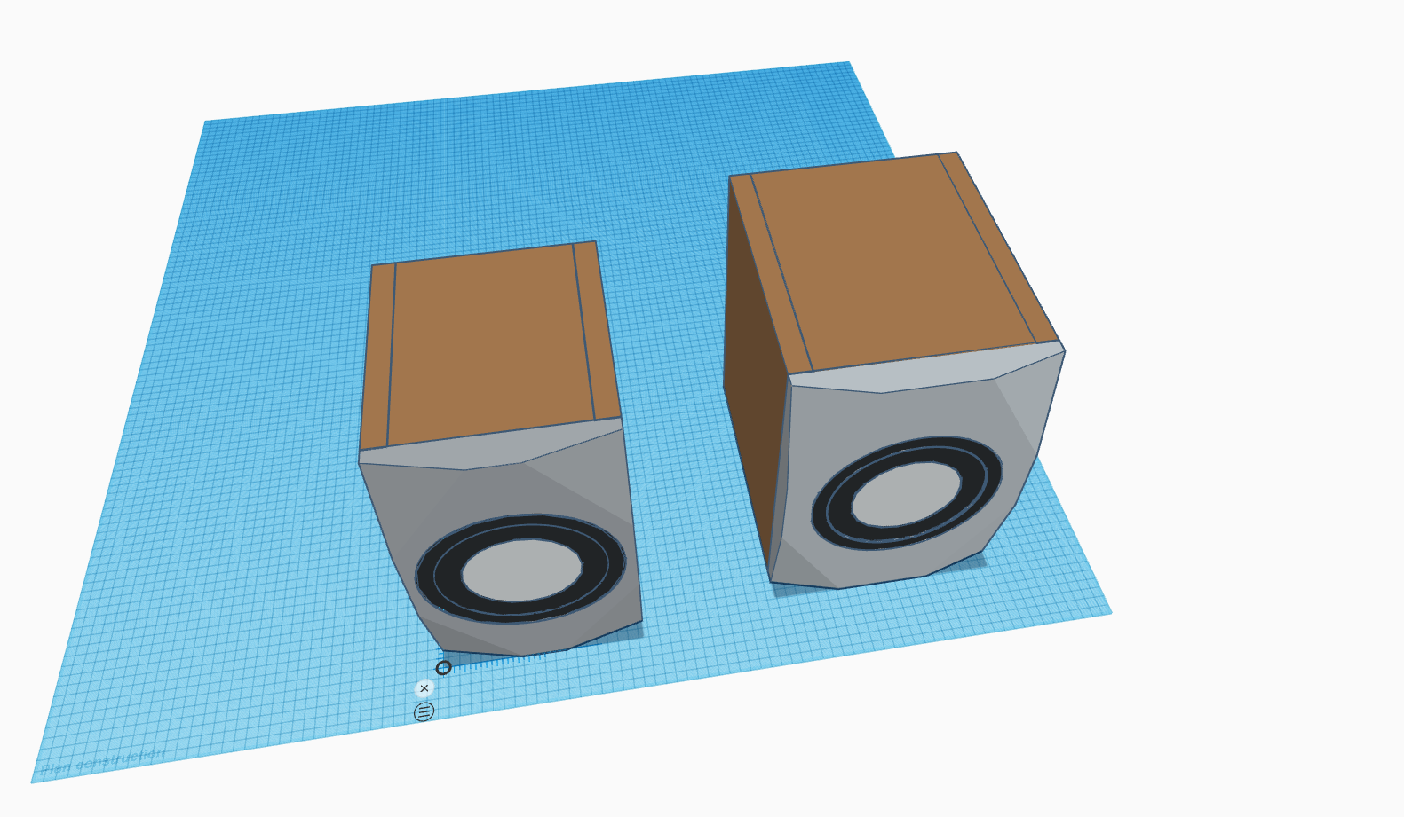

Having some fun in Tinkercad. Two 11l boxes for either the TB W6-2313 or the Pluvia 11, in 18mm mdf (30mm colored mdf for the front). A tad big at 300H*220W*280D. I could probably win a few cm here and there by filling the Pluvia box. Getting it down to 9.5l before stuffing or so.
Bringing down the Pluvia 11 to a 7l box (internal) makes a cute little speaker. 300H*190W*230D.

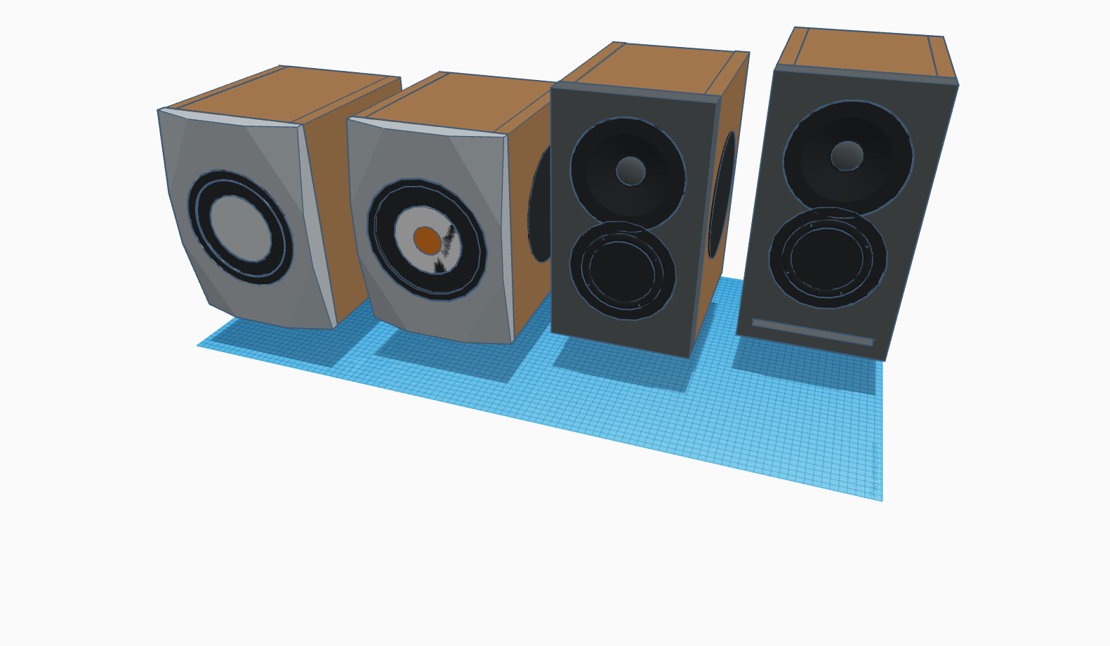

I had a look to the other options. From left to right: Pluvia in a sealed box, TB coax with passive radiators, ca15rly with rst28f with radiators or a slot port. This last option might be a nice budget option with a passive crossover.
If you measure your seated ear height, you might want to sketch out a tall cabinet for the point source TB W6-2313 6.5" coax to match that ear height. For simplicity, consider a port on the outer side panel at a height which will not get blocked by papers and books on your desk.
A bottom slot port could easily get blocked by desktop papers/books/snacks.
I have seen desktop speakers where the port tube was placed completely outside of the cabinet. The owner would unscrew the port tube and screw in a plug for sealed operation.

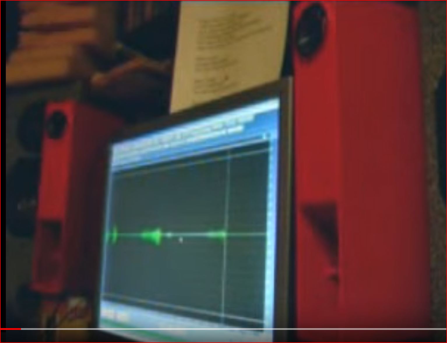

Perhaps DIY can come up with a weird cheap OK sounding bespoke solution? How about a tall thin back loaded horn so eg a single driver is at ear level for best imaging, no crossover nasties, some bass and a wall hugging design with a wedge profile looking down and the front panel angled direct at the ears. Ive never tired it but someone has:
YouTube - 2" backloaded desktop speakers

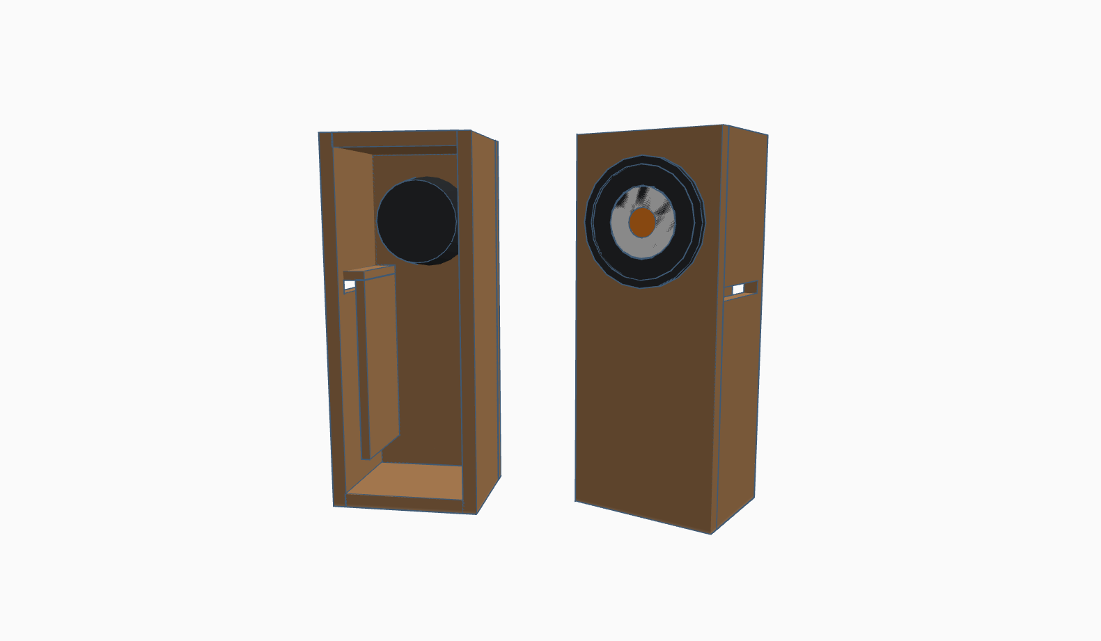

@LineSource: to bring the center of the W6-2313 to ears level requires a small 550mm high column. Difficult to go thinner than 220m wide if we want to let the driver breathe a bit. It's going to be very imposing on a desk. What I had in mind was either small stands or dense foam pads, aiming the speakers at you. OTOH, a tall speaker can be made less deep.
It's not impossible. I've quickly sketched something. I've to check with my brother if he's willing to live with that. The speakers he pointed out to me as inspirations were more traditional little 2 ways.

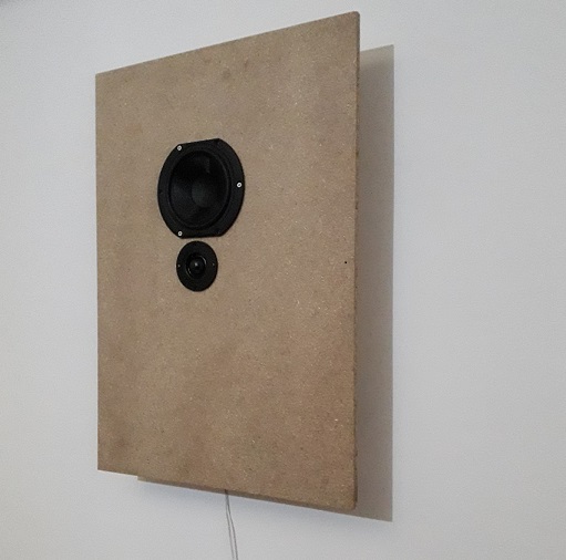

Today I made a large simple panel, with good results. Maybe also the screen could help. And some lavoration of the edges:If you use a thin wall box, consider where the hole in FR will fall. PE, for a 15 cm long box, you'll have a hole with a 30cm wavelength: 1133Hz. And probably below this frequency, a comb behavior, like this:
Ok, I think that's it now.
The final design is going towards this: 1 x seas 27tffc tweeter loaded on a wg148r, with 2x Peerless 830991 in an MTM config. Each speaker being driven by a Hypex as2.100d. A sealed 8L box, 440h*180w*230d. 19mm colored mdf (it's denser than common mdf).
Two 5" woofers will give me more headroom for EQ. The peerless are about 1/2 the price of the Seas but the sims in winisd aren't looking too bad. Their truncated frames will allow a short spacing with the tweeter's waveguide.
The change of tweeter is just dictated by simplicity. toutlehautparleur.com has all these drivers in stock. The seas is a bit less robust than the Dayton rst28f but with a waveguide it should cross under 2khz. It should also be easier to mount on the wg148r.

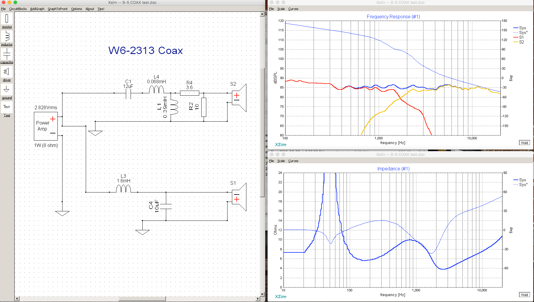

The 6.5" Tang Band W6-2313 coaxial with ear level placement would produce a "clean-clean-clean" near field sound, ideal for listening to audio books, test tones, and producing accurate nearfield sound stage music.

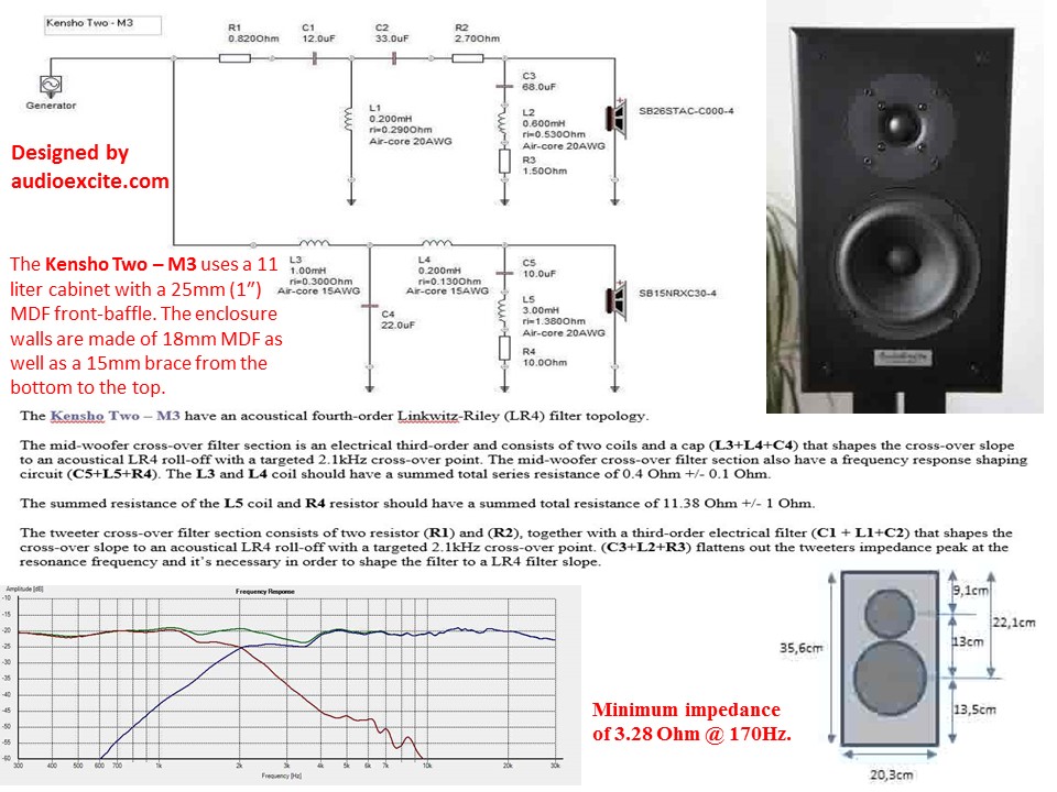

With Passive Crossover...
The reduced cone breakup from poly-plastic cone on the 6.5" SB-Acoustics SB17MFC35-4 allows great sound from a simple passive crossover with the SB26STAC-4 tweeter. Jeff Bagby Tributes use them in a 0.6cuft(17l) ported cabinet? (H16"--W9"--D12") ... a high value general music desk speaker.

The problem with any 6.5" driver is how wide they are... My brother was less than enthusiastic with sketches for anything bigger than a 5".
How important is it to let space around the driver rear ? The W6-2313 's basket is 148mm wide. Add 38mm for 19mm side walls and we're at 186mm. How thin can I make the front baffle ?

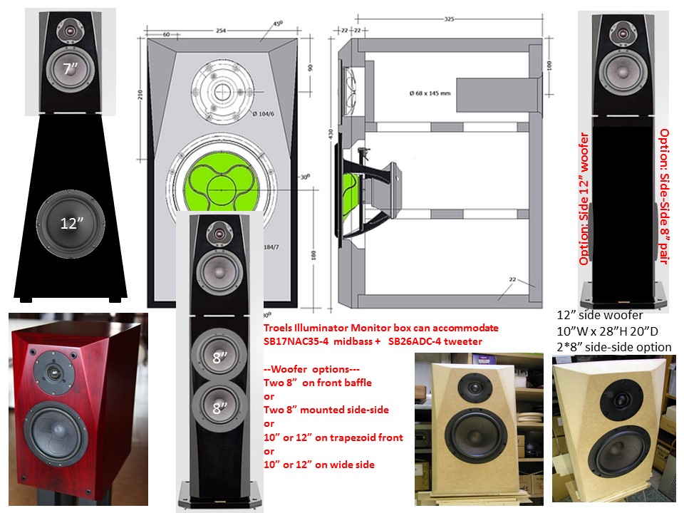

If you plan to spend $400 for a pair of DSP Hypex as2.100d amps, exploring higher performance drivers (SB17NAC35-4 + SB26ADC-4 =$100) in a modest size cabinet seems "worth some effort". You and your brother would need to select an acceptable size and shape. {SB17NAC35-5 has 171mm=6.7" outer rim and 144mm=5.7" inner rim} an 8" cabinet width seems acceptable, but 9" wide is favored for clean midrange. Exposed Baltic Birch is sexy, and your brother might accept a larger size sexy cabinet.

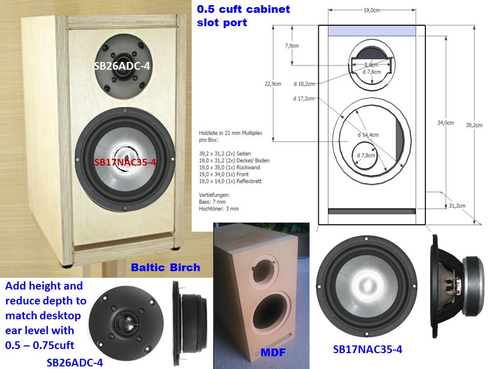

Smallest 0.5cuft=15l empty 0.75" plywood cabinet(9"W_16"H_10"D) with equalized bass. Consider taller ear level 0.6cuft=17l = 9"W_18"H_10"D
Too big?
If you plan to use a modest cost stereo amp for your brother and use the Hypex for your "plan", the $130 6.5" Tang Band W6-2313 Coaxial with a LR2/LR2 passive crossover from the diy-threads is a great combination. A tall ported desk top cabinet which puts the speaker at ear level would produce a coherent soundstage. Keep it simple. A standard passive crossover speaker is easily to move and share.
{ W6-2313 has 180mm=7.1" outer rim and 148mm=5.8" inner rim} a 8" cabinet width seems acceptable.

If your brother requires a small two-way with internal volume approximately 7.5 liters that measures about 13” tall by 7.5” wide by 8” deep with a side port , you can fit the 5" + 1" neutral sounding SB15MFC30-4 and (SB21SDC-4 or SB26STAC) with modest cost passive circuits.
