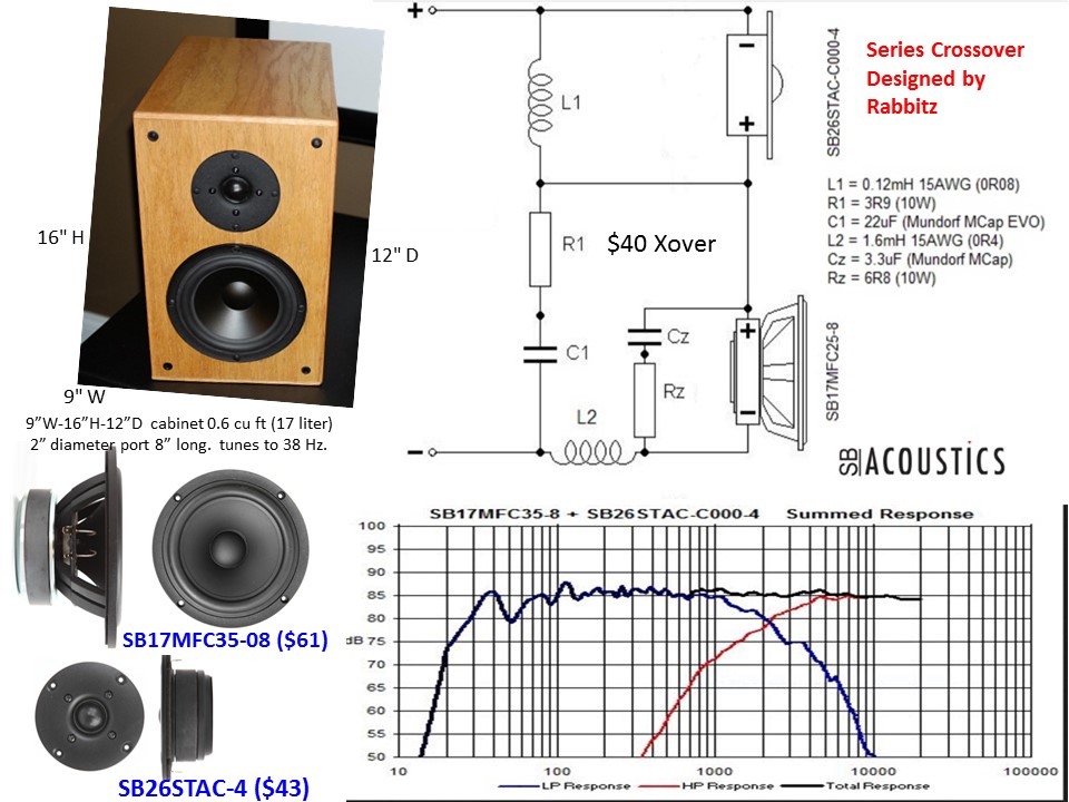

Rabbitz designed and built a low cost series crossover for the smooth sounding 6.5" SB17MFC35-8 poly-plastic cone midrange and 1" SB26STAC-4 dome tweeter which has flat SPL and reduced phase shift, and easy to driver impedance. This design uses a 9"W_16"H_12_D for 0.6 cuft = 17liter volume.
{SB17MFC35-8 has 171mm=6.7" outer rim and 144mm=5.7" inner rim} an 8" cabinet width seems acceptable. Except for reduced bass, the crossover will perform well in a smaller 8"W_14"H_10"D 0.4cuft = 11liter volume with a higher frequency side port tuning (-F3=50 Hz with a side port tuned to 40Hz using 1.5" diameter pipe 6.3" long). On-desk + against wall placement will increase bass SPL.

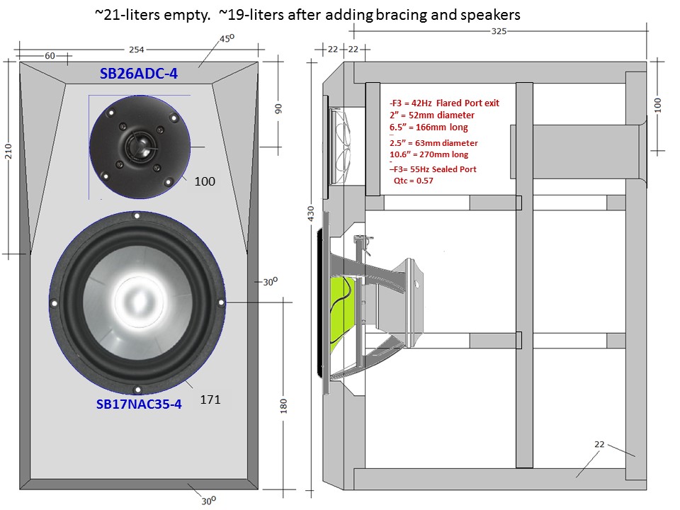

The aluminum cone+dome SB17NAC35-4 and SB26ADC-4 are capable of producing the rare combination of detail and dynamics required for modest cost magic speakers, BUT you need steep crossovers to attenuate the cone breakup.... and DSP is the best tech. Direct drive. Control of delay and crossover shape.
Troels Illuminator cabinet with beveled edges is the best 2-way cabinet for magic speakers. A good TM-top for a future TM-WW 3-way.

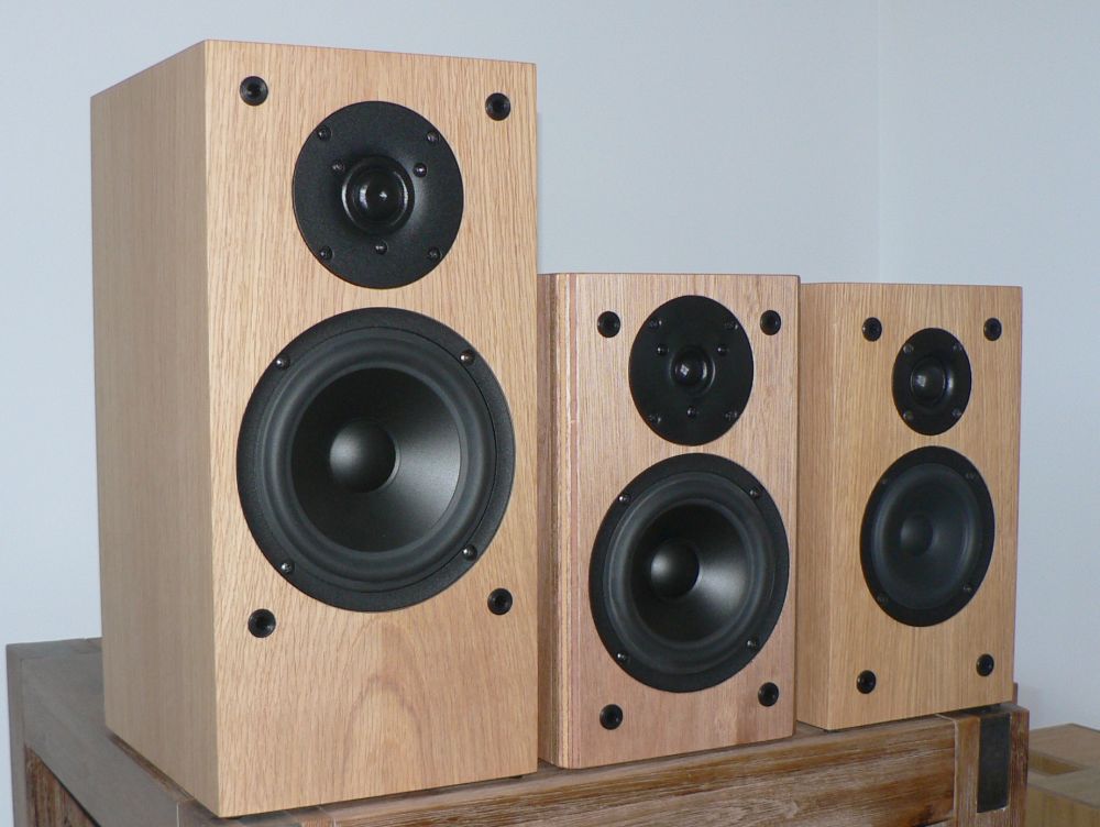

Tried 3 speakers near field to get a feel for the suitability.
SB15MFC30-8 + SB21SDC-C000-4, 8 litre, F3=52Hz
SB17MFC35-8 + SB29RDAC-C000-4, 12 litre, F3=52Hz
Jeff Bagby Soprano SB12NRX25-4 + SBSTCN-C000-4, 4.7 litres, F3=59Hz
Out of the 3, the Soprano was the most suitable for me. The other 2 I felt were "too much speaker" and better when used far field. It's only my preference but I like a desk top speaker to have an F3>65Hz as I feel the bass can swamp the other frequencies. Others on the other hand prefer the larger fuller sound up close.
I've added a pic to show size variations.

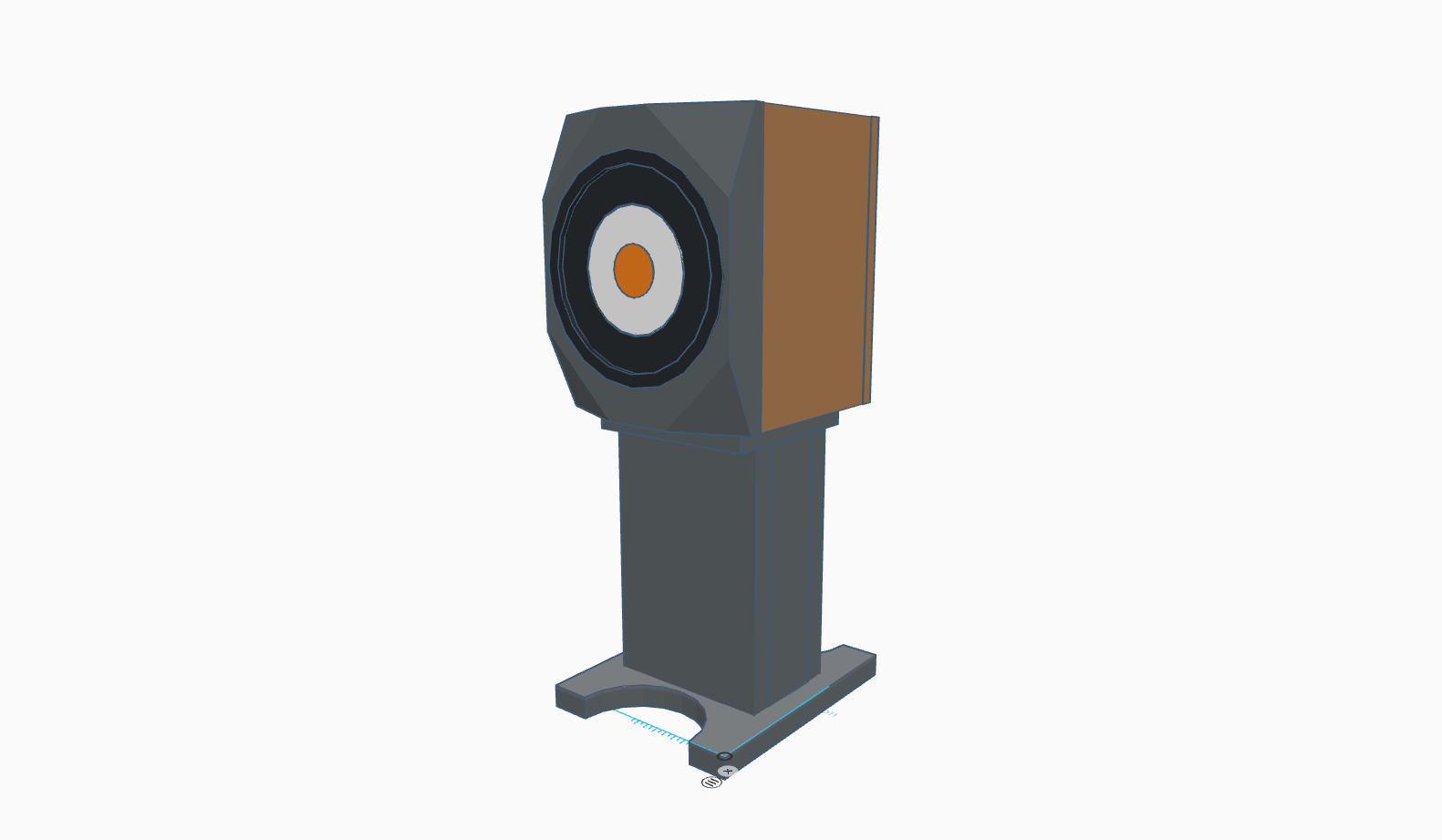

Ok, after toying with too many ideas for too long (I also considered a visaton B80+ peerless p830946 FAST setup), I've finally ordered the w6-2313 coax. Having a discussion with perceval who actually has the TB drivers helped
The hypex modules will go into stands and the drivers into small 5l boxes on top of these. If ever I'm not pleased with the TB, I can always put another small box on top of these stands
To give you an idea, the baffle is 190*240mm and 38mm thick (two* 19mm mdf, that will need serious chamfering). The overall dimension is 190W*240H*200D. As DPH suggested, I'll move to 12mm plywood for the rest of the box.

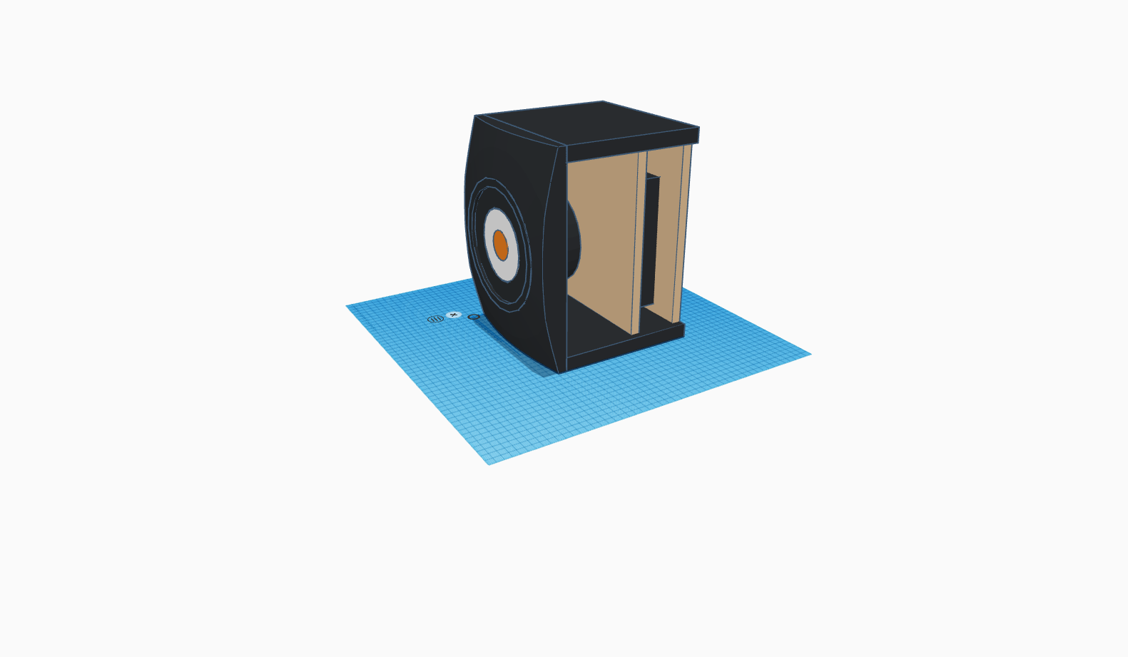

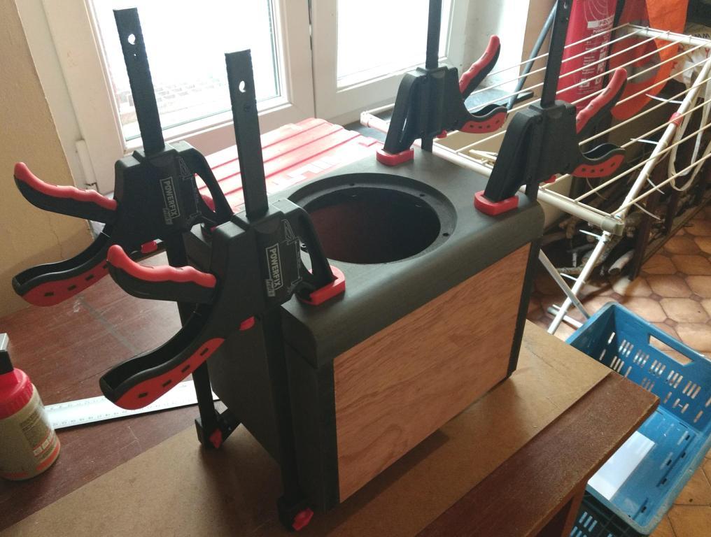

I got the wood cut at the shop. I'm going for a more simple enclosure finally, with the plate amps in it. The most difficult part will be the curved frontplate (made of two glued pieces of mdf).
The front, top and bottom will be made of 18mm thick black mdf, simply sanded before a clear coating. The sides will be 12mm plywood. The whole sides will be covered with a walnut burl veneer. I found some gorgeous sheets at a French webshop.
Total dimensions will be 300mm*220mm*236mm (h*w*d), for an internal volume of 5.5l (once the driver taken into account).

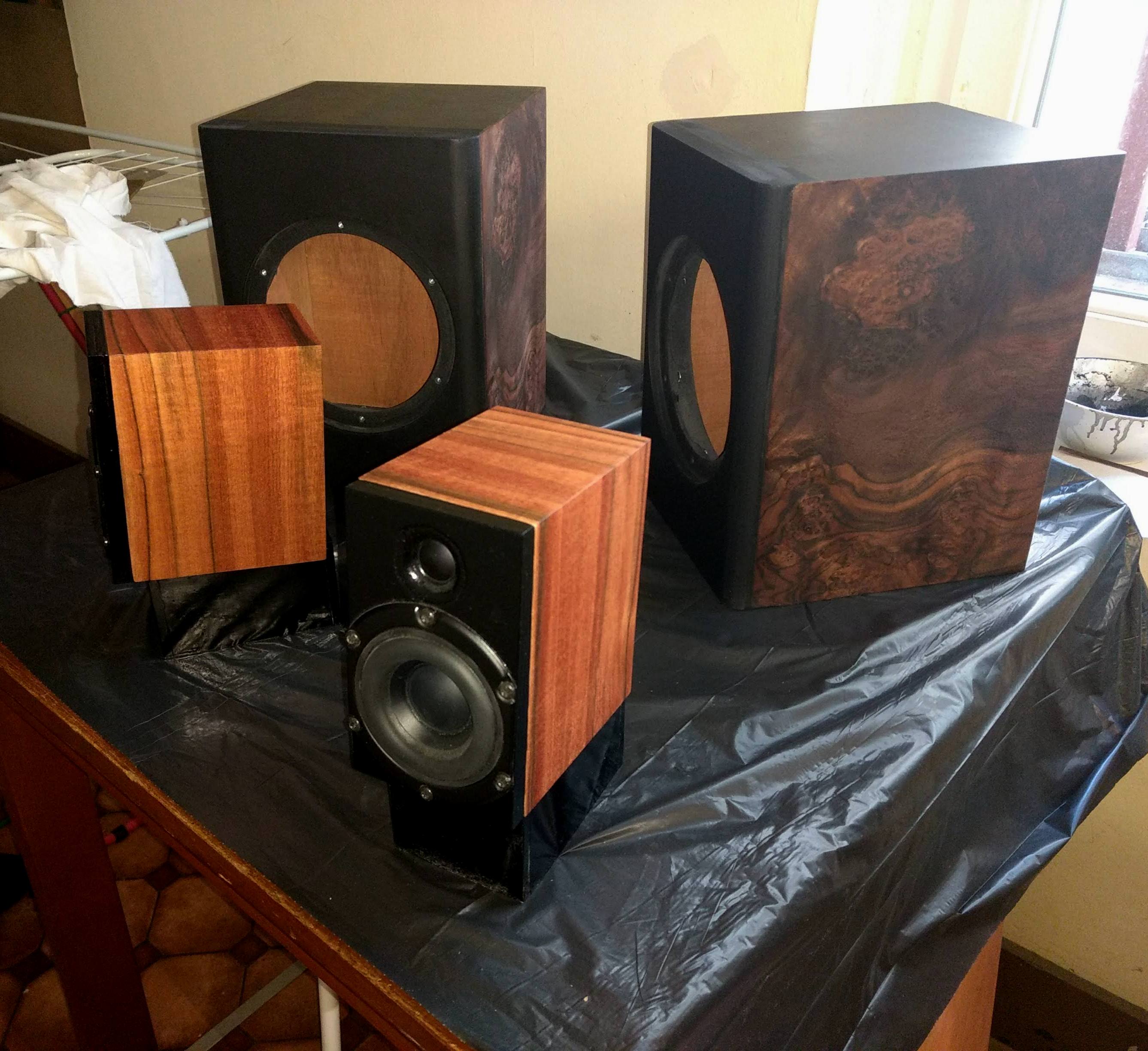

With one coat of Rubio oil. The little boys are the µ-microspeakers which had never received their final finish.
Btw, this oil is a pleasure to work with. Monocoat, easy to apply, I couldn't ask for more. Pricey though. About 40€ to cover 4m² (so about 10€ for these speakers).

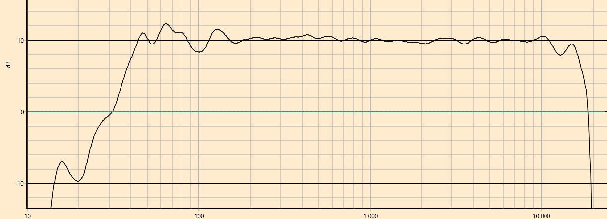

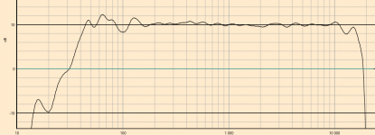

I measured the speakers this evening. I used HFD for the initial measurements and the crossover design and REW for the validation. I managed to invert the wiring of a woofer apparently... It's a good thing that a simple tick box allows me to clean that mistake without opening the box again.
The crossover is a LR4 at 1.7khz, after EQing the woofer and tweeter flat about one octave high/low.
The measurements were taken with the speaker at 2.15 height, the mic on axis about 75cm away, all walls at more than 3m. That should give me a relatively clean bass response up to 80hz. The three rew measurements are at 0°-25°-45° (obviously they're spaced away).
There is obviously a rise off axis between 6 and 10khz. I'll have to measure that again with the speakers in position and see how to mitigate that.

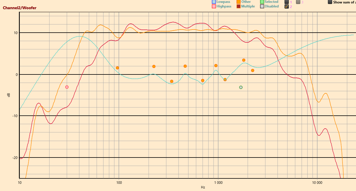

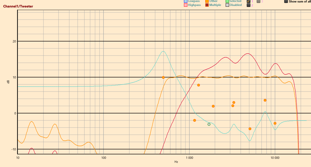

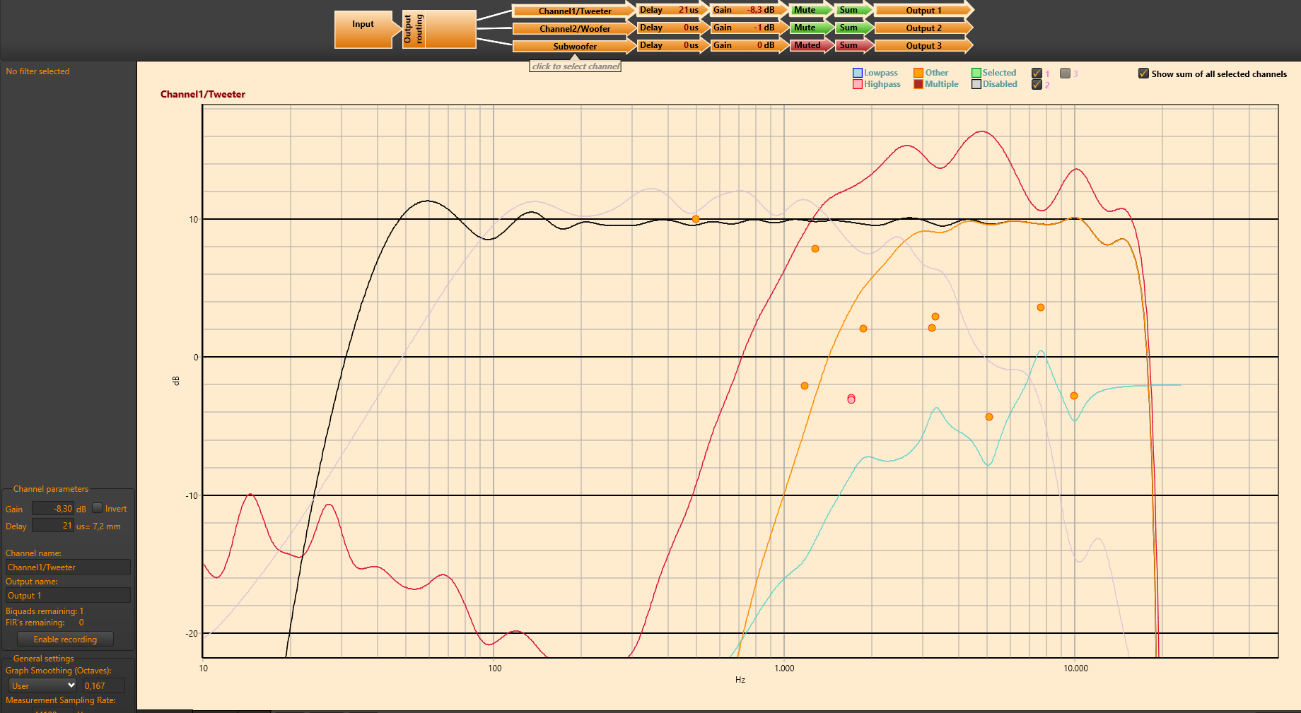

More details on the filters as setup in HFD. This is a first attempt at active EQ and it might be a bit naive If someone spots an obvious mistake, I'll gladly accept suggestions for improvements.
The screenshots show the EQ response with the LR4 crossover filters disabled.
On the tweeter I've got:
type freq Q db
boost 500hz 3 10db
cut 1150hz 3 -2db
boost 1900hz 3.5 2db
boost 3300hz 6 3db
cut 5100hz 5.2 -4.3db
boost 7700hz 6 3db
cut 10000hz 6 -2.8db
lowshelf 1280hz 0.8 16db
asym highshelf 3250hz-4650hz 0.7-0.7
And for the woofer:
type freq q db
boost 225hz 2.5 1.9db
cut 340hz 2 -1.7db
boost 465hz 6 2db
cut 700hz 6 -1.5db
boost 950hz 6 2.1db
cut 1180hz 6 -1.3db
boost 1800hz 2.5 3.4db
asym lowshelf 97hz-50hz 0.9-0.9 (bass boost based on sims rather than measurements)
asym highshelf 2250hz-4275hz 0.6-0.4
highpass 30hz 0.7 (to protect the woofer from over excursion)
