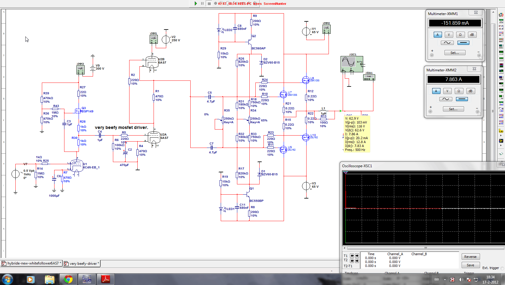

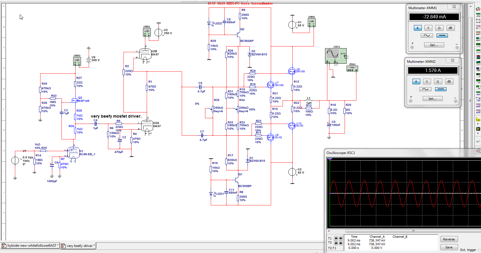

I have some strange behavior from multisim, a lot of simulationerrors like in this schematic, put the yellow mesurement on the output and it simulate very strange, voltages and amps are totally strange, much higher idle current, and no signal anymore, see pictures, the one without the yellow measurement on the output works oke.
Multisim has also a lot of faulty models, is this suckware maybe. I seek also a model for the semisouth j-j-mosfets.
thanks in advance.

still multisim has error or better bug,s, If I copy and paste a part of a other design like a mu stage in a excisting schematic , it wil not work anymore, strange voltages and 100 ampere in a tube for example,, if I copy the whole schematic and past it in a nieuw sheet incl the mustage or other, it works again but with a warning.
this I have as long as I use that software, special in windows 7 it makes problems.
regards
while working at real EE jobs with the ability to buy $$$$ software I've chosen to use Ltspice for sim
its really hard for me to imagine why not use a free, unlimited nodes/devices Spice designed, supported by engineers, for engineers
if you give Mike a fully documented bug report he will often fix it in the next release, every few weeks usually - I've had one fixed over lunch hour!
the UI is intentionally "flat" - not a production schematic entry tool for a dedicated draftsman - rather a working engineer's tool - used internally at Linear for chip design
the convergence, speed are competitive with the $$$$ tools, there is the Yahoo support group for Ltspice specific issues
it is not a dumbed down learning tool - but if you already know Spice you should be running sims in < 1/2 hr - including download time (in Windows - I don't know how long a Wine install takes)
