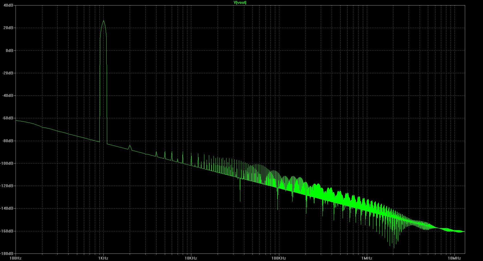

10 ns max step size, plotwinsize=0, default fft settings gives -180 dB numerical noise floor with 10 KHz sine, 2ms sim
selecting Blackman window function in the fft helps with settling time "tilt" of the fft noise floor, just saving the final few ms after a settling time can be done with .TRAN settings or in the fft dialog window

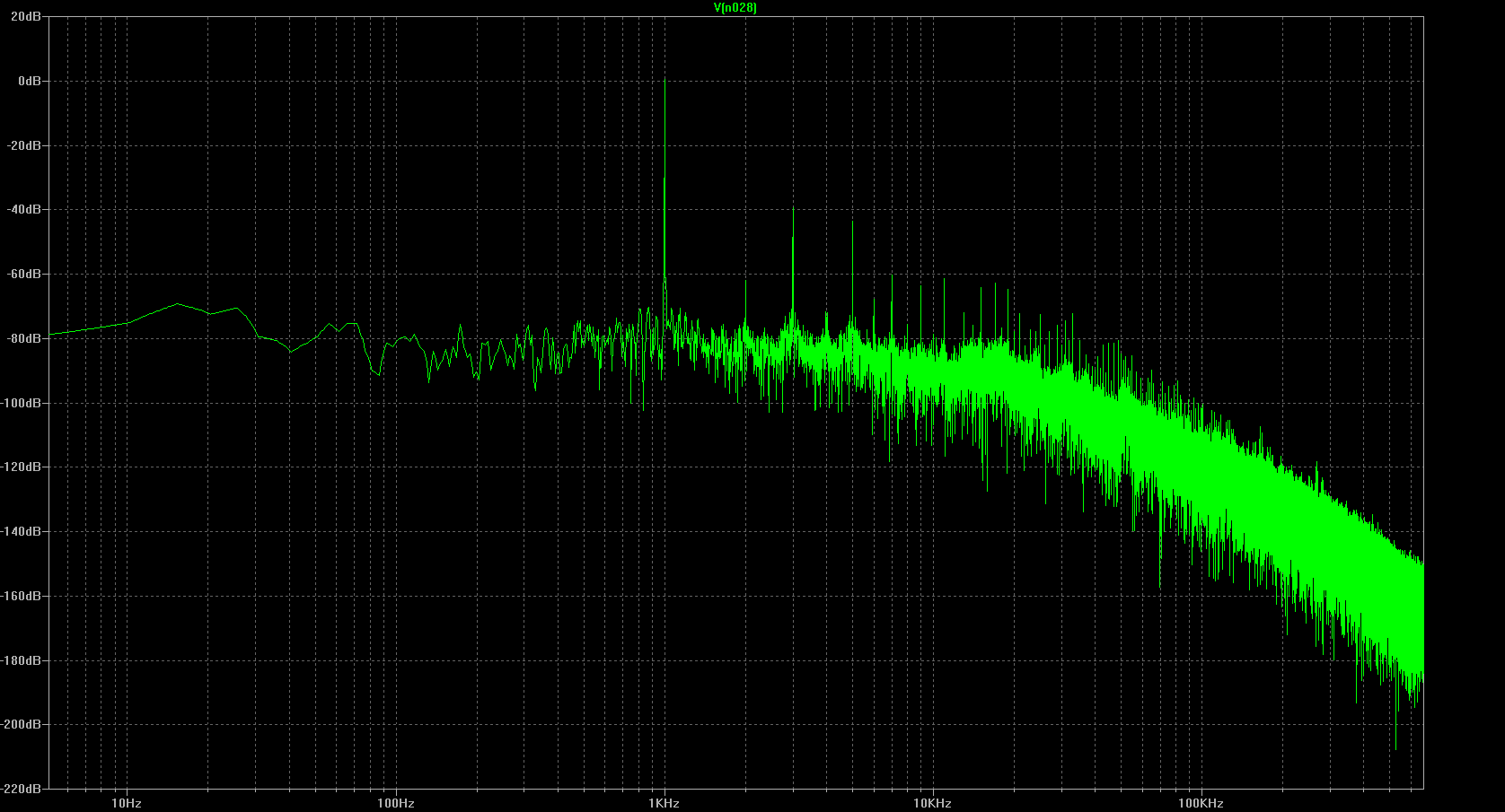

LTspice's generator is pretty good, but one needs to take care of some parameters.
attachment.php
Consider the cap replaced with a short, for the moment. Then this sim will have distortion levels at 1e-15 (-300dB), using the .four command, not the FFT in the graph display. This comes from the small time step (10,000 points per period, de-rationalized with the Pi/3.14-thingie which helps when you want to analyse multiple periods) and the double precision option, and most of all from the directive plotwinsize=0, which tells the program to turn OFF waveform compression (which is lossy).
Then put the cap back in. Distortion will skyrocket inspite of the perfect oscillator... because the circuit has not settled from the wideband input (down to DC) that a suddenly started sine intrinsicly shows. It gets even worse when you add a dead-time to the generator. One can use generators circuits that fade in with a raised cosine envelope which reduces settling time quite a bit.
Here is a .asc file with every performance tweak I've found so far (well, not quite all of them, but all of the functional ones). I use this param set for every amplifier I simulate. This will let you tweak simulation speed without causing problems with sample aliasing and compression.

Very confused on baseline noise. If I just have a voltage source, 1K resistor back to ground. Run 1K, 1000 cycles through it. Look at the FFT. I have a noise floor at about -80dB and quite a bit of distortion. This implies the sine generator is pretty poor. So poor, I can't really tell much about my simulation as it is better than the generator. Am I doing something very wrong?
