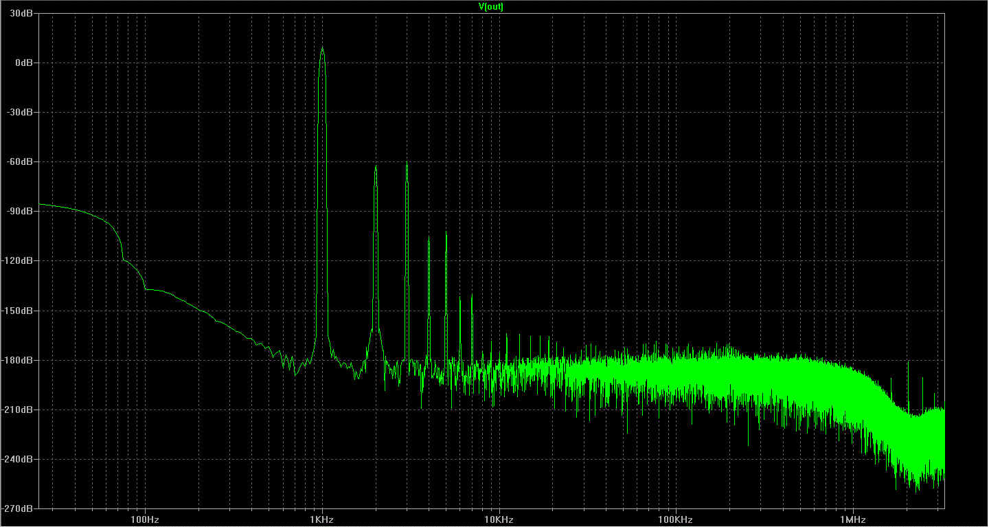

follow up from a post in the Tubes/Valves section " Vacuum Tube Spice Models"
I've got this fft sims (a push pull tube amp at 1W output) same circuit, same conditions , same everything, xcept diff windowing
a default (no windowing)
b Blackman
c Hann
I'm interested to learn which one is most adequate for (analog) audio devices analysis, and , if possible, why

the rising to the left "floor" often indicates a settling time tail 0 you need more accurate initial DC solution or to run the sim longer, just fft the last few 10 ms
do you have compression turned off? - add .option plotwinsize=0 to every schematic where you want good analysis resolution - because LT "SwitcherCAD" spice was designed initially with their switcing PS components in mind it uses lossy data compression as default assuming you would neede huge number of switching cycles for good sims
