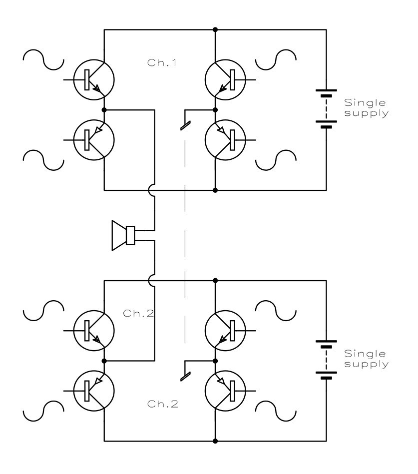

What I don't get is how you can bridge a bridge. Presumably the configuration ends up effectively placing the two independent and floating supplies in series, doubling the available supply voltage.
Not at all. The supplies must be totally independent. They have no link with each other whatsoever, or it wouldn't work.
Since the only thing a bridged bridge has in common is the ground, each bridge provides a full swing, and in the bridged bridge, they are in opposition, doubling the swing again.
I understand that this was/is a tangent and the Crown paper you linked only mentions Class-H/G as a comparison. I just felt that it was worth mentioning, for anyone who might read that document, that its description of operation of Class-H is wrong.
Good, so this can clear up a few things for others dropping in.
Please note that I said "effectively", not directly.
Thank you for the illustration; this is what I had ended up expecting to see so it's good to have that confirmed/clarified. I believe that this shows that the supplies are effectively connected in series, by the interconnection of the grounds. (e.g. trace the current loop for a current through the load - it passes through both supplies).
Through the amps yes.
So with rails at 35V, we end up with the equivalent of 70V on a grounded bridge and then double that again on the bridged bridge. Not bad, only using 3055s with their super limited vce0. And close to 800W is the psu can hold up the load without sagging too much.

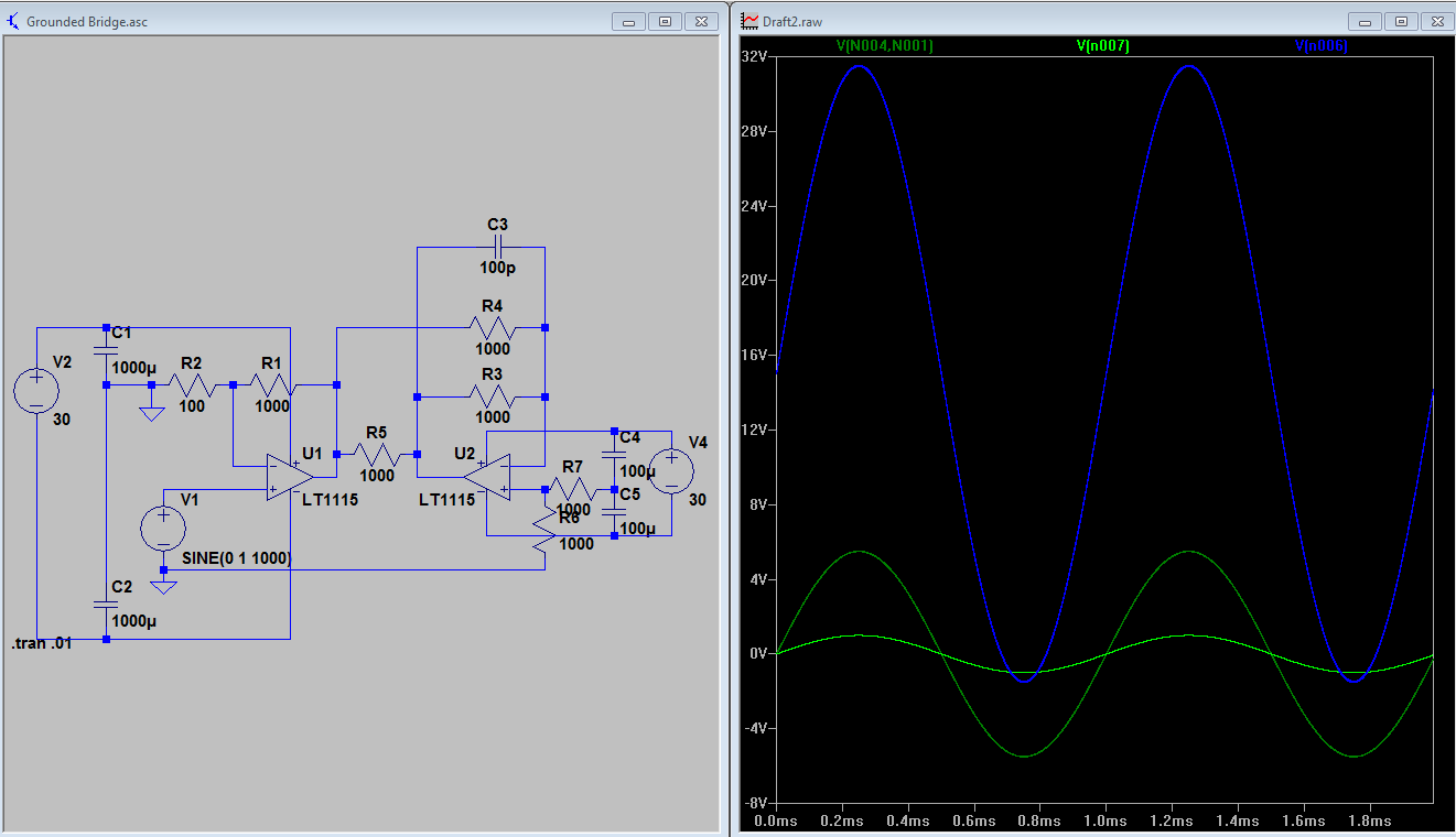

Grounded bridge
I had to build a model try to figure out what they are doing. I don't think its got a lot of value today unless its important that an output terminal be grounded. I have attached a simulation that should explain the concept. I think its more complex than necessary.
I think this particular simulation isn't of the grounded bridge. It is indeed bridged, but not grounded. Neither output is hooked to ground, plus there are 2 separate psus, which isn't the case in a grounded bridge. Both sides of the bridge work off a single psu.

Your right, I got pieces wrong. Two big issues are where the bridge is grounded and what is the return path of the current from amp to amp. It seems it needs to be much more complex. Both supplies will need a center tap to work it seems and where the center tap of amp 2 connects back to the center tap of amp 1 is the key to the puzzle.
The one piece from the description I did get is that the second amp derives its input from the output of the first.
The Crown marketing material is really misleading and merges unrelated concepts and completely fails to to explain the grounded bridge. Is there a schematic of a crown amp that can be reversed available?
The grounded bridge doesn't need a center tap, and both sides work off the same power supply. Actually I don't think it can work properly with separate supplies, when the low side is forcing the swing on the psu connected to it, this swing must be applied to the high side, so that obviates a unique psu.
Quite true. So far, what I gather is that the inverting input on the low side gets a fraction of the output signal, which comes from the high side (the output from the low side is the grounded one). That fraction of the output signal is made with a resistive divider. And then the non inverting input gets a fixed center tap from the rail, made also with a resistive divider.
