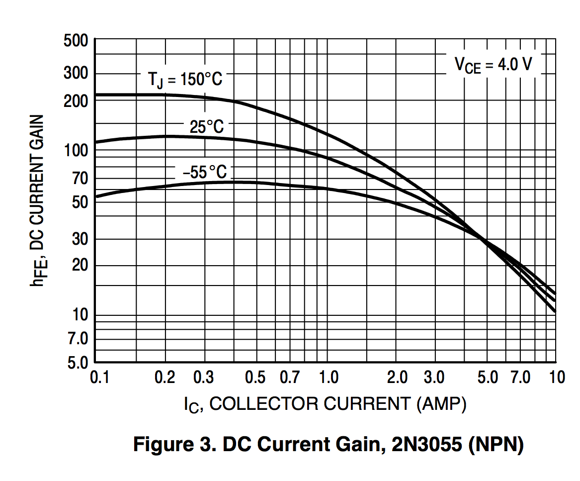

With some more knowledge, some parameters can be deduced from looking at curve plots in those datasheets, and they're just approximations, but this requires knowing how to interpret that properly.

I've seen the BF parm in models vary from 73 to 360. Now that can't be all correct. For one thing, no 3055 has that much beta anyway, as the datasheets all spec it at 20-70, so I think anything above about 100 can't be too realistic.
However, having compared that with the curves in the datasheets, I find that a value of 110 for BF seems rather fitting.

I looked at value of beta at 1A on the 25C curve, which was at something like 90, while keeping an eye on where the beta ends up at 10A, which is a little over 20 or so. I look at several datasheets and guess-timate a rough typical value as a base.

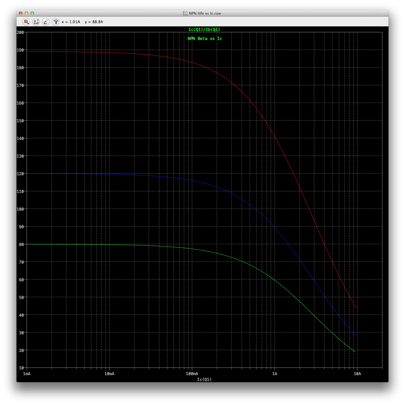

I picked IKF (for 3055) at 2.66 because it placed the point that I picked as a reference in the right place. That was the beta at about 90 for Ic at 1A, which I figured was about right, after comparing datasheets.
To illustrate my result, I'm posting a snapshot of the plot from my test rig, where there are 3 curves for 3 temperatures at -55C, 25C and 150C, which were available curves in datasheets.
That's for a new model in development, that only has a few defined parms so far (3055).
The blue curve is the 25C temp curve, and it does have the crossing very close to 90 beta for Ic at 1A.
Was that wrong? Other interaction would move this I suppose.
Here is what that embryo of model looks like:
.model 2N3055 NPN ( BF=110 IKF=2.66 XTB=1.3 VAF=150 CJC=300p CJE=500p )
Not much there, but many parms have defaults, so it actually more than it looks, although largely wrong.

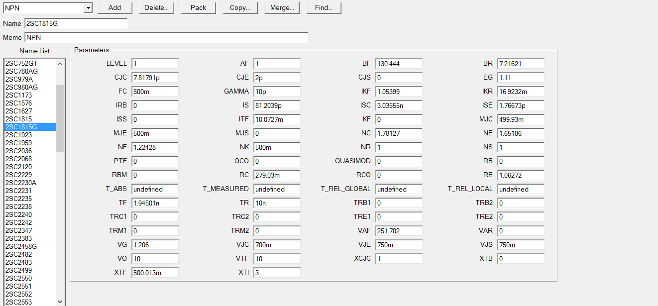

I'm just realizing one thing that must have an impact on what we measure from devices for capacitance.
Along with CJC and CJE, there is also XCJC, and I would assume an actual measurement would be XCJC and not CJC.
With a meter like this, I have no idea how it does its measurement and how much current and voltage is used.
Choose Ikf to position the Hfe peak in about the right place, but don't worry about getting the cliff part perfect until you understand the quasi-saturation parameters.
Would this quasi-saturation have anything to do with the IS parm?

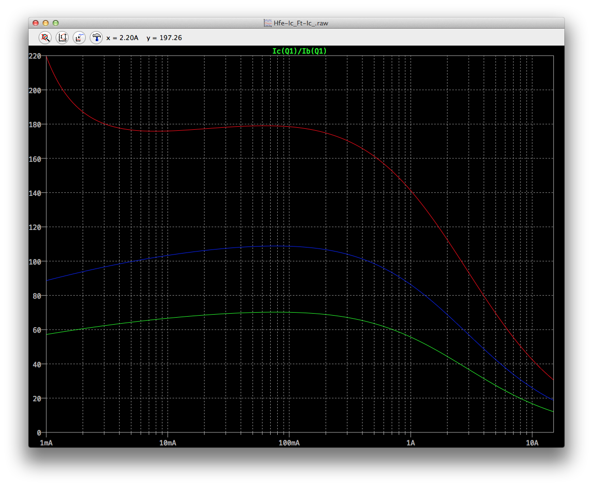

I've been playing with the jig and introduced a few more parameters into the model being built.
When IS was introduced, it had a side effect that affects adversely the highest temperature operation, in this case, the 150C curve, with a spike at the lowest Ic going upwards in gain.
I tweaked ISE, ISC and IS, and re-tweaked IKF and XTB, looking to get the curves closer to the datasheet's, but I'm only roughly in the ballpark.
Especially with that upward going curve for 150C at the low values..
The parms interact and when adjusting for something, we get other effects somewhere else.
Not an easy thing to do.
I even re-adjusted BF a bit, upwards, because of the effects from the others.
Right now that model has this:
.model 2N3055 NPN ( IS=5p ISE=9p ISC=5p BF=120 IKF=2.7 XTB=1.4 VAF=150 CJC=300p CJE=500p )
Of course all the parms with defaults are there, even if not present, so the actual modeling is more than it looks from that short line.
I haven't even looked at other things yet. I'm not quite close enough with this yet.
At least something is coming together, but still lots more to do.
I measured a couple of my 3055s for beta, and they're at about 130 for Ib=1mA, and droop to about 70 for Ib=10mA. They should droop down to something like 15-20 when Ic is at something like 10A or so, but I obviously can't test that.
It's mostly like the datasheet, sort of.
