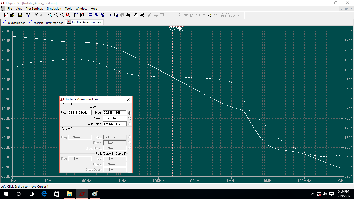

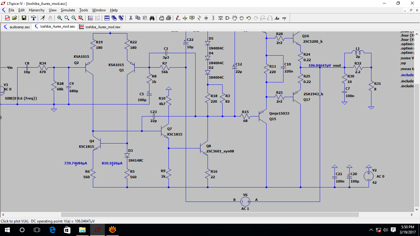

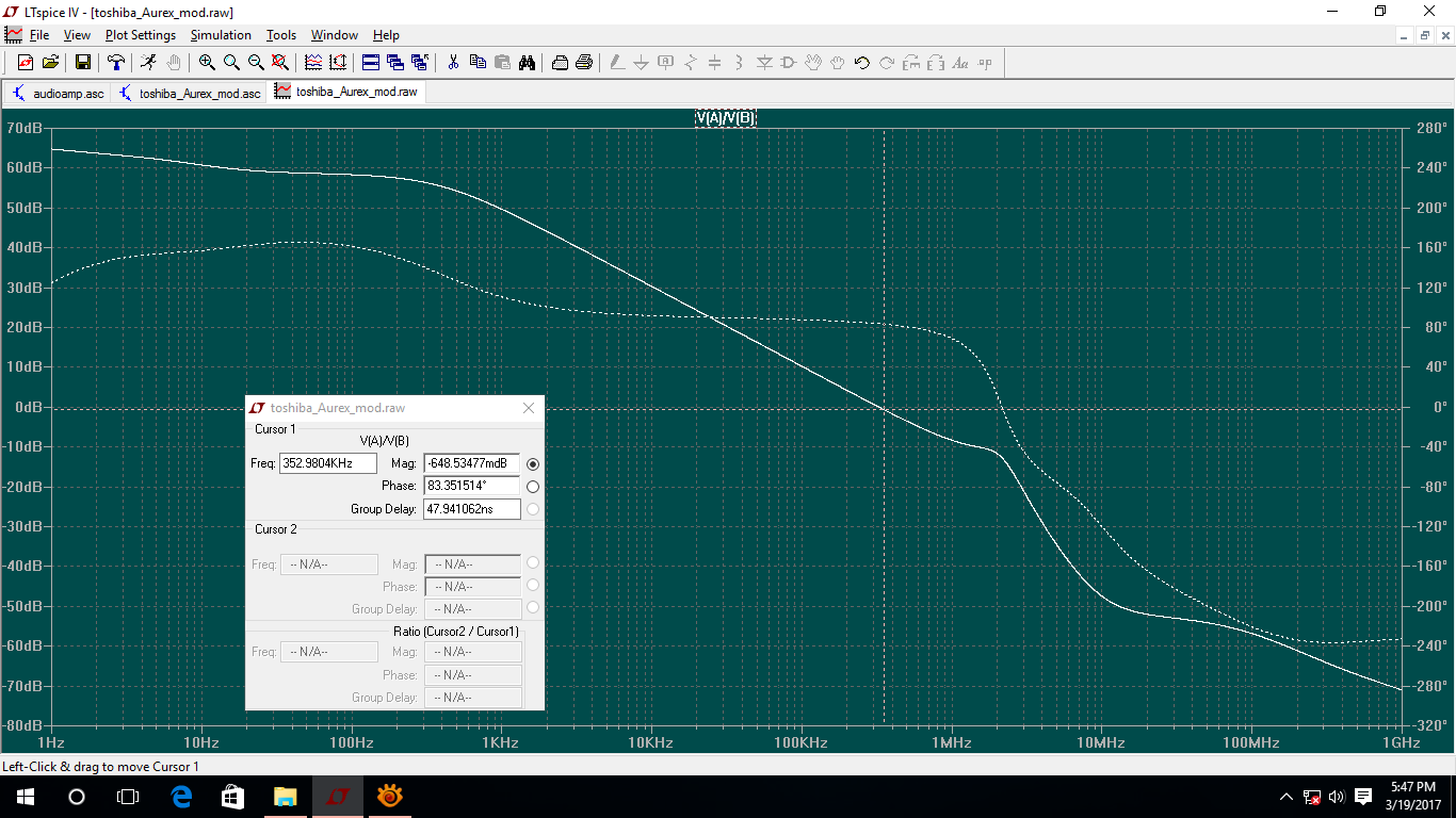

How do I properly determine the phase margin from the images. Grounding the input and applying AC source inside the feedback loop then plotting V(out)/V(A). By calculation that would be 180-X=phase margin where X is the phase deg at 0dB gain. Is this correct? I thought X is the phase where gain and phase crosses path...can't remember where did I get this idea,:boggled: it was posted in the forum.

Middle image, cursor is at 0db gain and that corresponds to 83 deg phase. To calculate that would be 180-83=97 deg and this would become the phase margin [still stable I suppose]. Right image cursor is placed right where gain and phase crosses path and that corresponds to 90 deg phase, and to calculate 180-90=90 deg [still stable]. I remember it now I guess I saw this at one of member gootee's posting, not so sure though if I understood it correctly I do think it was explained that the crucial point is where the gain and phase crosses each others path based on the graph. 180 deg is where the system fails [Bode & Nyquist theorem].
Correct me if Im wrong.

The phase margin (PM) is determined at the frequency where the feedback loop gain has fallen to unity, sometimes called ULGF for Unity Loop Gain Frequency. It has also been referred to as the "gain crossover frequency" because that is where the open-loop gain curve crosses over a level line that represents the closed loop gain.
The gain margin (GM) is just as important, and it is determined at the frequency where the phase lag has increased to the point where the phase around the loop has become 0 degrees (or 360 degrees), i.e., perfect positive feedback. This frequency is typically higher than the frequency at which PM is determined.

Sir Bob,
Thank you for the quick reply, that explains it clearly. Sometimes I get lost testing LTSpice methods. I think there was this one tutorial showing how to determine the same using the .measure directive instead that involves the Tian probe. The result can be seen in numerical format via error log, but I always get "calculation failed". 🙁
