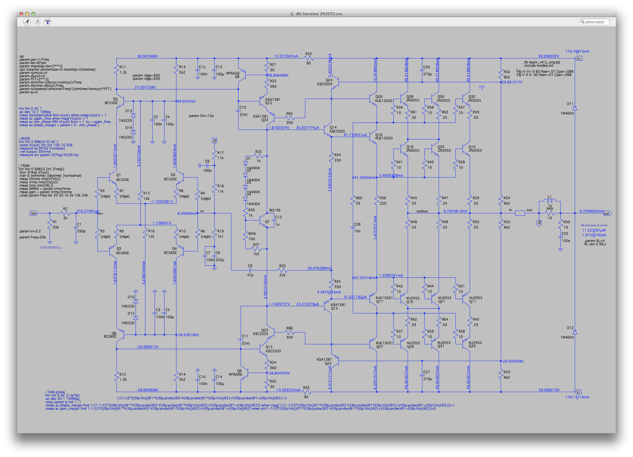

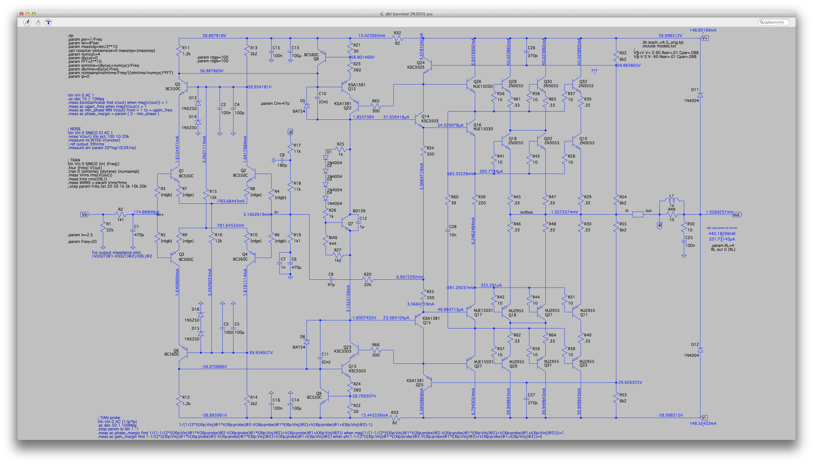

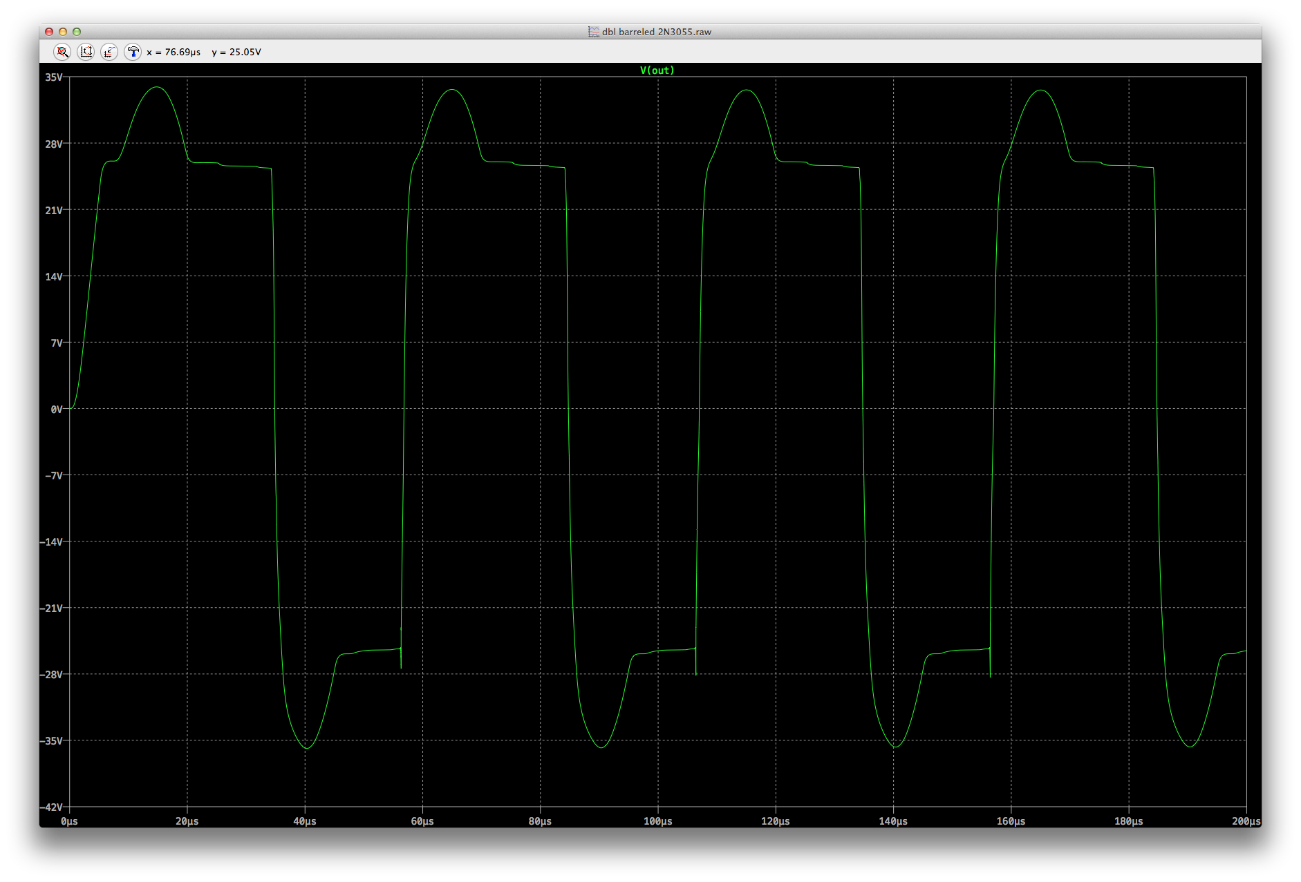

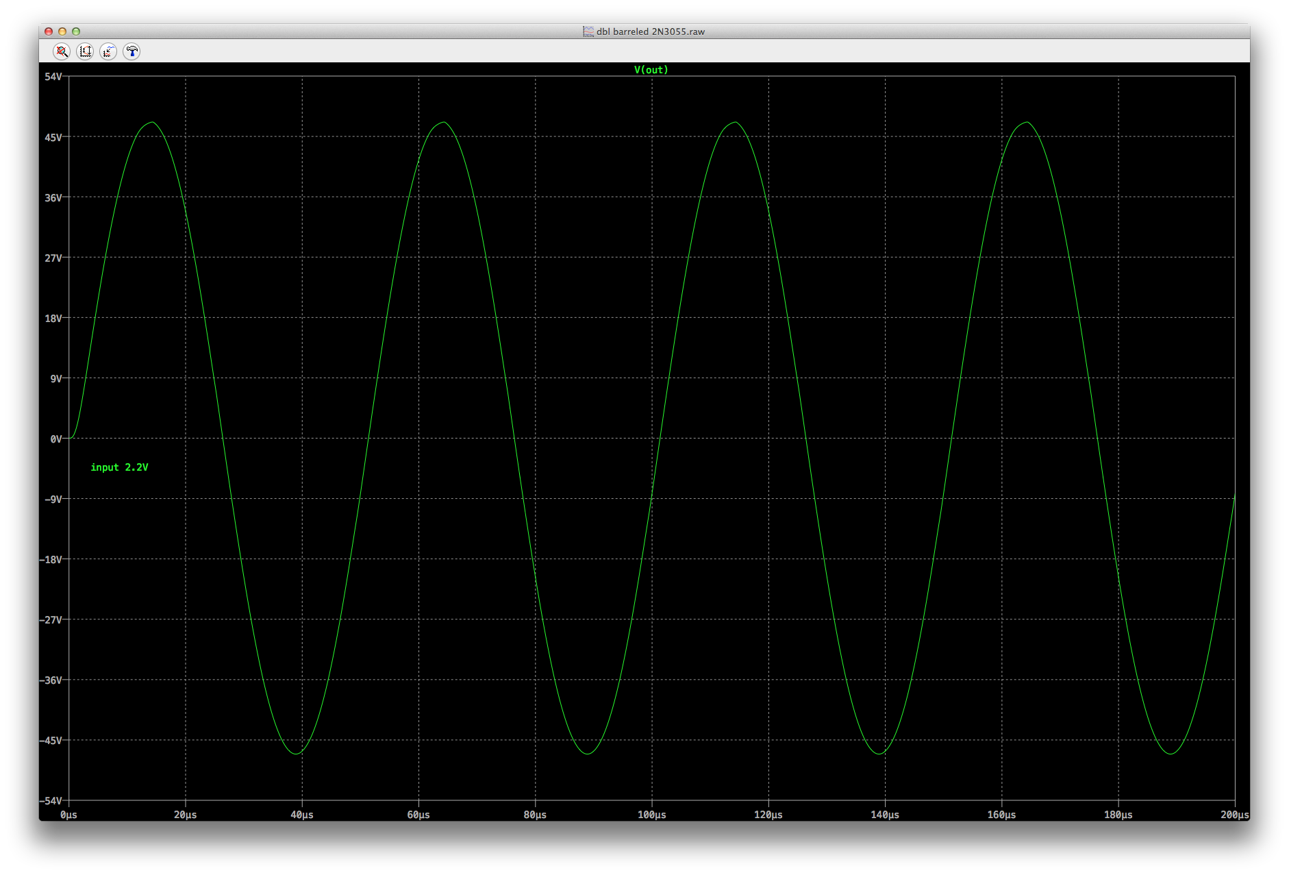

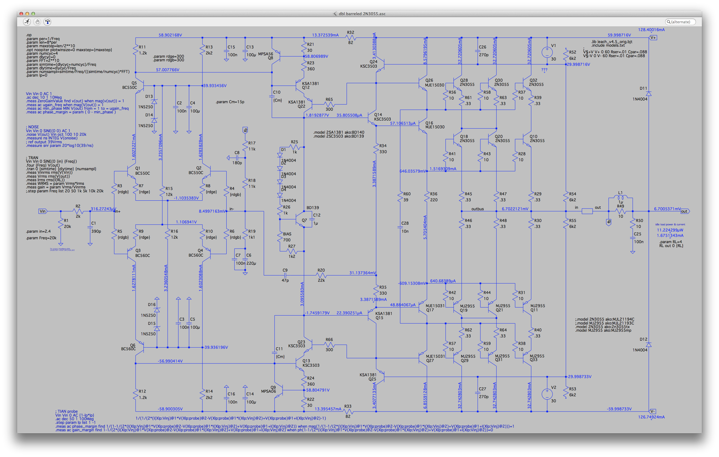

I was just running a sim on the super leach that I've been trying to get going with 3055/2955s, and this time with the MJ15015/16 substituted for the 3055/2955. Using AKO instead of swapping models directly in the schematic, so the schematic still shows the 3055/2955s, but they are running off the MJ models instead.
And the result is similar, very crazy. Posting this now so you can get the idea.
The sine wave is just trashed, and that output signal looks nothing like the input sine.
This gets better when lowering the input level, but it starts going crazy well before getting to maximum. And it happens at lower and lower levels as we go up in frequency.
The signal looks quite normal at 20hz and not too strong.
At some levels, the sine wave starts normal, and before one full cycle is done, there it goes...
I hardly changed the leach design, only tried tweaking a few things, but not so much. I tried keeping it with the values he defined.

That looks like latching. When a VAS transistor saturates, the transimpedance can become negative, and then you have positive feedback, which can then lock up the amplifier if it doesn't resolve when it comes out of clipping. Try to find out which transistors don't return to a normal state when clipping stops. It is probably a VAS transistor model that is causing the problem. It might also have something to do with Q5 saturating in a way that allows another transistor to fully saturate, for instance. Some people who have experience with discrete latches and oscillators and logic circuitry might have the skills to identify the problem quickly.
Notice that Q14 and Q2 form the classic discrete SCR/latch/UJT circuit, which sometimes becomes self-aware in overload conditions and decides it hates your guts.

Also, start off with conservative feedback compensation, like ULGF=500kHz. Moreover, probe all the nodes in SPICE to make sure the voltages are expected.
I always have a bunch of data labels all over the circuits in the interesting spots, and nothing seems out of place. It just behaves badly.
I've been looking for some calculation info in all of Leach's stuff to understand how his compensation scheme works and is calculated, without success. So I don't know what I should touch and how.
I did try tweaking the miller caps though, and that did help a little, but not completely.
I'm wary of touching his 2 feedback paths. He judiciously calculated that and since I don't know how, I don't dare touching it. It would likely have side effects if I did.
That was my first hunch, and that's why I thought about adding a baker clamp on the vas earlier, but it didn't change anything then.
It's quite possibly something like this though, and maybe made worse by the bad models.
Wouldn't those models cause similar issues in other sims as well?
I've been using those in many sims and this is the only one exhibiting this.

We are referring to the issue in the super leach with the 3055s right?
I kept the same part names in the sim as he named them in his docs (leach), so Q5 would be the cascode in the positive side ltp then.

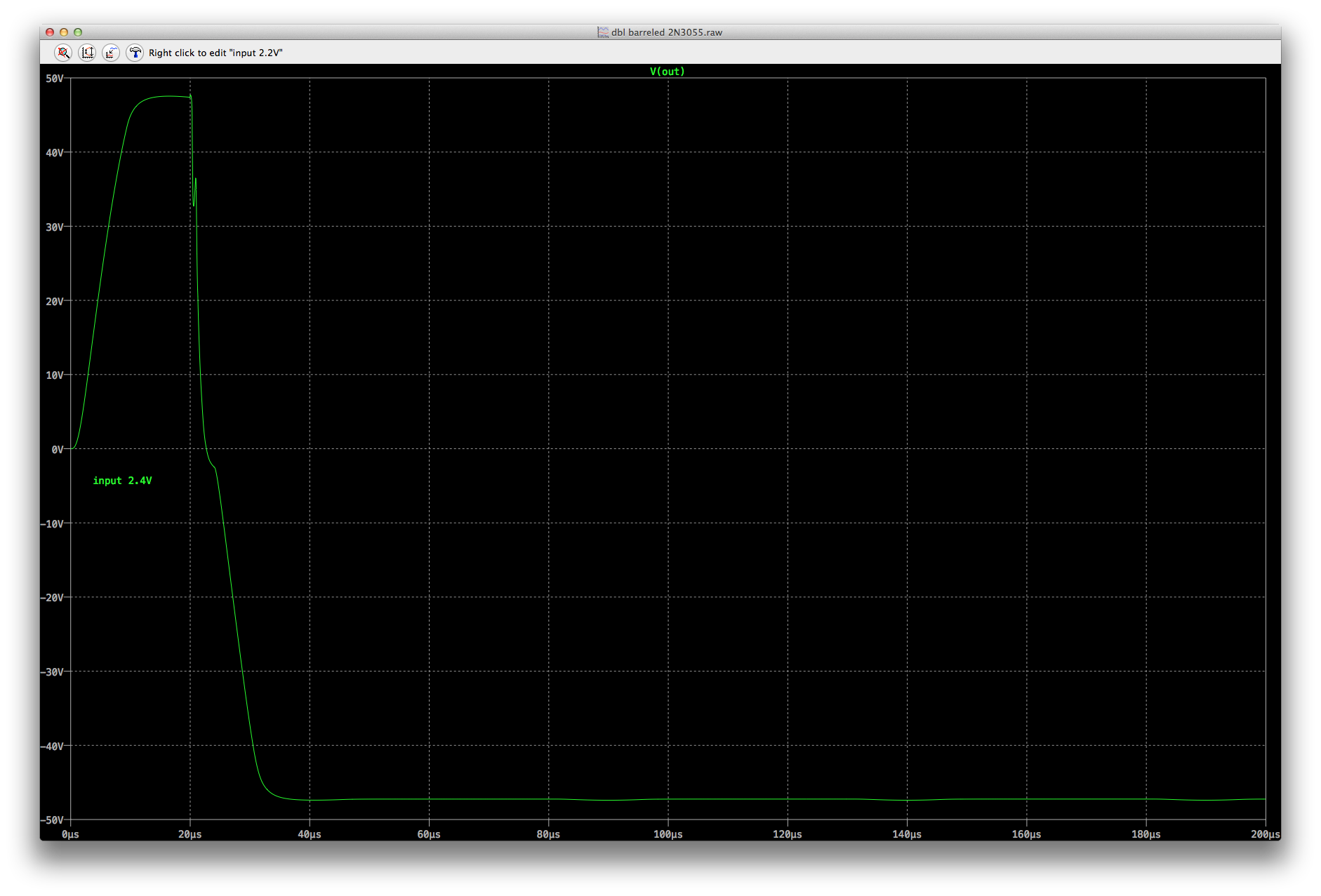

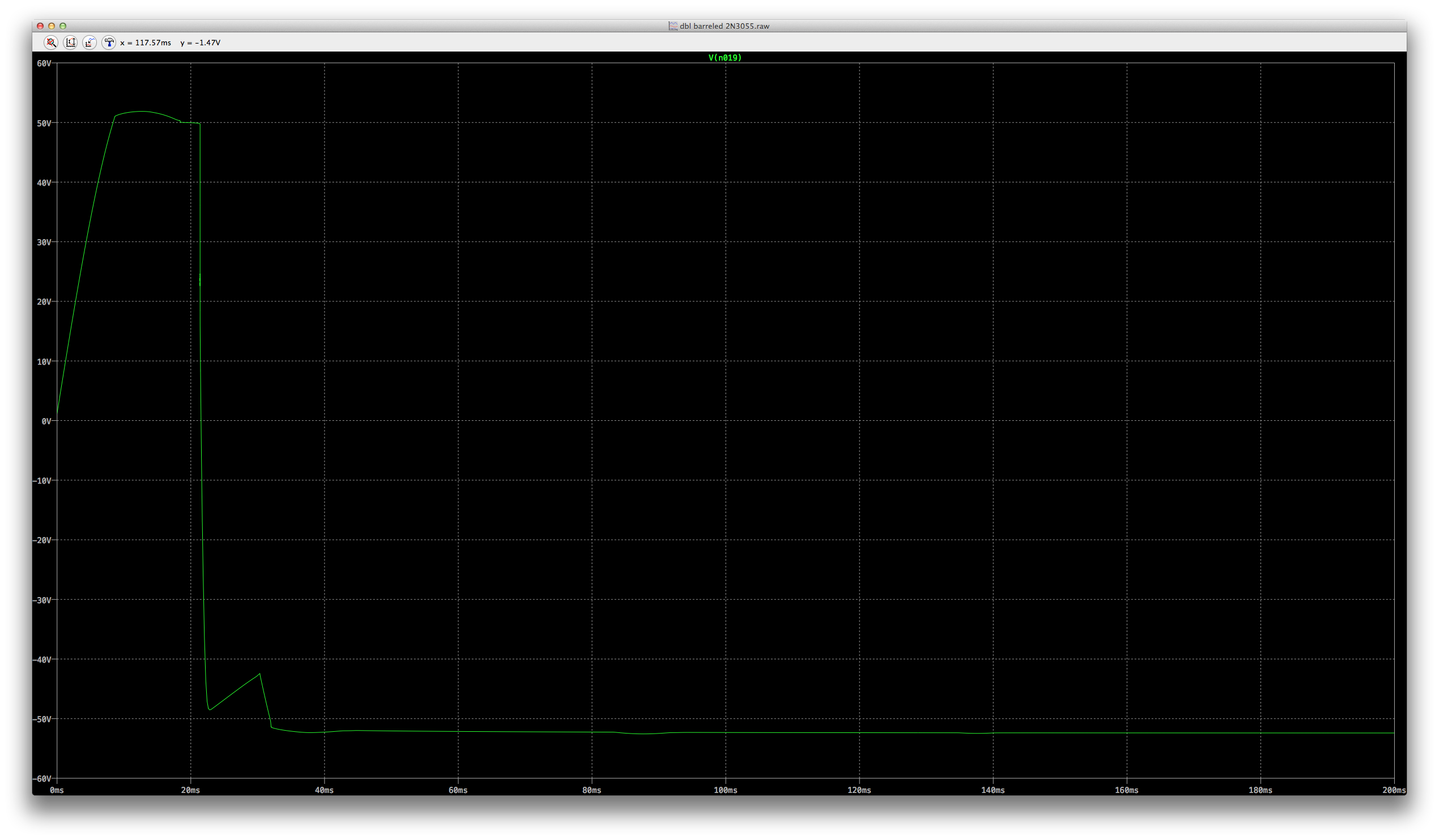

I'm posting 2 tests with 2.2V and 2.4V input levels. The 2.2V works fine (20khz), and 2.4V drives it nuts.
Wow! I wouldn't have seen that. How does this work?
By the way, just to make sure, although the sim schematic I posted shows 2N3055 and MJ2955, the models used in those sims are actually the MJ15015/16. Behavior is even more erratic with the actual 3055/2955 models.
One other thing. The rails may be at 60V, but the peak of the output signal isn't even close to 50V, so I doubt this would be triggered by clipping on the outputs.

From what I see the feedback does nothing more than switch the feedback point to the predrivers at the cutoff frequency shared by C8 and C9. This is actually a heavy compromise, probably because the 2N3055 of the day was too slow to be compatible with a fast feedback loop. The 2N3055 we have today may be totally different depending on who you get it from.
At RF, feedback has to be taken before the outputs because they have too much phase shift which will cause positive feedback. However when the feedback point is no longer the output, the distortions in the stages past the feedback point no longer get corrected. So this results in more distortion.
Visualize the feedback network as a crossover network, starting at the negative LTP input and R17 and R20 going to drivers. The basic concept is the same, although it works a bit differently.
A more modern way of getting around this problem would be transitional miller compensation (TMC), which could be used at the negative LTP input and/or at the VAS.

No, latching is caused by a reversal of gain / positive feedback, something that won't happen if the model parameters are anywhere near correct. With multiple transistors interacting the small quirks can be amplified, but generally even if the models are exaggerating it, if there is a tendency to latch in simulation there will probably be the same tendency, even if suppressed, in the real prototype.
When clipping first occurs, the VAS usually saturates first. If the input is driven any further, the transistors driving the VAS also begin to saturate. So you can have conditions where slight clipping is no problem but when you push it a certain amount past clipping all hell breaks loose.
There are some articles on the web about how UJTs work, although they don't usually go into details on the exact conditions required for the discrete UJT to latch and how you would set that point intentionally. But generally latching happens when the base feeds of the discrete UJT are both current limited such that the transistors begin to drive each other rather than perform the separate tasks they were intended to. This is probably far too general so I suggest you try to find a webpage about it. People who design speaker protection relay circuitry can probably explain it to you.
Without having the simulation, my hunch would be that at full output Q14 is pulling a lot of current through Q24 who's Ib is causing the output cascode voltage to sag against those 6.2k resistors. This lowers the base voltage of the VAS cascode so that the clipping point is lower than it should be.
That's probably the first thing to try out instead of the leach designed comp scheme. And maybe, compare with cherry...
Sometimes discrete quirks don't follow the generally known patterns, and creative solutions must be devised. It is educating to inspect each transistor for saturation at points along the waveform until you figure out exactly what is happening and why.
I'd love to get to do that, but I'm not quite to that level yet, but I'm learning.
Same part names, but your parts could still be very different than the parts he had.
I made the effort, against ltspice's will, to keep the part names the same, for easier sharing and discussions. So unless I missed something, we can refer to the same part names from either the sim or schematic.
I will clean it up and gather the models used, so I can post it.
In the mean time, I just swapped all of the vas and pre-drivers, the 2SA/2SC, with the BD139/40, and that changed nothing at all.
And then following on that assumption of the sagging cascode ref voltage, I figured I'd try a little brute force, so I disconnected a 6k2 on each side and put a 30V source there, which definitely nails that ref point down, with no more possible sagging.
And look at what happened!
There are so many more parameters in a model than in a datasheet. And sometimes the datasheets leave some things out or specify them at different operating points.
And that makes tweaking the models difficult to do. We have insufficient data. Plus without a full guide of what each model parameter means and how they can be determined from the available data in the datasheets, we're in the dark and guessing a lot.
Furthermore, some parts are older than my grandmother and the specification or at least the process used has been changed since then.
Well, she must not be quite that old then :D:D
I do have a nice bunch of old stock, and I better make sure not to mix those with newer ones when selecting parts.
Old versions of the 2N3055 were really terrible as I understand.
They were surely not what they are now. And I think the Ft back then was something like 800khz, at best.
At least I know that my old stock doesn't have any counterfeits, as that wasn't done back then.
A mid-way model could very well do poorly at modeling both the originals and the modern 'equivalent'.
Well, we don't need to have one model for all that, but maybe one mid-way for today's devices, at least from the most popular sources. We have ST, OnSemi, Central and perhaps a few more still producing them, but I suspect the most common would be from those 3.
My brain is starting to turn to mush, it's late for me in this time zone, so I'll have to call it quit for now and pick this up tomorrow, or it'll liquify and start oozing from my ears.
I'll clean the leach amp sim and gather the models used, for posting..
Some guys have a way of making things sound far more complex than they really are, especially if they never talk about it to anyone except those steeped in the jargon of their chosen field. I think most of the math would have had to do with calculating the behavior of the amplifier stages, but choosing the feedback network would have been pretty basic after deciding on the crossover frequency.
Notice that R20 = R17 + R18.
If you shorted C9 and removed C8, you would have feedback equally distributed among both feedback sources. This is probably intentional, otherwise you might get step response quirks when gain was higher or lower on either side of the crossover frequency.
Also notice that the corner frequency of C9 is the same as that of C8. C8 is ideally 4x C9, since that would make the corners match, but the designer stuck with common values.
At RF, where the danger of instability is present, no feedback comes from the output because it is shunted by C8. At RF we can also consider C9 a near-short. So what we have left for the feedback network at RF is plain miller compensation, along with a 22k feedback resistor to the predrivers. That's actually pretty boring. The only thing that happens in this feedback network is that at RF the feedback point is moved to a different node. There is no compensation for the individual stage phase shifts, they are just left where they are and the feedback point shifted almost as if to avoid dealing with them at all.
We all have different levels of understanding. Some need more help than others to understand things better. That's what the sharing is all about. All good.
Now that you mention it, of course.
The feedback loops are nested this way. We don't see this often, not beyond the common miller loop, always nested within the global outer loop.
What I find odd is that such an old and proven design, that's definitely known working for real, and built by many, isn't working properly in simulation. How come? It can't all be because the models are crappy. Something else is going on.
Anyway, I think I got the sim cleaned up and gathered in its own folder with hopefully all its parts included to run out of that box.
Attaching the zip now.
