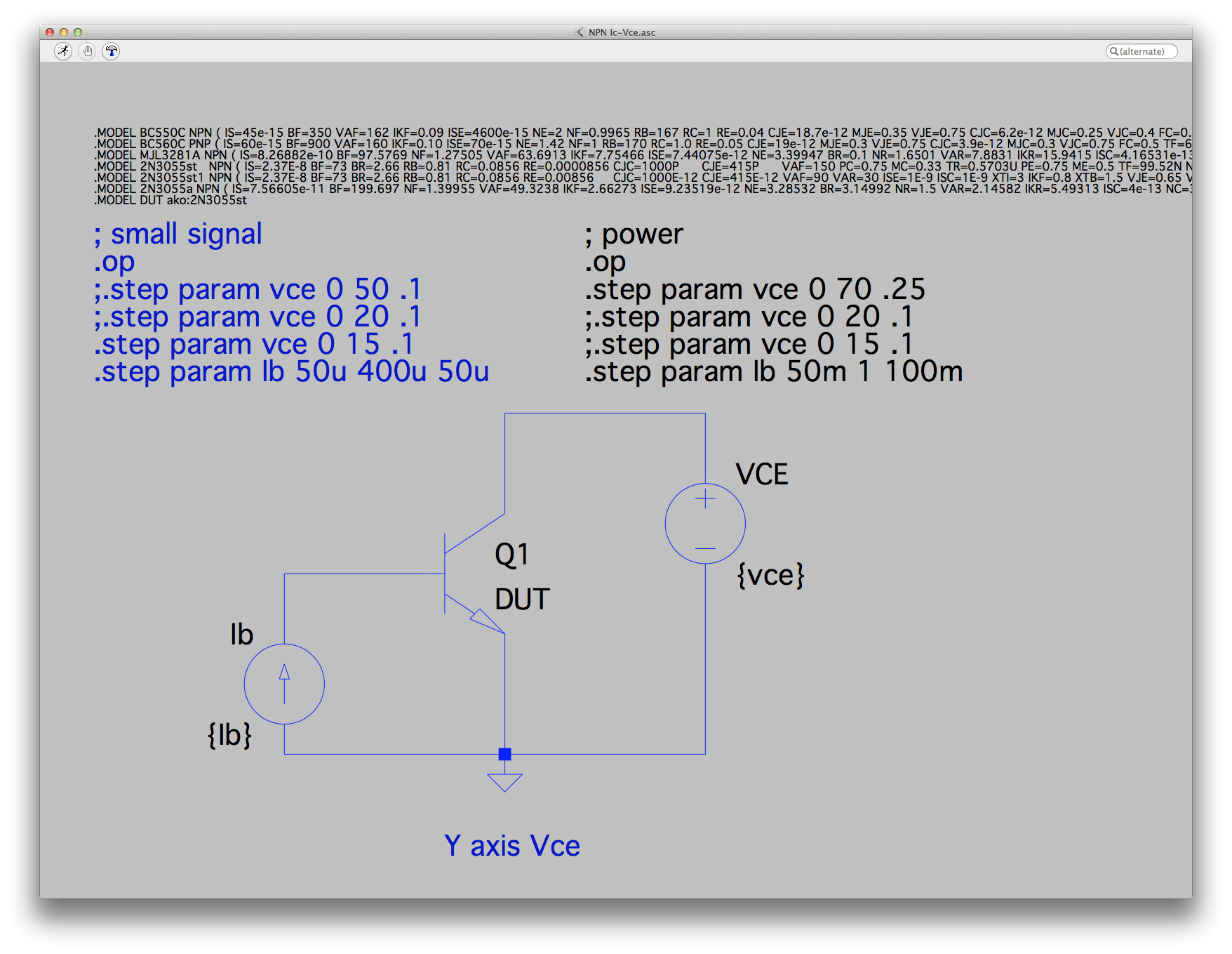

I attached a shot of the little test jig that I used to check this Ic/Vce (not Vbe), and I stopped the sim early to see enough of one curve being traced, with the knee visible (circled red). I also put a blue line parallel to the curve, which is the slope of the early voltage. That arrow pointing in the direction where eventually that slope will intersect with the x-axis, and at that point is the value of VAF.
Obviously this should be a negative value, but I guess for VAF in spice we use only absolute values. The VAR would be the opposite and a positive value.
That jig allows quick and easy switching to various models using :ako, and the device under test here is that overly simplified ST model of the 3055.

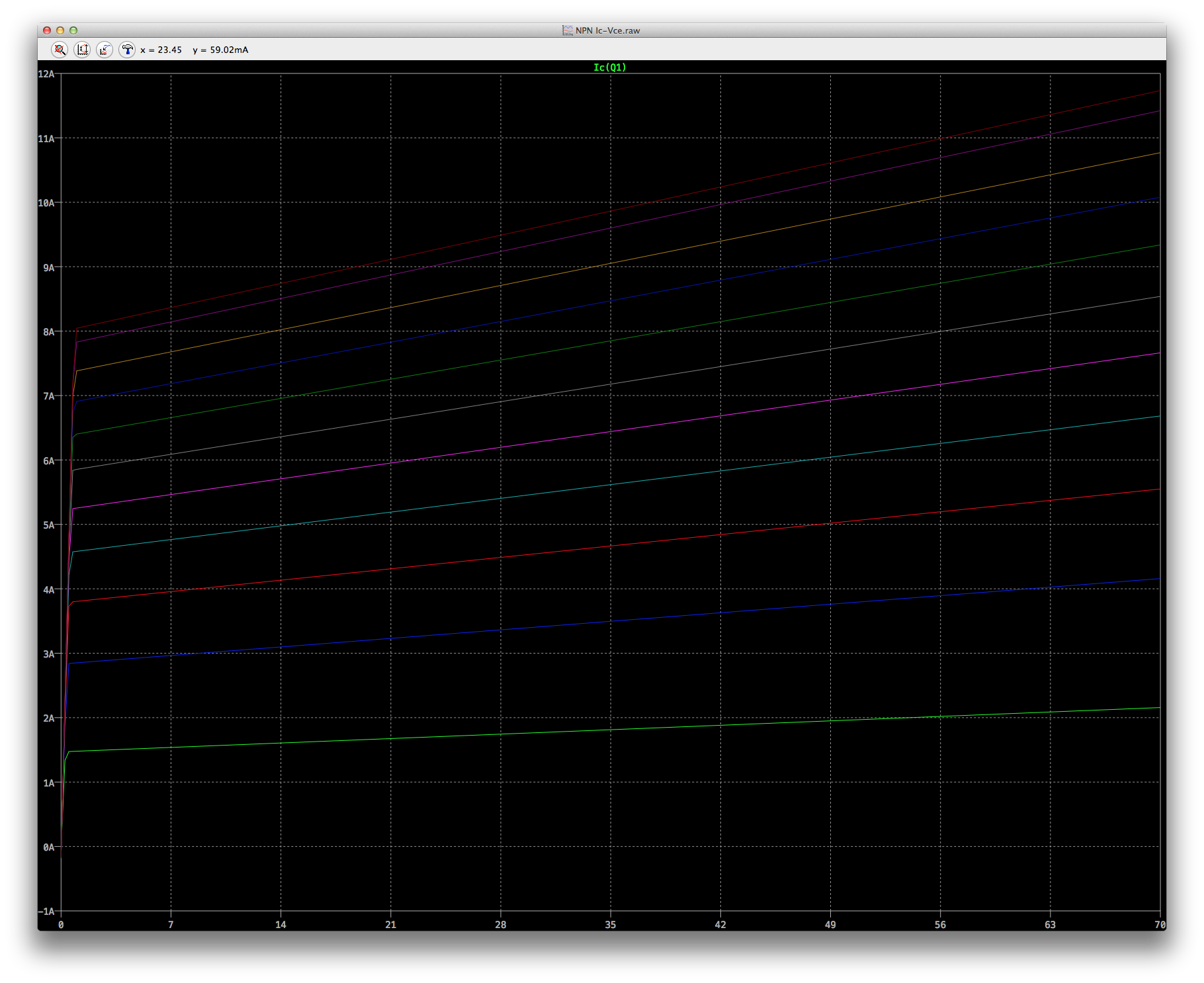

It didn't have a VAF parameter, so there was no slope at all for the early voltage. It was totally horizontal. This would mean the default for VAF to be infinite and not a fixed arbitrary value.
With that VAF at 150, if I let the whole sim run, we get that other plot with all the curves slanted.
Higher Early voltage makes the Ic/Vce slope flatter, more like a CCS and less like a resistor. Generally higher is better, since Early effect reduces the voltage gain at the collector. More Vaf means less Early effect.
Flatter, to the point of totally flat, when VAF isn't there, thus infinite.
At least that's the result I got from that simulation.
